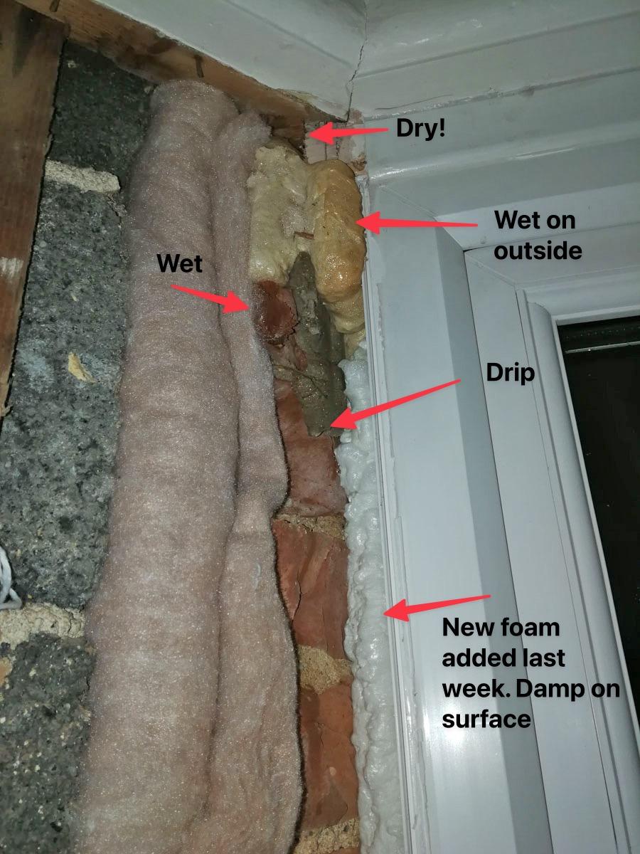

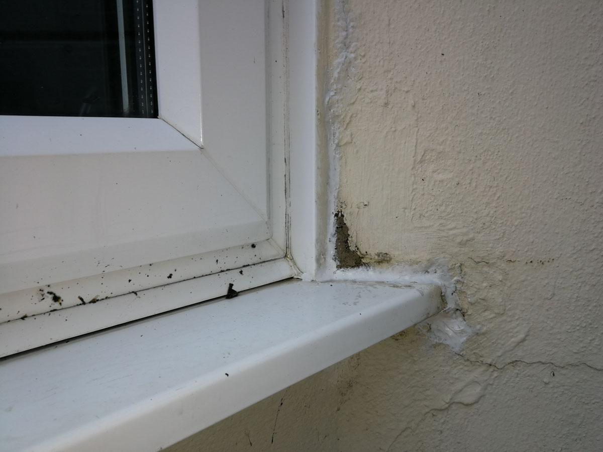

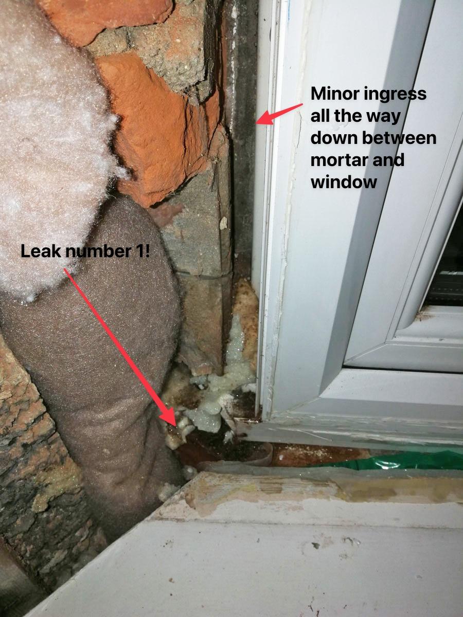

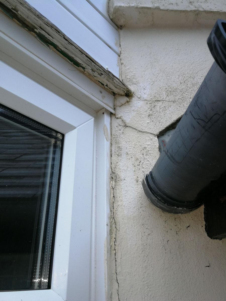

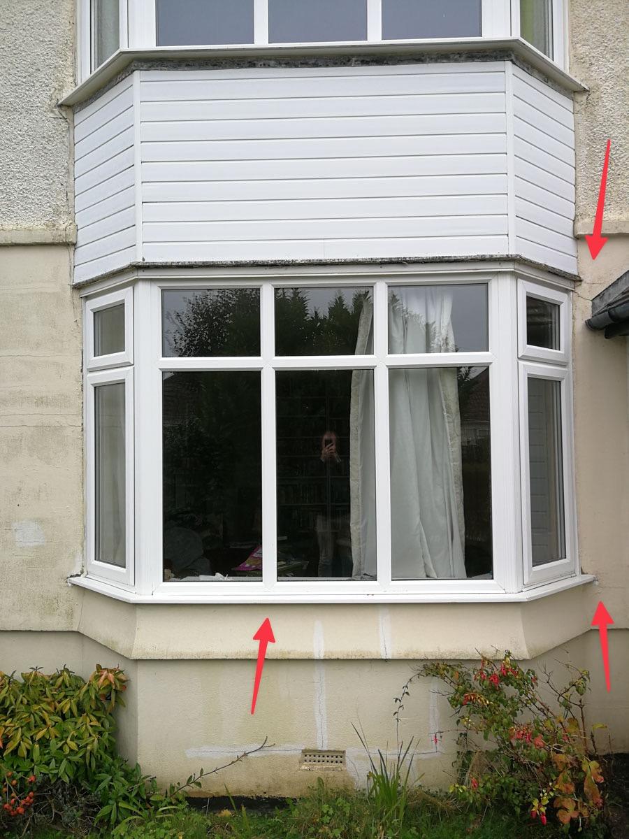

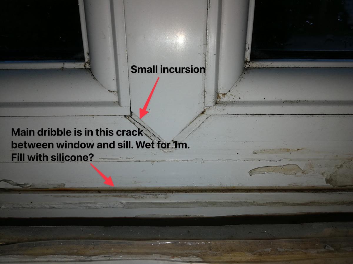

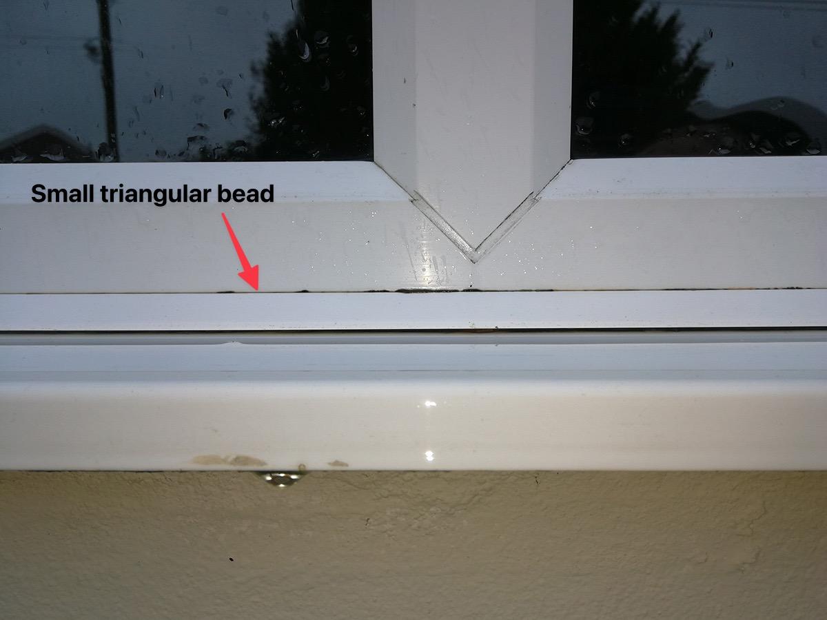

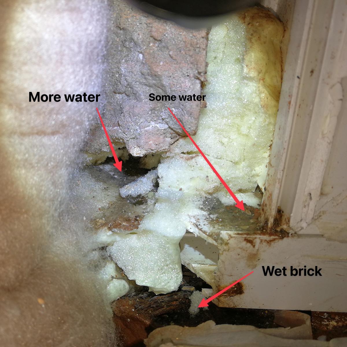

After stripping the (dry, wooden) surround off I've found two leaks on the right side of the downstairs bay window, and I suspect it's the same the other side. Where the window sill has been cut into the brickwork it has been leaking for a while - the render is soft, the wooden packer has rotted and the brick under the window is soaked. The open cell foam filling this area is sodden. Before storm Ciarán hit I filled the cracks and places where the mortar fell out with CT1 as it was soaking wet, which didn't stop the water coming in. During last night's storm I found a leak at the top right. And now a third leak between the bottom of the window and the sill. 2 questions: How can I patch this up for now, and what is the long term fix? We're planning to have this wall re-rendered due to cracked and crumbling (sodden) render, but this looks like a weak spot. With the gap between window and wall, and the way the window sill disappears into the wall and the open angle where the render touches the UPVC is going to be tricky to make waterproof? Overview Bottom right With my new CT1 trying to fill gaps. Foam is supporting external render. Some of the render fell off and I could feel sodden foam. Top right Again the old foam added to try and stop/hide the leak? Foam is probably supporting the render. And the bottom:
