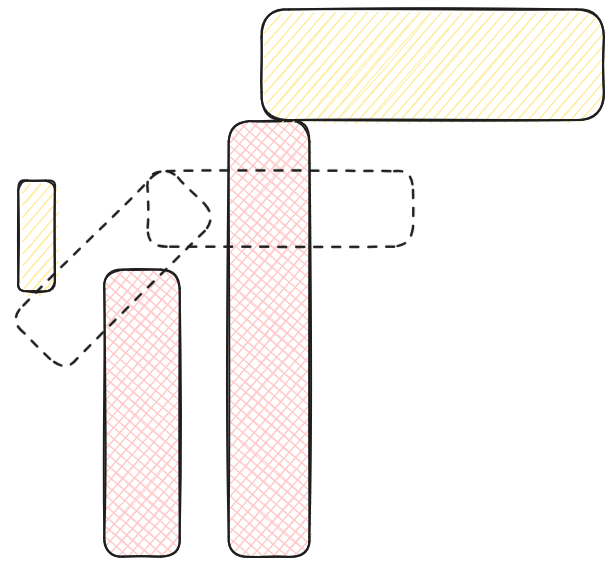

Yes that seems about right. If I could do more great, but there's 12.5mm plasterboard below the joist so doing the same 45 degree cut in that gains me another 12.5mm. There is a doorway in the wall above, so is only footfall that comes in over this part. This is looking promising.
30-34cm from this joist to the next (working on screw holes), and then 40cm spacing for the rest. That is where I'll be - a 3m span, and I'm 1-1.5m out from one wall.
I have a joist parallel and 6cm away from the wall I need to get my MVHR ducting through. The joist is approx 7 x 2 inches. Is it permissable to notch the bottom of a joist? In this case taking off a 45 degree bit where each duct goes, say across half the width of the joist. The guides online are all about notching the top. The ceilings this side are lower than the other side of the wall, so I need to go through at an angle and this would give more space to bend the ducting through 45 degress than cutting entirely through brick.
