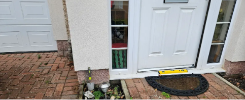

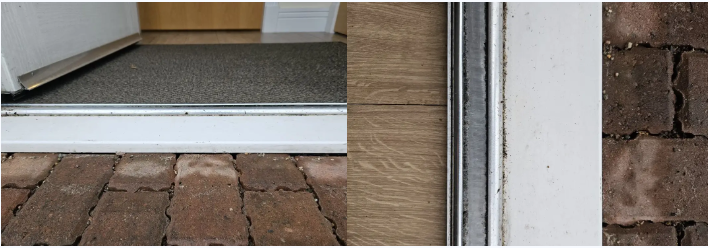

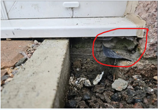

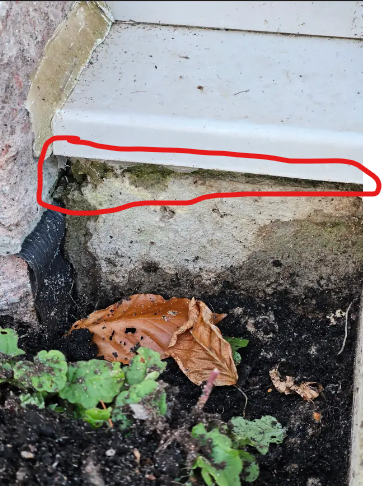

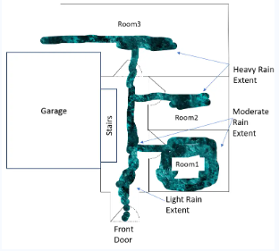

  4. The Problem I've got an issue whereby water is getting into my house whenever there is moderate-heavy rain. This is a new build from 2015. Current theory is that water is getting trapped between either the DPC and flooring or DPC and concrete underneath. I suspect it is coming in via the front door area, but there is no visual evidence of water ingress anywhere. However, walking around there is a very audible sloshing under the floors. But the flooring itself (including carpets) is bone dry. The builder is not very helpful as warranty period is passed so I'm on my own. No signs of damage anywhere that would clearly point to ingress and only occurs during periods of rain (so think that rules out pipe issues). The Pictures The construction of the flooring is (bottom up): Concrete Plastic Membrane Plywood Laminate (glued down) I've tried to make a schematic below of where the water can be heard in the house. I believe it enters at the front and then is channeling/pooling at low points. The heavier the rain, the further into the house the sloshing can be heard and then drains away after a few dry days. The garage which is at a lower level is bone dry. I've investigated for cracks, poor/broken sealant, any way the water can get in but can't find any. I removed the lock-blocks at the threshold and concrete is still intact with no obvious damage or cracks. Front path is level. If I move aside some of the gravel at the side, there is the DPC visible. Not sure if this is a possible entry point for water? The garage (white door on left) which is at a lower level than the front door is completely dry, even during heavy rain. There is no pooling of surface water anywhere. Everything is very level (build to wheelchair standards).
