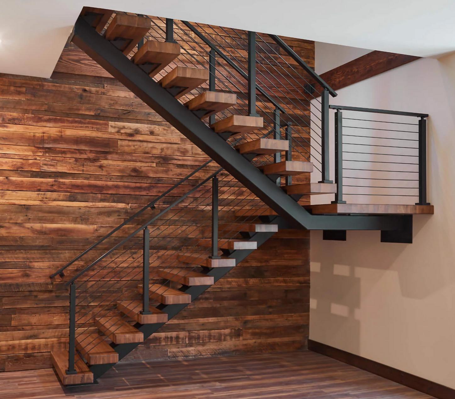

A question for anyone but hopefully @Gus Potter will chip in as I'm in Scotland. Does all this malarkey also apply to non glass balustrades and fabricated steel stairs. I'm building a large extension in Dumfries and Galloway and was going to self fabricate a heavy box section steel stairs with wooden treads. or if I had any doubts about my welding I would get a local steel fabricator to build them. I wasnt going to get to involved with structural calcs, just over engineer. Something along these lines (pic pinched from internet) Thanks -
