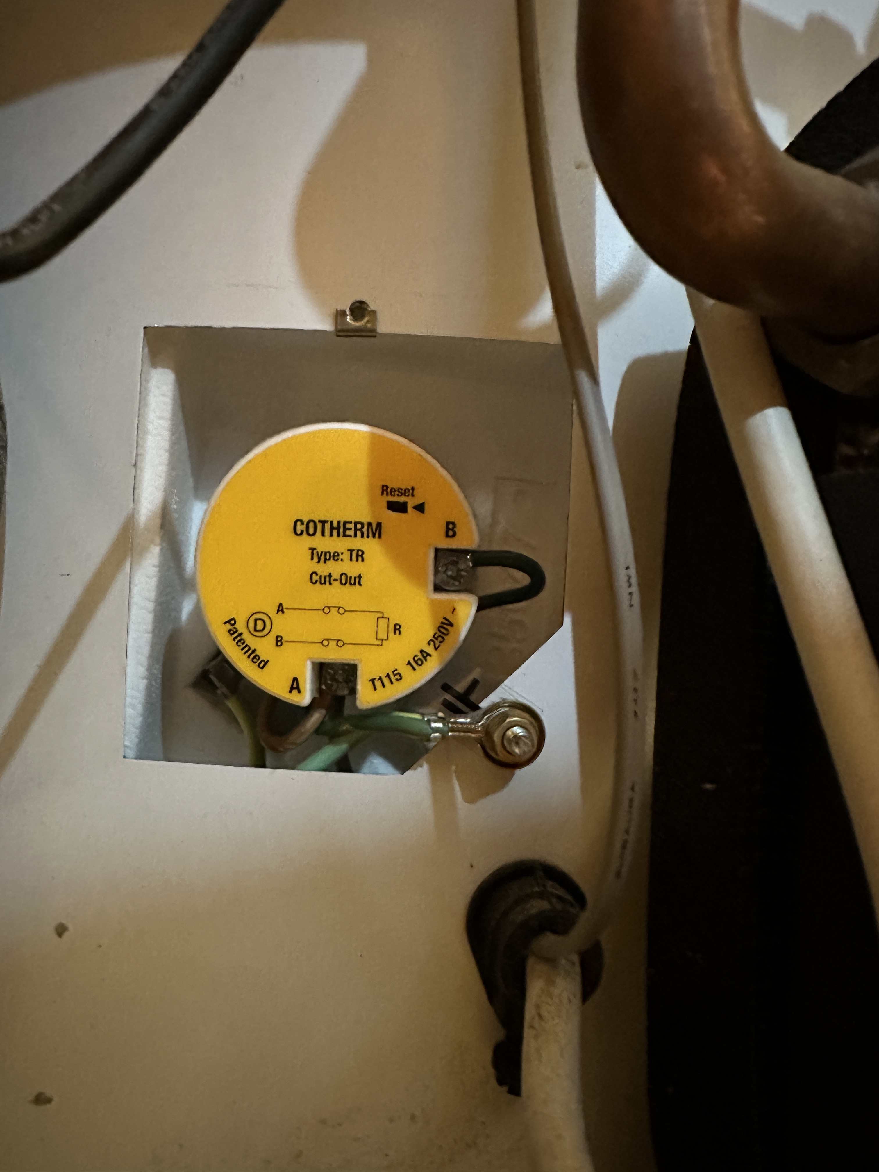

I have just replaced the immersion cut out on my 8.5 ecodan 250L cylinder. It is just a safety cut out, set to about 80C I think. (see pic) There is no way to set the desired temp on the cutout. The water temp is set in the ecodan controller and it gets the signal from a thermocouple in the cylinder, which switches a contactor feding the immersion. You cant connect the feed from the diverter directly to the immersion, it has to go through the contactor which means you need to change the settings to tell the unit to use immersion for hot water, not the ashp and set it to be on during solar hours. This then stops the ashp ufh circuit from working as it thinks it needs to heat the hot water. I replaced it with one which has the conventional temp settings and also a safety oveheat cutout enabling a direct connection to immersion from the diverter. https://www.ebay.co.uk/itm/223408932236 It's a simple dry plug and play push in replacement. -
