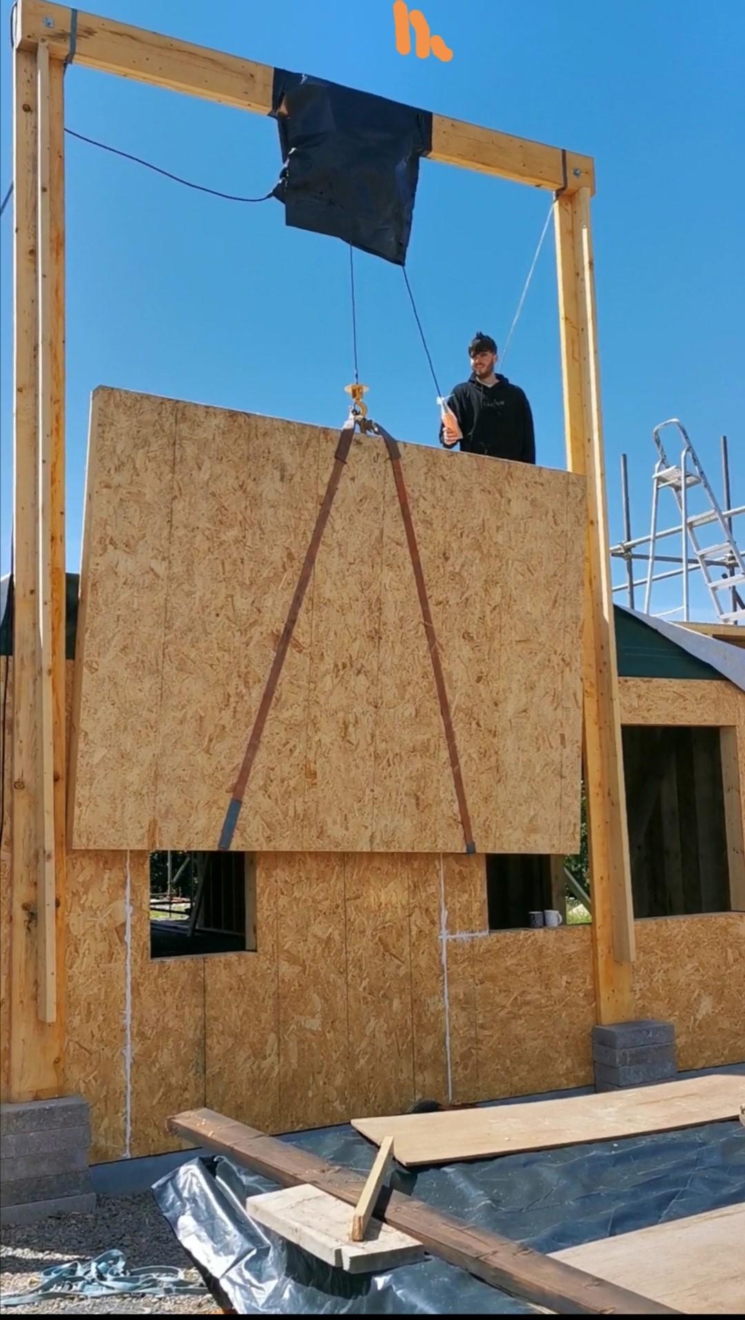

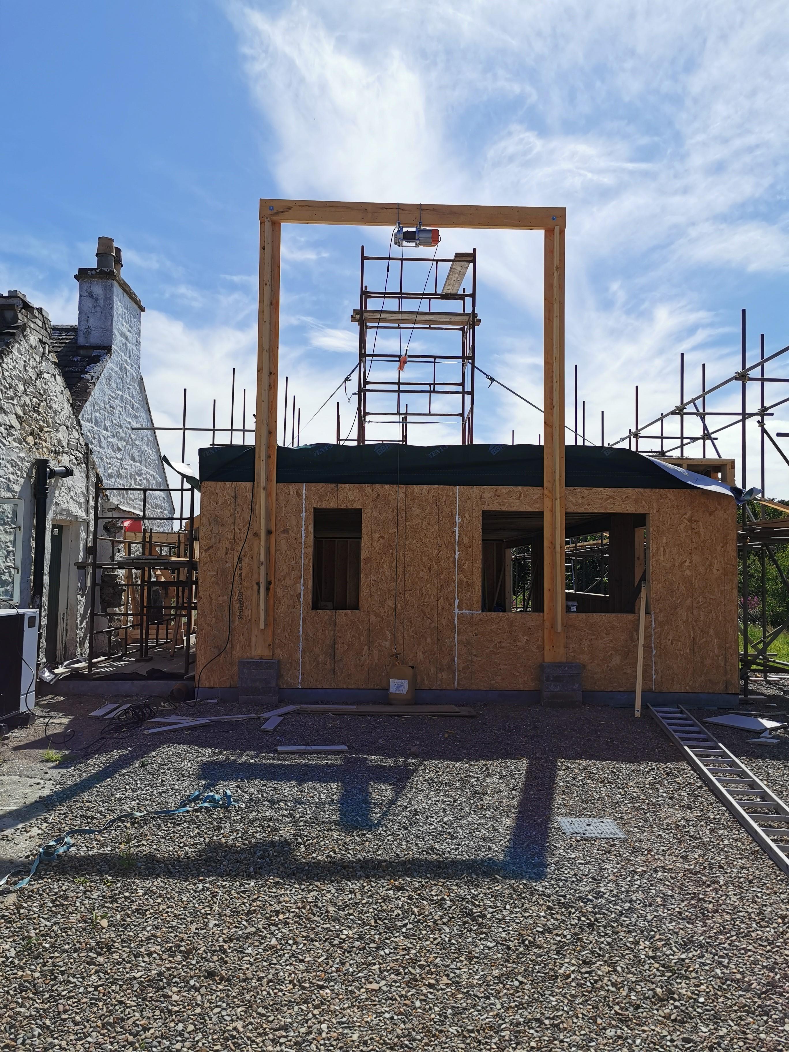

You're underground what did you expect ?
trialuser replied to Pocster's topic in General Self Build & DIY Discussion
This is what I have just used to lift my first floor panels, some of which are over 200Kg. I decided to buy a slightly better qualikty Rhino hoist rather than an ebay one as my son was helping me and I'm keen not to kill him. The hardest part was lifting and fitting the hoist, although when we took it down we realised it could lower itself, it would have also pulled itself up! -
