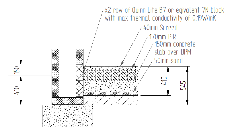

I have on my drawings the following make up of the ground floor: screed insulation 170mm Concrete 150mm sand blinding 50mm DPM Type 1/hardcore compacted min 150mm, max 600mm I understand that there should be 600mm max infill. So does that include the 50mm of sand blinding? ie should Type 1/hardcore be max 550mm? Reason for asking is because top of founds to underside of slab goes as high as 950mm, so trying to work out how much lean mix concrete would be needed to back fill trenches.This being one of the structural engineers suggestions, and I suspect the cheapest. Cheers,

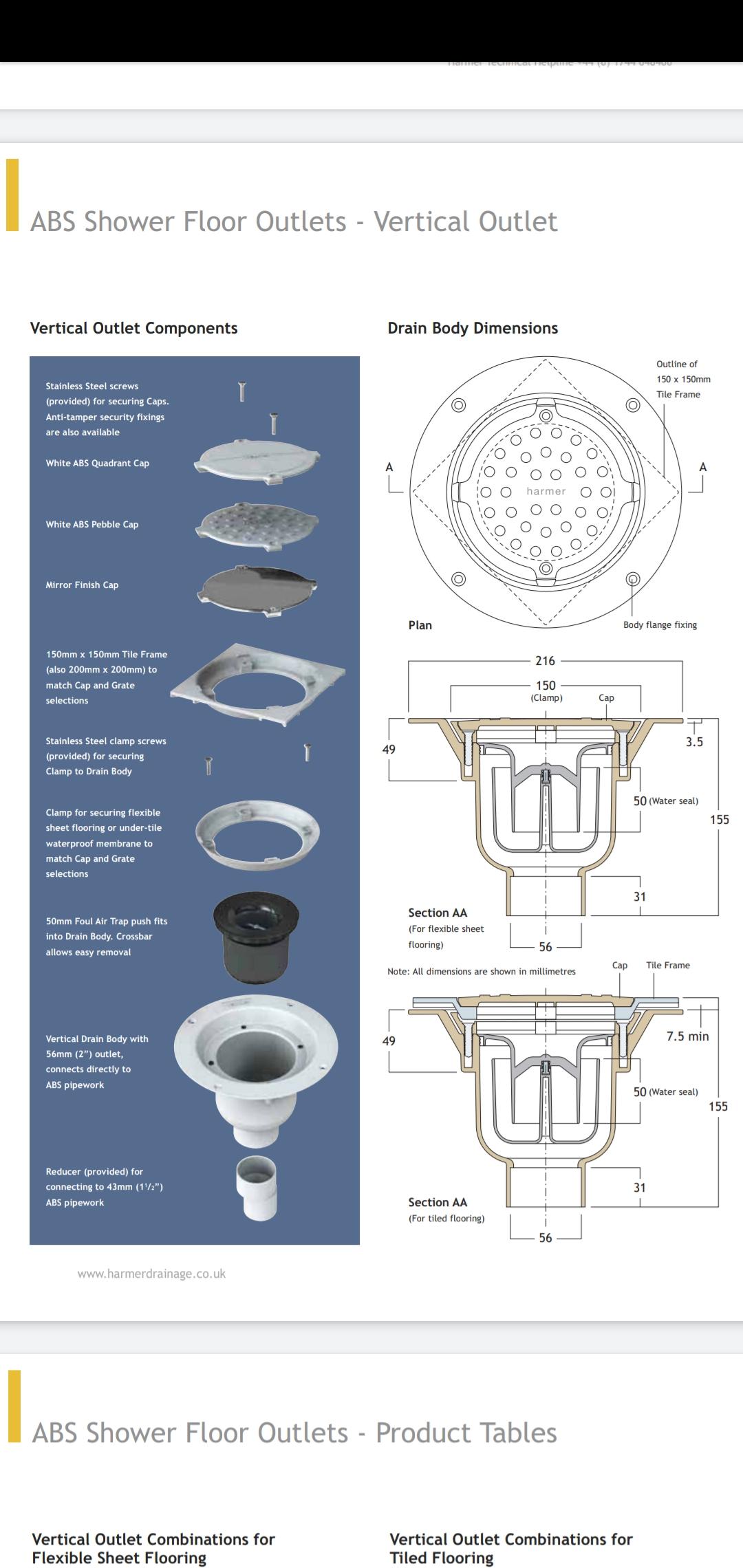

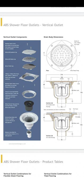

Thanks Russell, I'll try and find the posts. Decided to go for the McAlpine one after all, as it's 75mm seal and that's what the regs say to use. -

Some interesting options there. I've also found this from Harmer. Is for membrane though I might well go that route. Only concern is it's a 50mm water seal, our building regs say min 75mm... -
I wonder if this is an unusual arrangement, given the apparent low availability of suitable gullies. Or am I missing an obvious solution...? So, what I want to do is use a former (1200 x 900, center drain), with a gully that has a vertical outlet that goes straight into ta 110mm waste pipe that comes up through the slab floor. And I want a gully that the inners of which can be lifted out should access ever be needed to the waste pipe. I've found a McAlpine gully that meets this spec but it is for membrane tanking. Could maybe make my own former from 4 bits of tile backer board and seal with tape and to the gully?

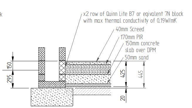

Thanks PeteraW, that is an option. I was equally concerned about comprising the Quinn Lite blocks, tho prbly ok for a few m at the higher end of the site to have one 215 and one 100mm course, which would be needed with either floor make up.
Hi Folks Our strip foundations were poured this week. All very exciting but due to various reasons the top of the concrete is higher than ideal for our target ground floor level. This just affects one end of the house as there is a 1m drop across the site and the concrete is stepped. I had envisaged at least 800mm from top of concrete to GF to allow for drains to pass through the footings. In the localised ares of concern don't need to worry about drains so may get away with the below detail? Or can I lower the GF even more by having a course of the Quinn Lite blocks cut and the sand sitting on top of the concrete? Thanks
