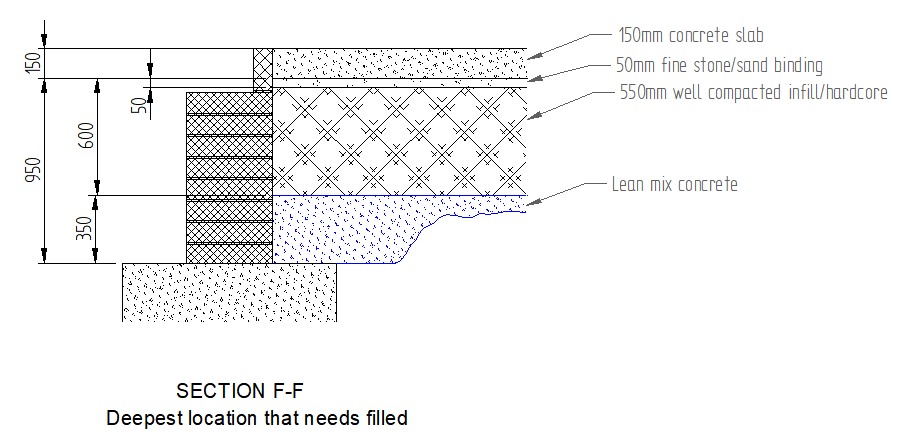

Thank you for the suggestions, have sent some ideas to SE and was hoping to get a response by now but he's been busy on other site visits so will now be after the weekend. I originally favoured slab on top of insulation, tho can't for the life or me remember why I moved away from it. Someone somehow convinced me to do so. Stone blinding already laid at the other end of the build, so need to consider a way forwards that either integrates with original plan or does not require excessive re-work.

Yeah a slight slope, about 1m from one end to the other. I wanted to dig in a bit more at the top end but the founds got poured...
In fairness the builders already have fine stone on site rather than sand. Yes floating slab for new build. So far the footings have been built to top level of slab, as per sketch below. I like the idea of more insulation as its adding something that will have more useful purpose. Only thing is to do that would mean slab top level to lower then where the footings now are so maybe not the easiest to level the slab? Proposal with lean mix concrete something like this. Think I'll need about 11m3:
