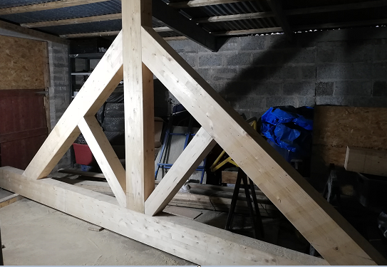

  2. Hi folks. The big glulam truss is taking shape nicely in the shed, and will be moved out to its final location in 2 weeks time and lifted into place. Question is, how best to bed/fix it in? It will be resting on 215mm thick block pier, so thinking about this interface. The structural engineer didn't specify anything, but did give 20kN max vertical load on the kingpost, so there will be 10kN at each end. Builder wondered about some form of steel plate and set on a pad stone. I'm thinking the same, but to what detail? Thanks

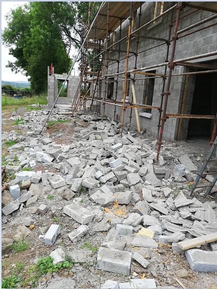

  5. Hi folks, Builders are leaving quite a mess of broken blocks out the back of the house. As it happens we need to build most of this area up anyway for a patio anyway. Question is, is it wise to just leave the blocks there and throw some stone over them and compact down? I'll not be laying the patio itself for a year so there's a bit if time for it to settle. (Photo to follow) Thanks

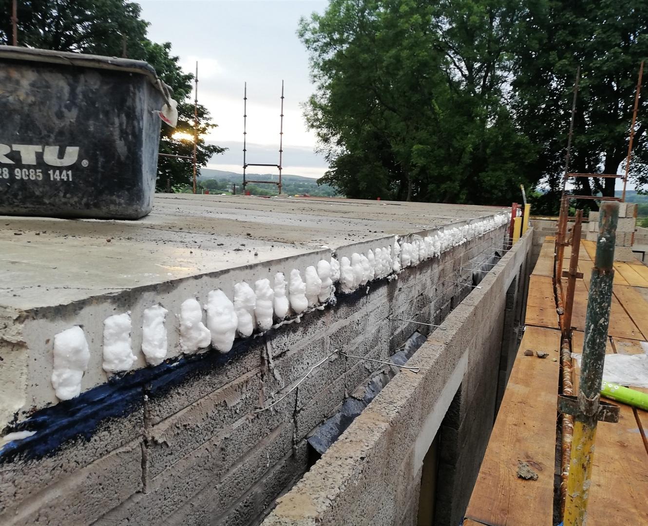

  12. And finally the slabs were lined up correctly (long story) and I was able to seal them up just this week. I first applied the foam to the open ends. Maybe could have used a little less in places, though not much less as it tended to slump over if applied to thinly. Expanded out quite a bit and I found it necessary, or at least neater, to apply it at least 50mm into the hollows. Plan had been to use the blower proof paint to seal the parged walls to the slabs, but with some gaps I found it easier to just use the foam. Probably cheaper too. You can see in the photo a bit of the dark blue blowerproof. In all I used 4 cans of FM330. There's 13m of slabs, so 26m of slab ends.

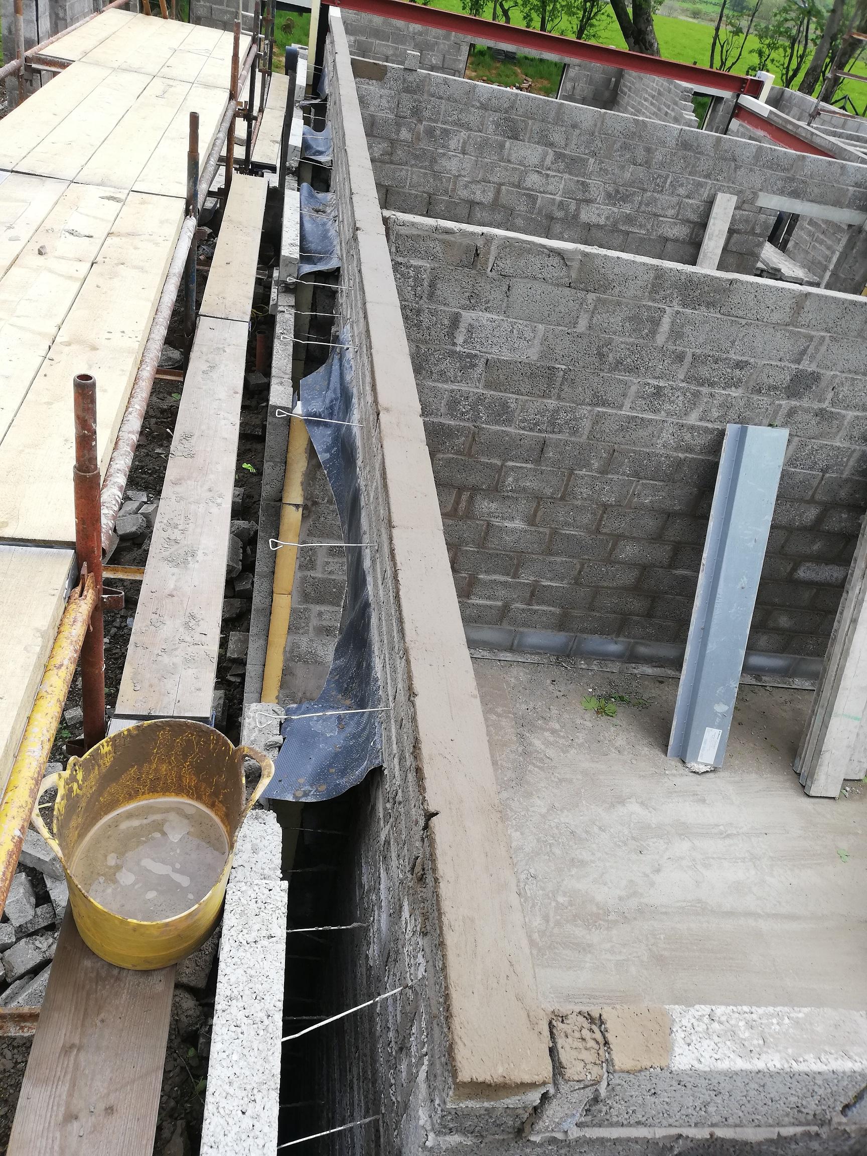

  18. After a slight cock up (not mine thankfully) we have one external wall that will have to be narrower than the rest (long story...) Original proposal from outside was: render, 100mm block, 240mm EPS blown bead, 100mm block, plaster. For this one wall it will have to be narrower, so builder is suggesting: render, 100mm block, 115mm Kingspan K106, 100mm light weight block, plaster. From Kingspan brochure: Both are around about 0.13 W/mK. Just wondering if there are any clever ideas for alternatives that result in the same or better u value and no thicker?
