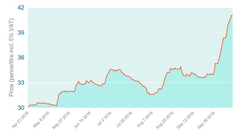

Looks like most of the rise is down to the oil price increasing. UK Oil up about 13%. Pound down about 5%.
Just a heads up that Heating Oil seems to be on the rise. Up 23% over the past 17 days. Mostly due to the falling £ I guess. Graph care of Boiler Juice...
