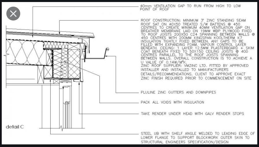

Re: Fire protection. I think this is still current. https://www.planningportal.co.uk/info/200130/common_projects/17/extensions/9 Re: Thermal Insulation: As much as you can get as per the cross section I posted. Ideally the roof members would rest on top of the beam rather than against the web so there is more room for insulation above the beam. Is there something (like a window on the first floor) stopping you making the roof thicker by putting the insulation above the ceiling joists? Edit: I see your diagram shows a "cold roof" construction that requires ventilation. Could you switch to a "warm roof" construction that puts the insulation above the rafters and UB and doesn't need ventilation? https://www.jtcroofing.co.uk/news/warm-flat-roof-cold-flat-roof/ -
Any feasible method to reduce RSJ cold bridge
Temp replied to tanneja's topic in RSJs, Lintels & Steelwork
It depends on the height of the roof/celiling. The beam is either "in the ceiling" or "in the wall" if you get what I mean. Ours are in the wall so the inside had vertical patches of plasterboard covering the beam and then the wall was plastered. It sounds like your beam is higher (or the ceiling lower) so the beam is best hidden in the ceiling as per that cross section. Either use taller ceiling joists and notch them for the bottom of the beam or fix battens to the underside so the plasterboard is a bit lower and covers the beam. -
PS The BCO will almost certainly want the beam clad with plasterboard to meet fire regs. So no exposed inner edge should be showing. -
Unless I'm missing something the UB/RSJ won't be 300mm wide. Has someone specified a particular size UB/RSJ for a reason compared to something like an insulated lintel? Whats the span? Heavy doors? Here is a section google forund.. -

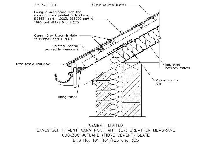

Puzzled by what my architect's drawing means
Temp replied to dnb's topic in Roofing, Tiling & Slating
Toolstation and Screwfix also sell membrane support trays .. https://www.toolstation.com/eaves-felt-support-tray/p43994 https://www.screwfix.com/p/felt-support-tray-1-5m-5-pack/36622?_requestid=448357 -
That drawing shows a block laid horizontally on the inner leaf. You wouldn't do that in practice as it bridges the cavity, instead there would possibly be an insulated cavity closure all around the window. In which case I don't see why a DPC is needed.
This page has various drawings. This one shows over fascia vents above a vapour permeable membrane. Others show ventilation required with "conventional underlay" etc https://www.fastrackcad.com/CADFrame.asp?Company_id=107&LevelEC=1&Level0=Cembrit&Level1=02%24FIBRE+CEMENT+SLATE+APPLICATIONS -
If the membrane is vapour permeable there is no need to ventilate UNDER it. However where slates or interlocking flat tiles are used its advisable to ventilate between the membrane and slates. This isn't necessary when textured hand made clay tiles are used because they don't lay flat and there are lots of gaps. So your sketch looks right. The vents are for the gap between membrane and slate and stop birds getting up there. They should also allow any rain that get blown under the slates to run down and escape. -
