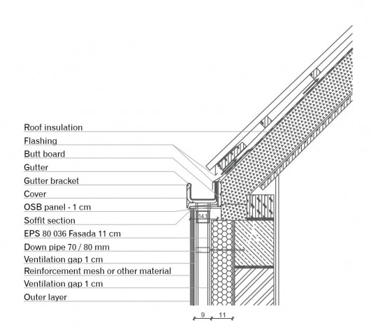

My first reaction to seeing this.. ...Is that heavy rain will overshoot the gutter. It will also be very important to get the details under the gutter right when its built. The facade tiles would need to be behind the drip bead shown. In case you are wondering.. you can't hide the gutter behind the tiles.
