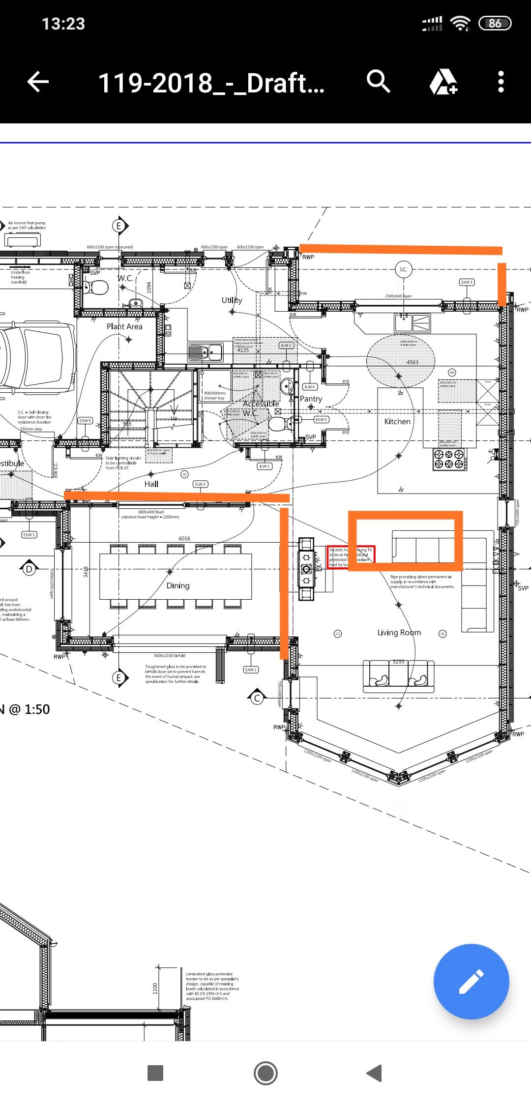

Declan52 Posted May 26, 2019 Share Posted May 26, 2019 Think if your going to get it built for your budget your going to have to make some hard decisions. The most obvious is the size. You could easily take 500mm of the length and breadth and not cause much heart ache. Two out door seating areas is for your budget 1 too many and maybe even 2. Your in the same position that the vast majority of us have all been. Every one has all these plans drew out with the wish list and then once you start to price it up you soon realise the budget dictates your final look. If you remove the dining room and extend the kitchen so the back wall is straight and extend the front another 500mm-1000mm this will let you get the dining table in between your kitchen and seating area. This having made the back wall straight will make the roof easier to do. I know it seems a pretty drastic step chopping a section of the house of but your going to have to weigh up do you want a formal dining room or do you want the out door seating area or the nice Windows at the front. The amount of glazing at the front will certainly cost plenty so you might have to either redo the size and shape or make other savings else where that allow you to have that very very nice frontage. Link to comment Share on other sites More sharing options...
Thedreamer Posted May 26, 2019 Share Posted May 26, 2019 From reviewing the plans there seems to be a number of different final weather skins. This improves the appearance of the house but makes things more complicated and more costly. The same applies to corners and bit's that stick out, this pretty much added a cost right from the start of digging a foundation trench to the final decorating. I was on a limited budget so decided to keep the design as a simple as possible but areas where cladding met render, different roof materials etc have been the areas that caused me the most stress. Link to comment Share on other sites More sharing options...
Bitpipe Posted May 26, 2019 Share Posted May 26, 2019 Pretty house but agree that the design is quite complicated. My eye was drawn to the first floor terrace above the dining room, I'd be sceptical that you'll ever use it and it will be expensive to have a flat roof that you can walk on plus the safety glazing to the perimeter - that will be thousands in its own right. Our architect specced balconies to the rear of our house for the master and guest bedroom. They look great, break up the back wall. Also cost a small fortune, complicated the frame design and we never use them. Would have rather had the additional space in the bedroom but there you go... 1 Link to comment Share on other sites More sharing options...

Mrs S Posted May 26, 2019 Author Share Posted May 26, 2019 3 hours ago, Declan52 said: Think if your going to get it built for your budget your going to have to make some hard decisions. The most obvious is the size. You could easily take 500mm of the length and breadth and not cause much heart ache. Two out door seating areas is for your budget 1 too many and maybe even 2. Your in the same position that the vast majority of us have all been. Every one has all these plans drew out with the wish list and then once you start to price it up you soon realise the budget dictates your final look. If you remove the dining room and extend the kitchen so the back wall is straight and extend the front another 500mm-1000mm this will let you get the dining table in between your kitchen and seating area. This having made the back wall straight will make the roof easier to do. I know it seems a pretty drastic step chopping a section of the house of but your going to have to weigh up do you want a formal dining room or do you want the out door seating area or the nice Windows at the front. The amount of glazing at the front will certainly cost plenty so you might have to either redo the size and shape or make other savings else where that allow you to have that very very nice frontage. I understand where you are coming from, but we’ve already taken away some previous rooms. We need the dining room as a future bedroom, as I have health issues, hence why we also have an accessible shower room. Link to comment Share on other sites More sharing options...

Mrs S Posted May 26, 2019 Author Share Posted May 26, 2019 3 hours ago, Thedreamer said: From reviewing the plans there seems to be a number of different final weather skins. This improves the appearance of the house but makes things more complicated and more costly. The same applies to corners and bit's that stick out, this pretty much added a cost right from the start of digging a foundation trench to the final decorating. I was on a limited budget so decided to keep the design as a simple as possible but areas where cladding met render, different roof materials etc have been the areas that caused me the most stress. Our external coverings have been dictated by local planning. We have to stay in keeping with the other houses in the area. We are trying to see if we can limit the more expensive finishes Link to comment Share on other sites More sharing options...

Mrs S Posted May 26, 2019 Author Share Posted May 26, 2019 4 hours ago, ProDave said: I have had a look at your plans. My overriding first impression is a complicated house to build. That is not what you want when you are trying to build it cheap. Does the plot size and shape dictate the shape? or do you have scope to simplify it? The plot has dictated the house shape, it’s triangular, narrow at entrance & the back. We also didn’t want the standard box shape house. It faces the coast, so we wanted to make the most of the views. We don't think it’s that complicated looking at it ? Link to comment Share on other sites More sharing options...
ProDave Posted May 26, 2019 Share Posted May 26, 2019 I would be inclined to leave off the flat roofed dining room. That will save a lot off the budget, but could be built as an extension later on when your budget has recovered from the main build. Link to comment Share on other sites More sharing options...
Declan52 Posted May 26, 2019 Share Posted May 26, 2019 You could build the garage as part of the heated space, with insulated walls and floors, and if needed then it's only a garage door that needs swapped for a set of sliders to give you another room. Link to comment Share on other sites More sharing options...

Mrs S Posted May 27, 2019 Author Share Posted May 27, 2019 10 hours ago, the_r_sole said: Really? You've got 4/5 different finishes I think it would be an easy sell to the planners to have a reduced palette of materials like most houses At present we have 4, but one will be removed if we change the roof type, which will leave us with the 3 finishes that we MUST have as per our planning regs. Link to comment Share on other sites More sharing options...

Mr Punter Posted May 27, 2019 Share Posted May 27, 2019 A few points: The flat roof above the dining has not been designed with a fall and one is required. This may mean a step up to the balcony area from the hall. Price the terrace separately as it is likely to be very expensive once balustrade and paving is added. There is lots of East facing glazing to bed 1 so the sun will be there first thing (although in Scotland this is not a given). Curtains will be very hard to achieve and you may well get overheated in the morning. Unless you have mountains looking up I would go for normal windows or at least price them in comparison. Windows are much costlier than walls and far worse at insulating. Get the facing materials priced for comparison. I imagine the stone is fairly pricey so you could reduce it where the external fan units are. There seems to be some metal cladding, which can also be expensive. Look at any other local materials and get prices for these too. As per earlier, you could finish the roof in concrete tiles and save a fortune. Make the downstairs shower wheelchair accessible and fit the walls out for future grab rails, seat etc. Consider making it a wet room. Link to comment Share on other sites More sharing options...
bassanclan Posted May 27, 2019 Share Posted May 27, 2019 The design is far too complicated to be brought in on a £1000/sqm budget. The architect has not understood your financial constraints at the start. With tweaks you might get a similar looking house at a lower cost, but would mean going back to planning etc. Link to comment Share on other sites More sharing options...
