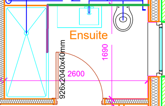

ultramods Posted April 24, 2019 Share Posted April 24, 2019 I can't decide if I should tile the wall I have highlighted green in the ensuites? The only reason I would tile the wall is to help keep the wall clean. I want the wall to look like a white painted wall, I have managed to find a large format matt white tile, however this is more expensive than simply painting the wall. Also the tile is 600 x 600 whereas the rest of the tiles on floor and shower area are 750 x 750. I don't like it when part of a wall is tiled, or there is a tile upstand above the basin, so it's basically all or nothing. Do you think I need to tile the wall or would a washable paint be OK? The basin and toilet are both wall hung. I have highlighted the shower screen with purple. Link to comment Share on other sites More sharing options...

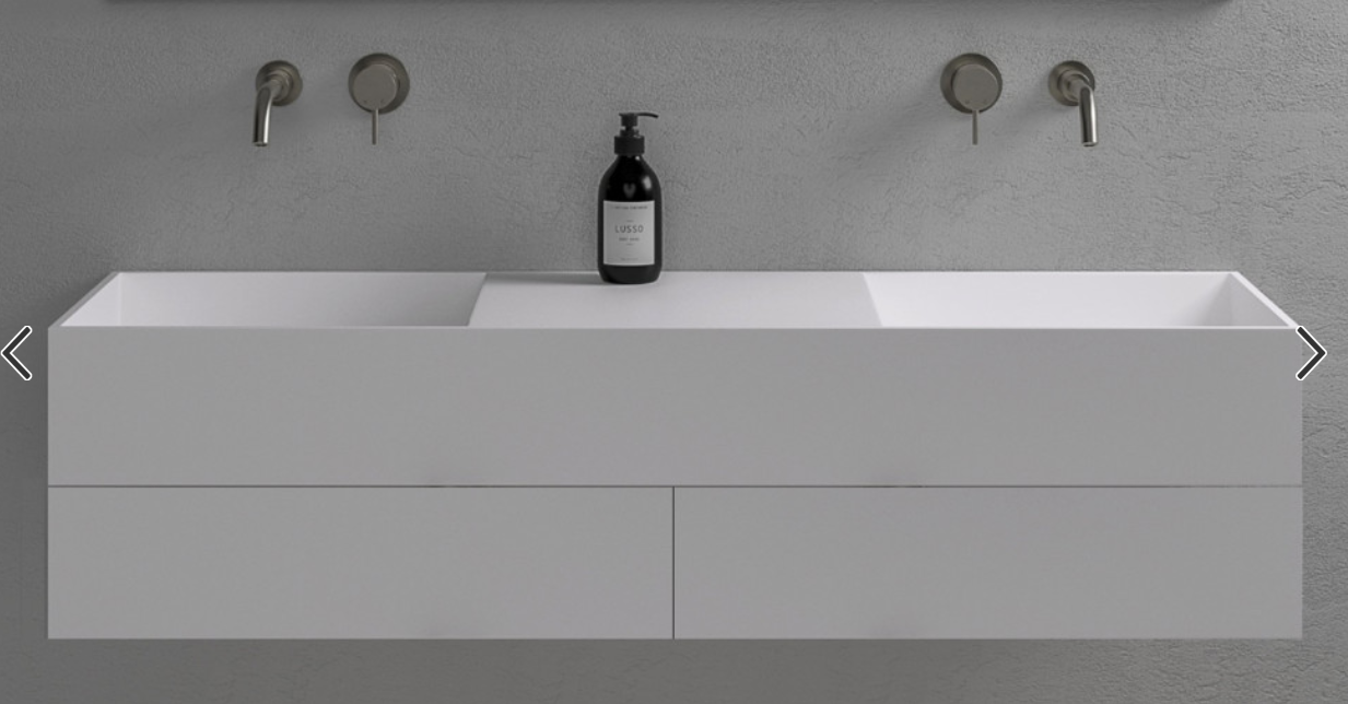

ultramods Posted April 24, 2019 Author Share Posted April 24, 2019 1 minute ago, Nick said: I've had this in a previous building and the painted wall always ended up looking grotty. If not tiles, then maybe a glass splashback? Is it just grotty where a splashback should be? If it is I would maybe consider using a 100 mm upstand that is the same material as the sink. Do you think 100 mm would be sufficient as that is the only height they do? This is the basin that we will have. 1 Link to comment Share on other sites More sharing options...

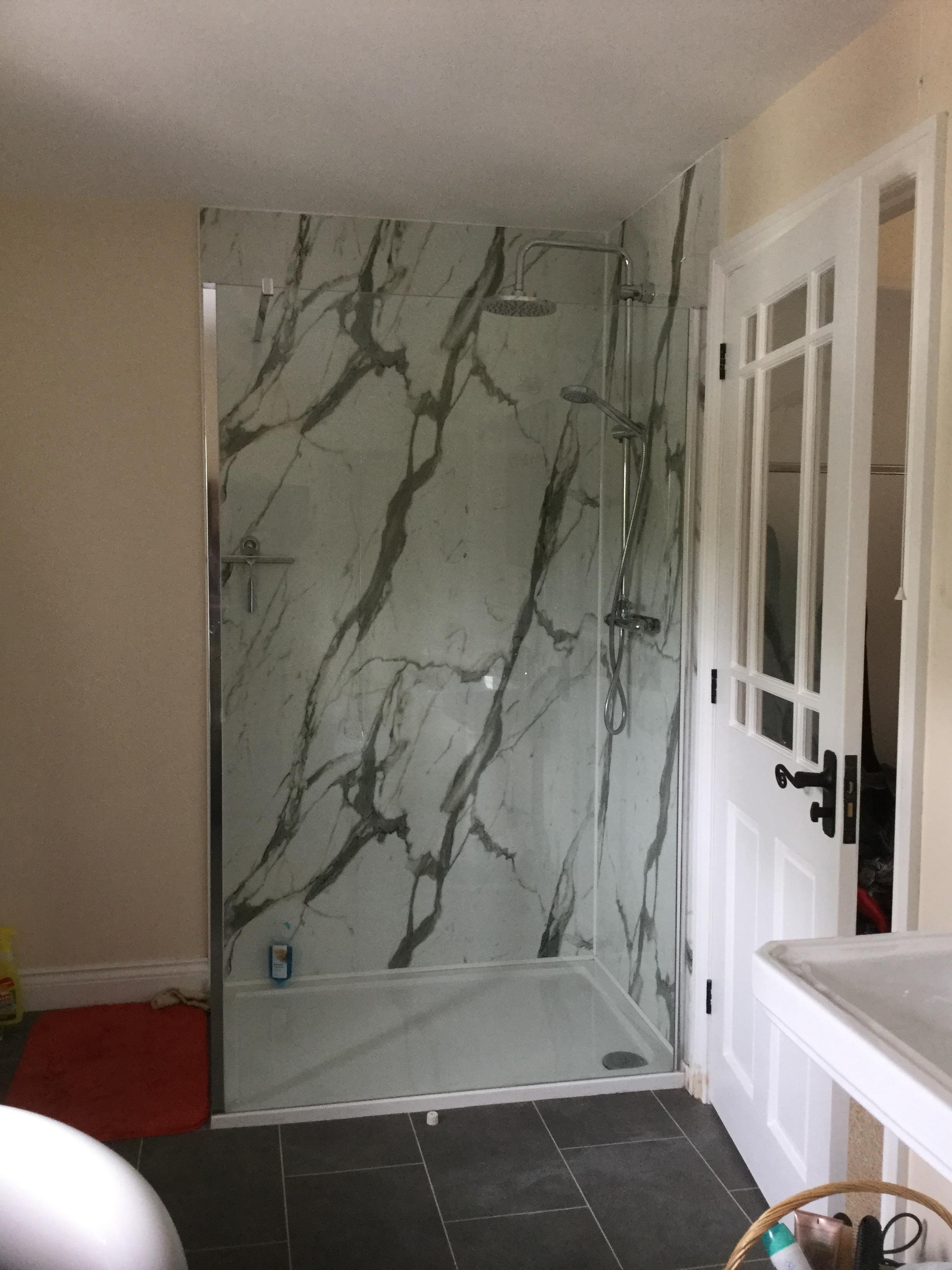

ultramods Posted April 24, 2019 Author Share Posted April 24, 2019 3 minutes ago, joe90 said: After years cleaning grout out and retiling for myself and others, I now hate tiles. I have used aqua wall board in both my new bathrooms and they are great and sooo easy to clean Can you share any photos please? I had looked at some of the aqua panel options, however didn't like the joins between panels. Link to comment Share on other sites More sharing options...

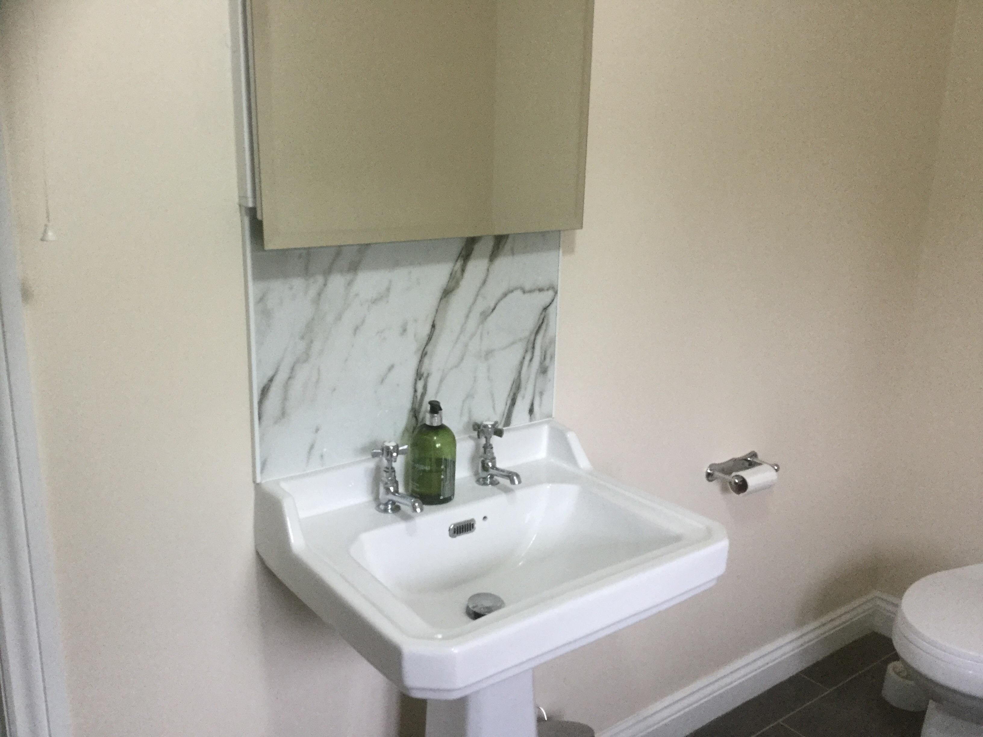

joe90 Posted April 24, 2019 Share Posted April 24, 2019 (edited) 21 minutes ago, ultramods said: Can you share any photos please? I had looked at some of the aqua panel options, however didn't like the joins between panels. Yup, I used aqua panel like @JSHarris but managed to use whole sheets for the showers so the only join was in the corner. I also used smaller pieces to make the basin splash back to match Edited April 24, 2019 by joe90 1 Link to comment Share on other sites More sharing options...

ProDave Posted April 24, 2019 Share Posted April 24, 2019 Another vote for Multipanel, that's what we have. Get it from a builders Merchant, Jewsons stock it, a lot of the "bathroom" showrooms charge very inflated prices for it. Available in loads of colours and patterns. 1 1 Link to comment Share on other sites More sharing options...

ProDave Posted April 24, 2019 Share Posted April 24, 2019 Just to add, we used a black Multipanel board behind the basin, to contrast with the white panel around the shower and white floor tiles. 1 1 Link to comment Share on other sites More sharing options...

ultramods Posted April 25, 2019 Author Share Posted April 25, 2019 On 24/04/2019 at 18:57, Red Kite said: I liked the sink unit- can you share where it comes from? How does the waste work? I would want a splash back to above the taps as I think you will need it. The sink is from Lusso Stone, it's a bespoke variation of this design https://www.lussostone.com/vanity-units-c11/lusso-stone-thinn-slimline-double-basin-draw-vanity-unit-1200-p465 If you go to the link above you will see various images and drawings of the sink, including how the waste will work. Link to comment Share on other sites More sharing options...

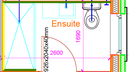

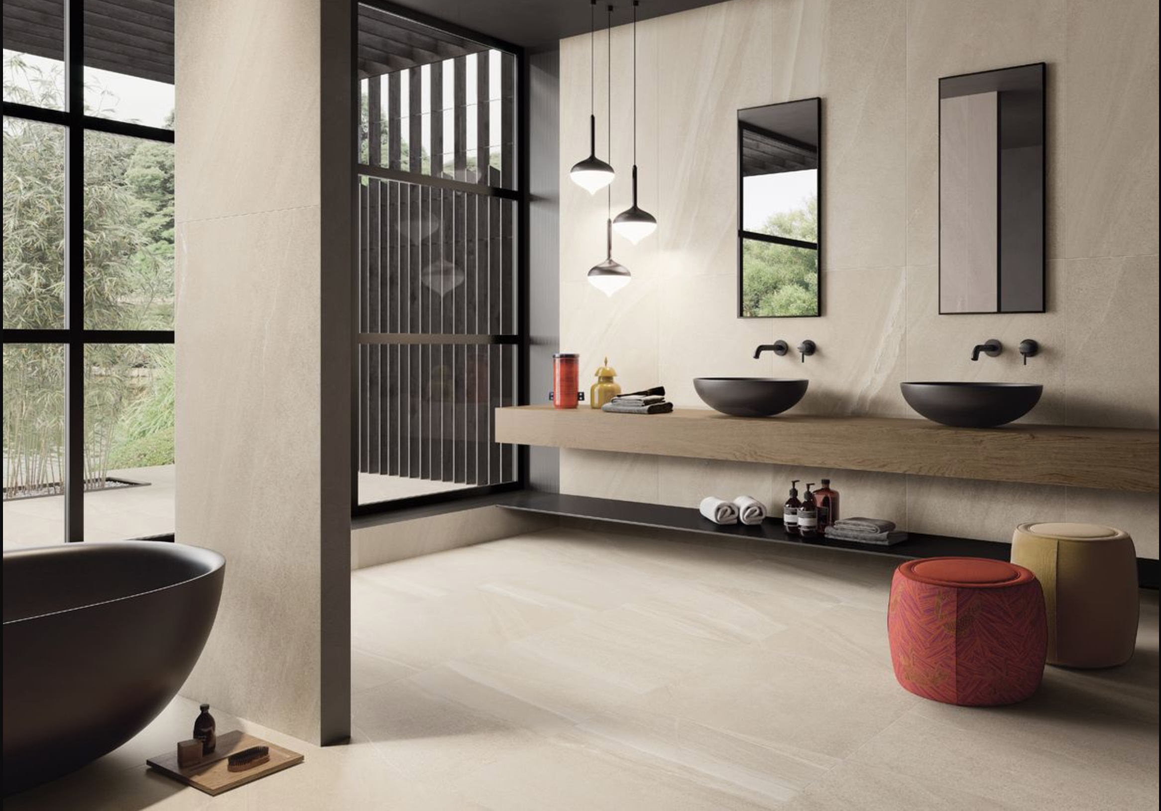

ultramods Posted April 25, 2019 Author Share Posted April 25, 2019 Thank you all for the advice and suggestions. We have decided that we will go with floor to ceiling large format tiles, which should reduce the amount of grout. The photo below is the look we are aiming for. The green walls will be 750 x 750 matt white tiles. The floor will be 750 x 750 Imola Ceramica Lime-Rock tile below (as will be most of the flooring in the house) The yellow wall will be a feature wall using the darker Lime-Rock below. Link to comment Share on other sites More sharing options...

Ferdinand Posted April 26, 2019 Share Posted April 26, 2019 7 hours ago, ultramods said: The sink is from Lusso Stone, it's a bespoke variation of this design https://www.lussostone.com/vanity-units-c11/lusso-stone-thinn-slimline-double-basin-draw-vanity-unit-1200-p465 If you go to the link above you will see various images and drawings of the sink, including how the waste will work. I like that. But "50% less to £800". Er .. ouch. Probably needs the VAT Reclaim ? And I need a vanity one mainly supported from the floor. F Link to comment Share on other sites More sharing options...
