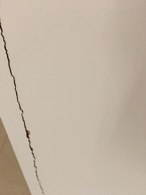

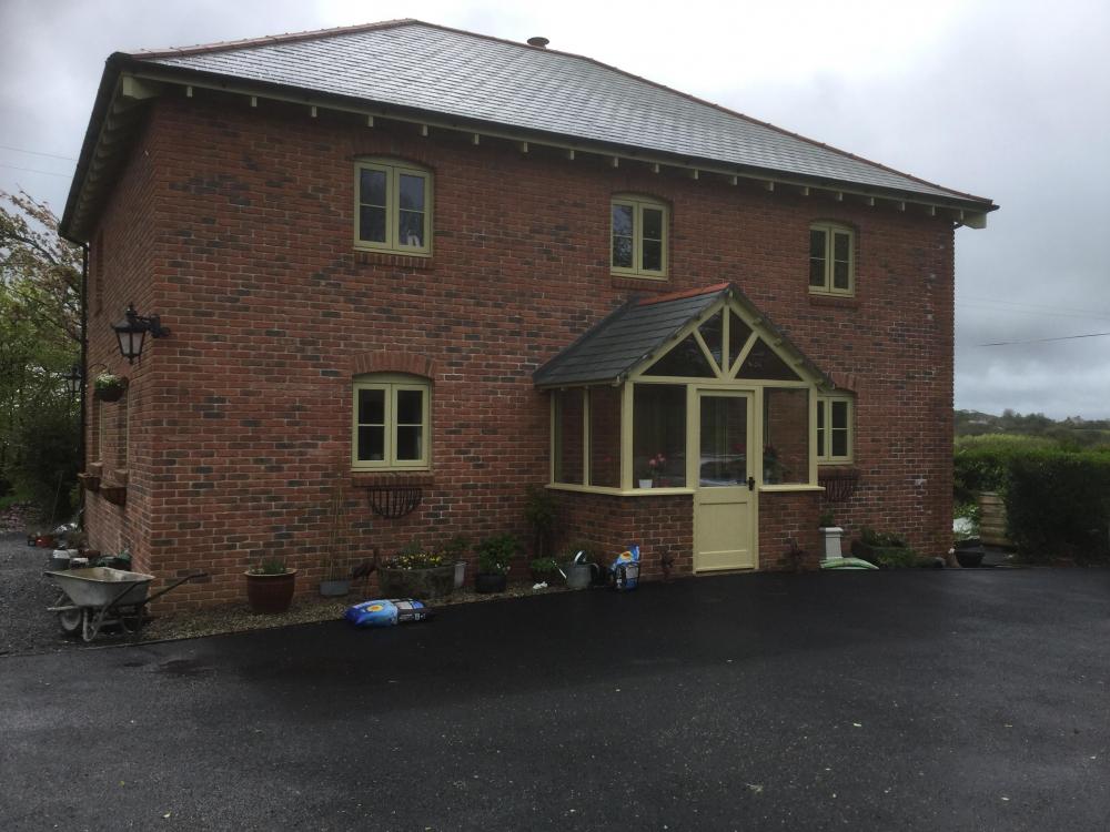

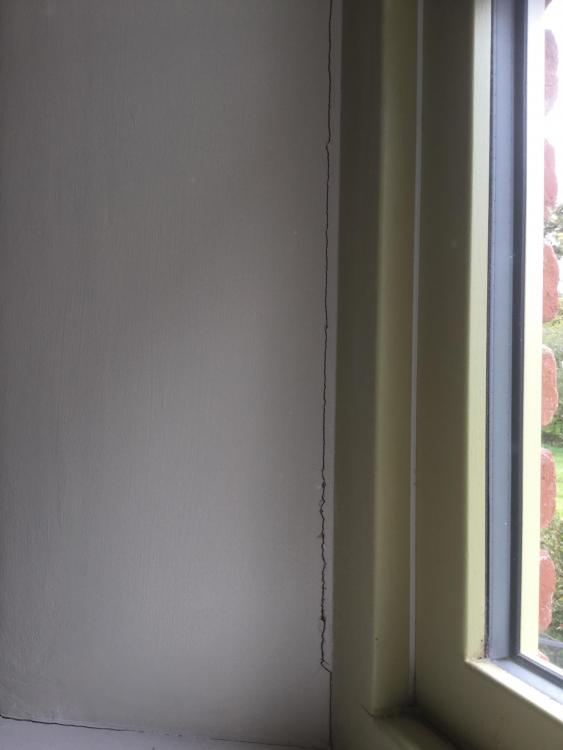

joe90 Posted April 4, 2019 Posted April 4, 2019 Although I was very impressed with MBC timber frame on passive slab build I went brick and block with passive levels of insulation, locally made very good (double glazed) windows. Whatever the construction we wanted a brick skin outside. Going timber frame would have allowed me to do more ( I love woodwork and have all the tools). We are very pleased with the result but was lucky to have a very good builder. Only one thing I would change is the lack of sound insulation between floors, voices can be heard so I wish I had double boarded the ceilings or sound bars for hanging the ceilings. It’s a “heavy house” and with UFH downstairs only but towel rads and electric UFH in the bathrooms we find that sufficient (well, er indoors says it’s cool sometimes but I point to the readout on the wall and say “but it’s 21’ in here!) she is only warm if she is next to a red hot radiator or roaring woodburner ?. 1

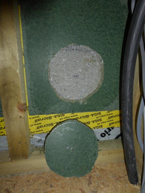

Jeremy Harris Posted April 4, 2019 Posted April 4, 2019 I'd use the same build method for sure (also MBC, twin stud with blown cellulose), as the combination of good airtightness and insulation, plus the unforeseen benefit of really good acoustic insulation, makes for a really comfortable home. I'd not use the same window supplier, but would still go for aluclad 3G, but would spend a bit more on one of the better makes and fit solar reflective glass to reduce the solar gain in spring and autumn. I'd also fit external blinds to all the windows that get any sun, as that's probably the other major regret I have. I'd have argued more forcefully to be allowed to have a different external finish, as although we like the larch cladding it has been a bit problematic with noises as it heats up and cools down and with fasteners breaking/pulling out. It also seems to have attracted cluster flies, which are a bit of a nuisance in spring and autumn. I'd not opt to fit the relatively expensive Genvex MVHR, even though it's pretty good, as it's not as effective in cooling mode as I'd like. I think that a cheaper and simpler duct cooler plumbed to the ASHP would do as good a job, or perhaps better, and would be a bit quieter (the Genvex does make a gentle hum when its internal heat pump is running). Like @jack, I'd get a lighting designer involved with the lighting in the living room, kitchen and dining room, as my efforts are functional but not very inspiring. I wouldn't change the heating system at all, and we're absolutely fine with no heating in the bedrooms (it's just not needed at all, even in the coldest weather), but I would add low power electric underfloor heating in the bathrooms, just to take the chill off the stone flooring. Finally, I think I'd have just bitten the bullet and spent the big wedge of cash to get mains water and drainage in. The borehole is fine, but there is a bit of maintenance involved in keeping both it and the treatment plant working, and I think that, on balance, being connected to mains services is probably a better long term solution, especially as I get older. 1 1
