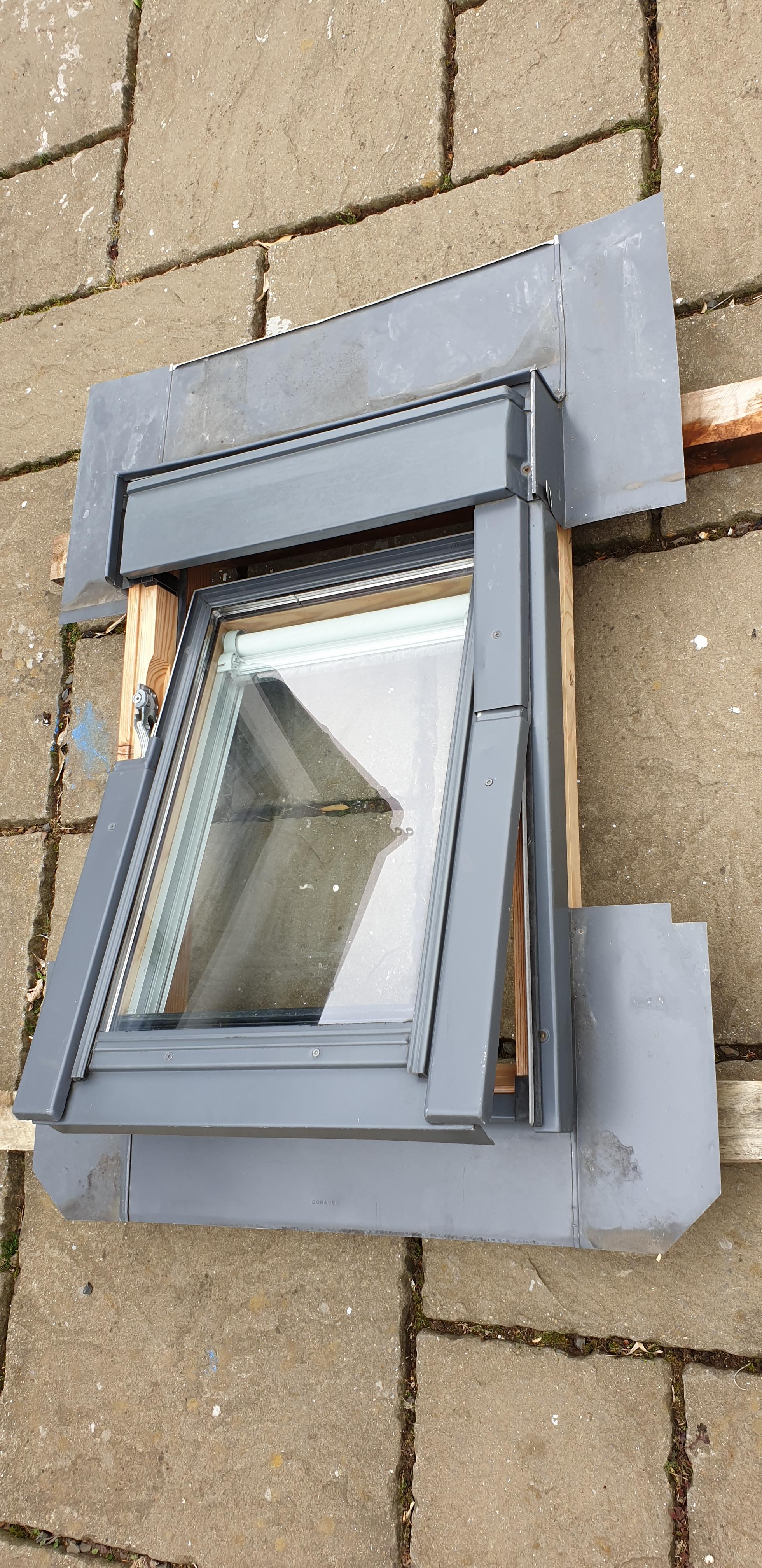

  • I spent a long time looking at velux installations in corrugated tin and NOT ONE was done well....... I looked at why they were done badly and then sat down and worked out how to do it well. I did the

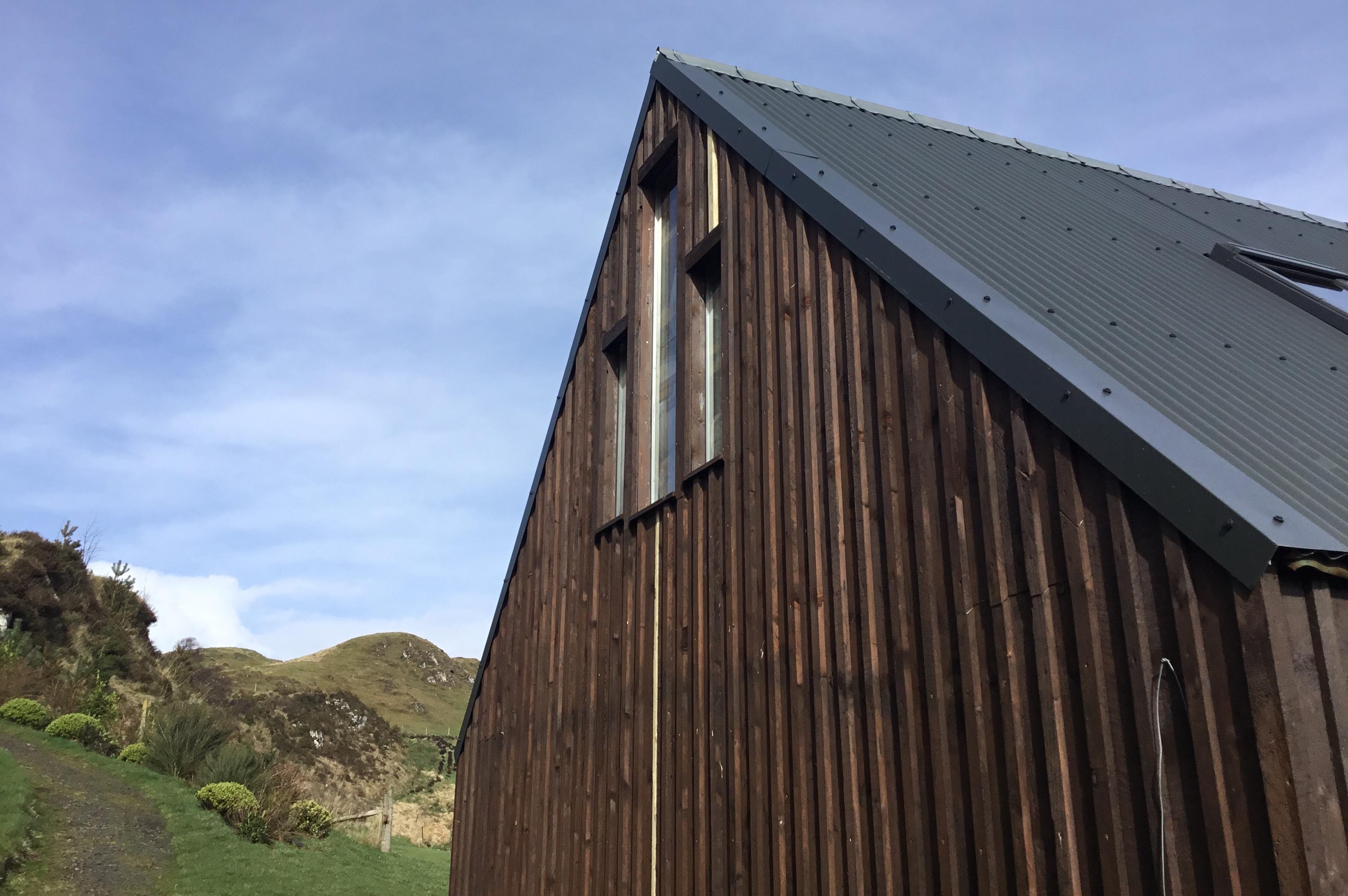

  • Just a small detail in regards to gable flashing onto timber cladding, I have found that leaving a small gap between the roof flashing and the timber stops water running down the timber, not sure if t

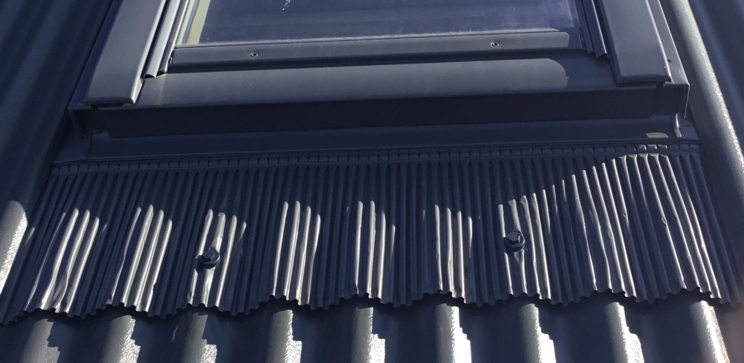

I spent a long time looking at velux installations in corrugated tin and NOT ONE was done well....... I looked at why they were done badly and then sat down and worked out how to do it well. I did the layout and install myself as the devil is in the detail if you want it all to line up and work properly. The most important aspect for me was the position of the windows and there size in relation to the corrugations in the tin sheets. You need to make sure that one sheets edge will end with with a non cut  downward sloping corrugations that falls directly into the inner gutter of the velux..... you then need to know that the windows width is also correct so that the far side gutter lines up with the next sheet of tin enabling that tin edge to fall in the opposite velux gutter...... then if you have multiple windows (I had 4 in my roof) you need to make sure that they all correspond with the corrugations.  There really is very little to play with on the set out as the tin does not allow for error, you get about 10-20mm of space in the flashing gutter to play with but you really want the tin edge  to fall in the middle as if it’s to close to the window it could block up with leaves or moss, to far and it’s not going to be as effective, also ANY error will be carried over to the next window as the corrugation spacing is set.  It’s possible with very carful layout but if this is done wrong your going to have another example of how not to do it.......  if you find a contractor that says they can do it INSIST to be able to go and look at one of there installs..... I visited 3 different installations done by 3 different professional roofers and I would not have payed for the work......
Hi @Cpd
thank you so much for your detailed information and pictures that really helps. It is also worrying that you have seen multiple installations and all of them have issues.

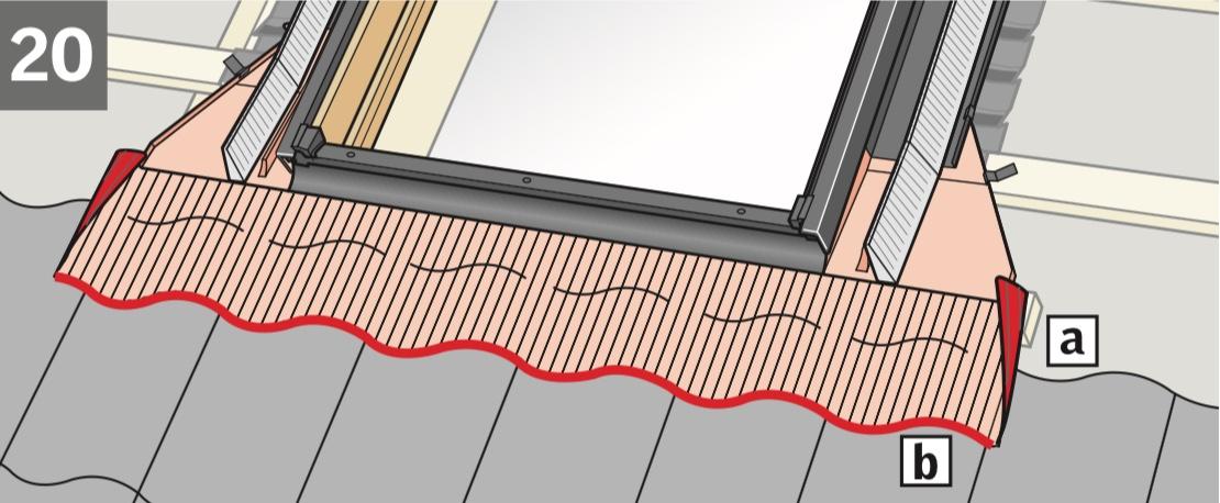

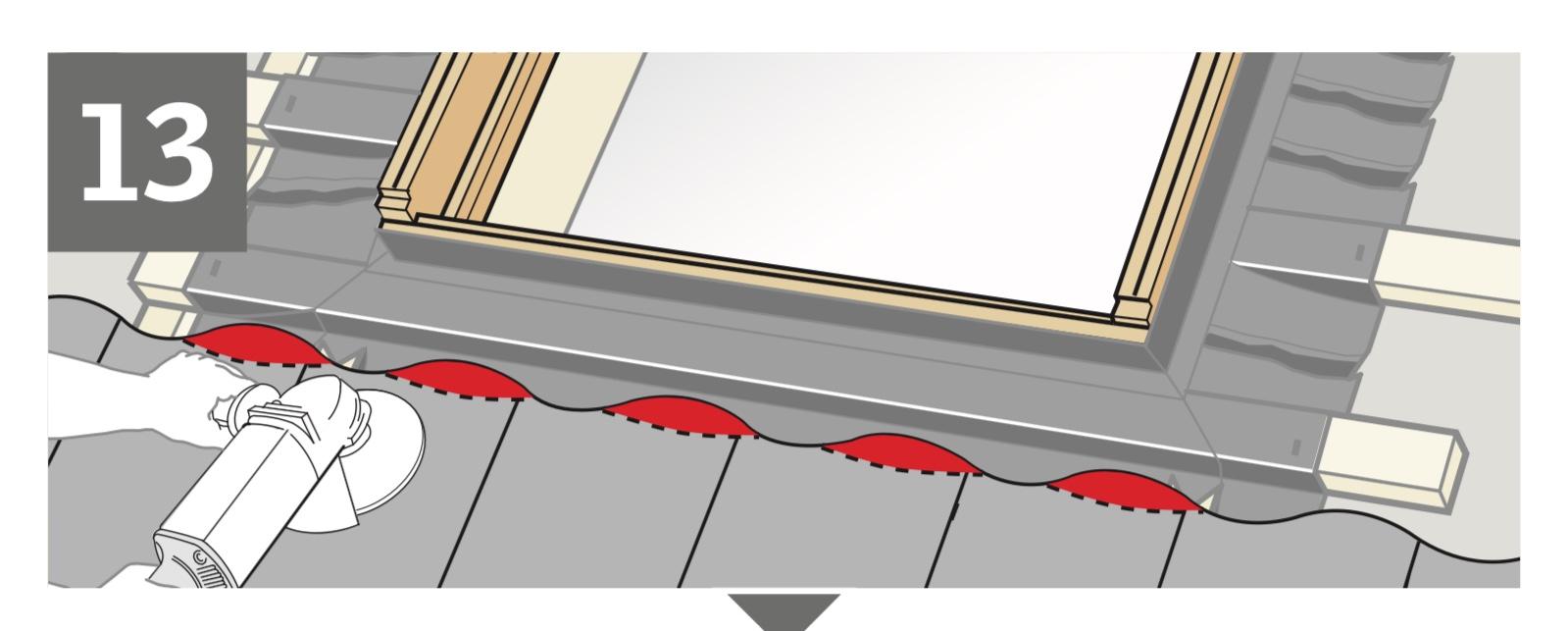

Ok Velux state that you must use the EDJ flashing kit with the roof light when combined with corrugated roofing and a slope between 15 and 90 degrees. The document is just a series of pictures which I assume will be good for anyone who has installed these before. I will keep you posted on progress but this is a very useful start. Thank you.
Customer Support Mailbox <[email protected]>
16:19 (10 minutes ago)
to me
cleardot.gifGood Afternoon Tom,
Thank you for contacting VELUX.
Please see attached, the installation instructions for installing a VELUX window into corrugated sheeting.
If your corrugated sheeting:
> Has built in installation (is double skin) + is being used on a roof pitch of less than 15° - You will need to create an on site upstand and use a VELUX ZWC Special Head Flashing
> Has built in installation (is double skin) + is being used on a roof pitch of more than 15° - No upstand will be required however you will still require a VELUX ZWC Special Head Flashing.
> Has not got built in installation (is single skin) + is being used on a roof pitch of less than 15° - You will need to create an on site upstand and use a VELUX ZWC Special Head Flashing
>  Has not got built in installation (is single skin) + is being used on a roof pitch of more than 15° - You will need to use our EDW flashing kit (standard installation) or our EDJ flashing kit (recessed installation).
Please follow the below links to get access to the relevant information for your requirements:
ZWC Window Profile Set - Single Installation
EDW Installation Instructions
EDJ Installation Instructions

Looks like your on the right track.

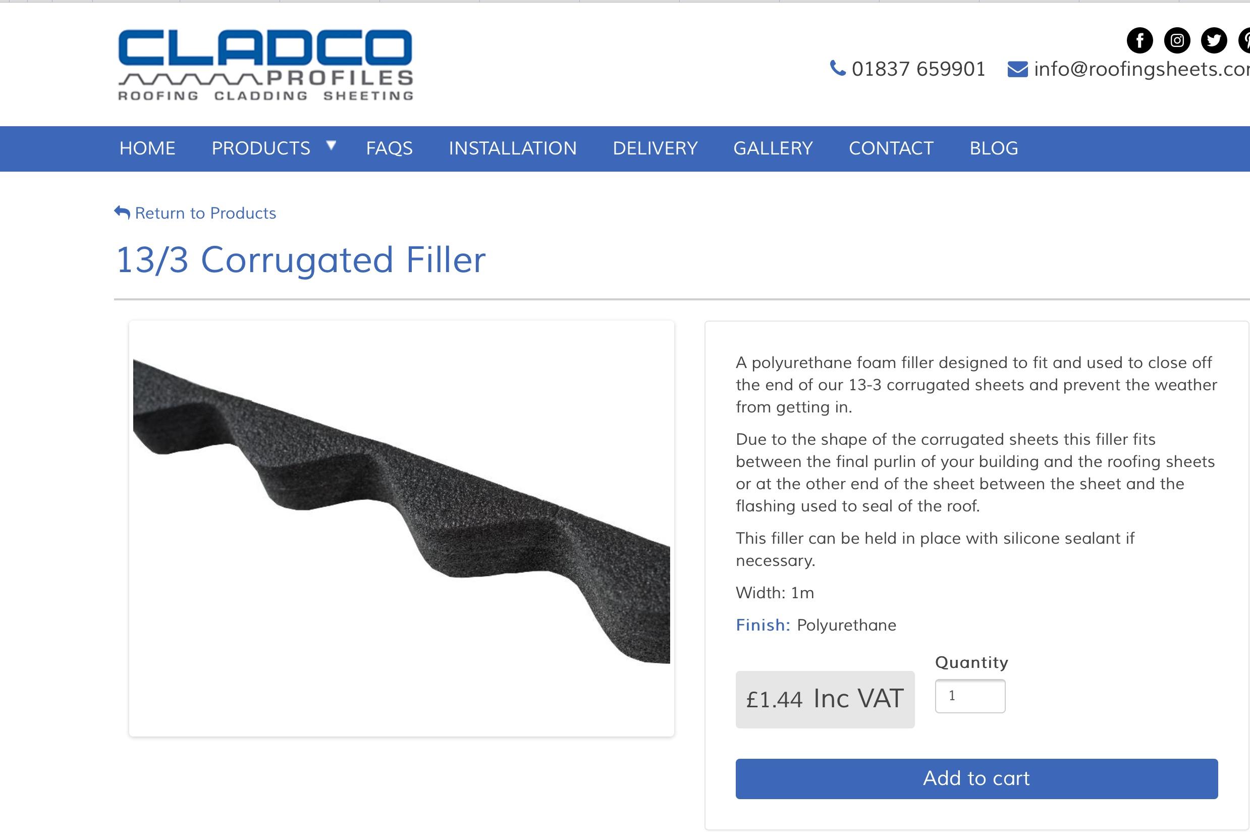

Just be aware that you need to be carful when it comes to this part of the flashing, you want to get the tin as far up near the window as you can without damaging the flashing, it’s not as easy as it looks. If your in a windy location (I am in a very exposed spot) then I would advise adding in a couple of fixings as shown in my photo, it’s not a good thing to be screwing through a flashing  but for me when it was not done the flashing would lift in wind and rain tracked straight up the corrugations and under the flashing. I flattened a very small section of the flashing, drilled the holes in the centre of the flat spots and put plenty of CT1 in and around before screwing down. It’s withstood 75mph + winds over the winter without any damage.
Ooo I just saw this in your instructions about cutting the tin of at an angle, I either missed this or it’s been recently added but definitely a good idea to help with getting the tin up nice and high and getting the flashing to sit down snug.
Hi @Cpd

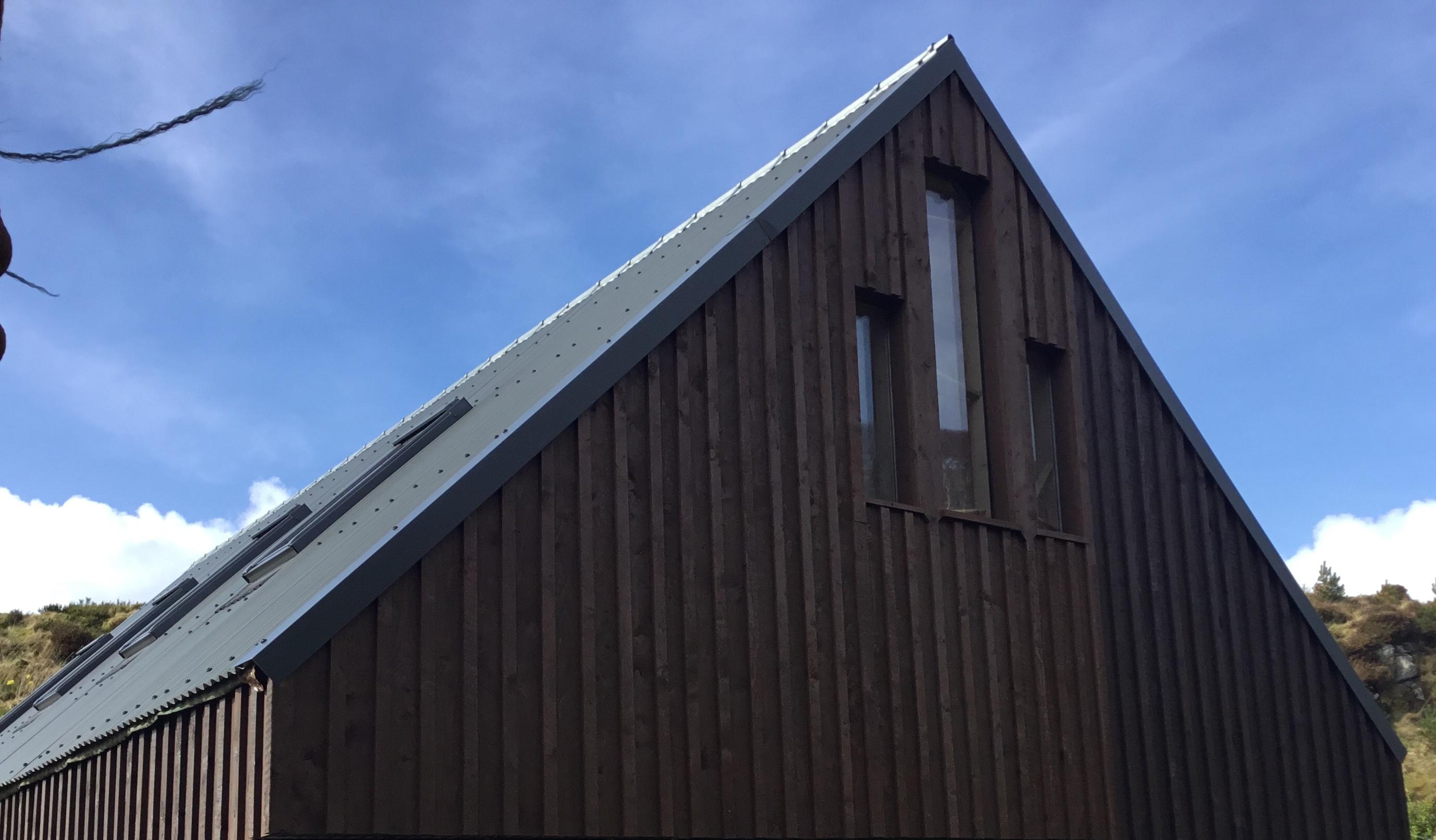

thank you for the additional information. I had noted from the initial photos how you have screwed down the flashing in order to stop lift in strong winds. The cutting is also a good idea that I had not really focused on. I assumed from various bits of info online that the valleys should also be turned up using a special tool as a way of stopping wind driven rain. Do you do this on your roof?
Also, on the ridge how did you ensure wind driven rain was not pushed under the ridge profile. The profile you have is not one I have seen before. Can you let me know where this came from; it is definitely different from the ones I have looked at to date.

The velux flashings are complete with pre made valleys and DO NOT need adjusting AT ALL. The flashing apron that needed the extra fixings is designed to be moulded into the profile of your desired roof. I use this type of ridge as I have it on my two other buildings either side of this one and I wanted to keep it looking uniform, however I WOULD NOT recommend this type as it is NOT SUITABLE for this job without adapting it at the cost of lessening it’s life span. I will at some point replace with the recommended ridge. To stop water blowing up as it does where I live you need to insert a rubber strip, with the correct ridge this would work brilliantly but with this ridge it was a right faff to fix and I had to depress the edge of the ridge in every corrugation to get it to hold the rubber in place....... so go with the standered ridge. I would also highly recommend getting a slightly different sized flashing than standered for the gable ends, it’s normally 200x200mm wide but this looks really shed like from the end of the buildings instead consider getting it at 200x115mm the 200 goes on top of the tin giving good coverage and the 115 goes over the gable and looks way better than 200mm and still works 100% any other questions just ask. Col
just tried to to upload photos but it’s refusing to work..... I will try again soon.
Hi Col
many thanks for the pictures; the house looks great. Your advice re the edge flashing is spot on and matches recent advice from an architect who built a school building with a corrugated roof and vertical timber.
I really like the three windows at the top of the gable.
I have just been looking at the tinhouse on the Isle of Skye. The corrugated roof Alan has fitted is very good and the detailing around the skylights looks as impressive as your work.

Hahaha...... it’s my shed ! It was seriously damaged in a storm and needed reroofed and one job led to another and I I ended up re cladding about 75% the velux were the prefered option over clear sheets of corrugated as you can open them and this helps with  ventilation. I got given a huge amount if new double glazed glass for nothing and try and use it where I can, I was playing around with a lot of ideas and in the end I liked this configuration on the gables, the aim is to give a sense of familiarity to a church window but not so much that it could be mistaken for trying to be one....... if you get what I mean!.  I am rebuilding the doors at the moment, there are three as it used to be a very traditional threshing shed with two doors exactly opposite each other  so the wheat  could be beaten and the chaff would blow out the opposite  door, the third door was probably where the animals or humans lived, I am replacing all the doors with stable doors so you can open just the top section if you like, again great for lots of ventilation. The upper level comprises of two mezzanines and would  have been used for storing wheat and hay or other goods you wanted to keep dry. Ok well off topic now........

Hay Stuart, yes I used off the shelf flashing kits that did not need any alterations, I am not sure of the flashing kit code but it’s the one designed for wriggly / corrugated tin, I will see if I can track it down..... I’m pretty sure it’s not the slate flashing kit as I have used that on another roof and the skirt is very different. (Photo included) I am also pretty sure that like your tin my tin has a high edge on one side and a low edge on the opposite side, you want the low edges to go into the velux gutter not the high edge as this will not be as effective... I think I just turned the sheets around to get a high edge to fall into each gutter, you should lay the sheets in a specific way to so that the exposed edges are not facing the prevailing wind, but to get them to fit into the gutter on both sides of the velux you need to break this rule..... my roof FACES the prevailing wind so it did not matter as the wind NEVER blows from either side as I am in a narrow glen facing  the prevailing wind. But it may be something you need to consider. I can’t think of why the flashings I used would not work with box profile, but I would need to see the exposed flashing again to be sure that it would work 100%

No you need to get the edge of the tin to line up with the middle of the inner gutter, remember that the tin has two different edges, a high edge and a low edge, you want the LOW edge to fall into the gutter, depending on the spacing between the box profiles, (wriggly tin is better as it gives you more options ) you then want the the next sheet of tin to fall with its edge exactly in the centre of the gutter on the other side of the velux......... this is where it may get tricky because you are using box profile and there is NO GUARANTEE that the pre set spacing of the box profile will match the width of your windows.......  if it does not match then it’s not going to work FULL STOP.
Ok have a think about what I have said and come back to me if you have more questions.
I think your your going to need a bit if luck as it will be pretty unlikely that the box profile will match your existing window widths but here’s hoping......

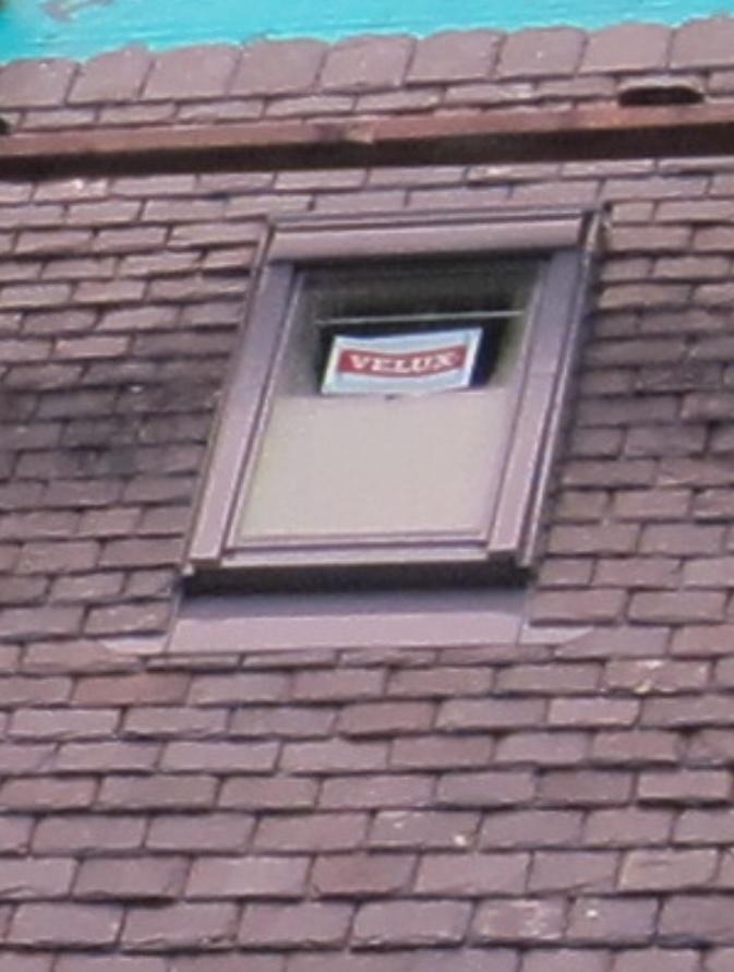

photo of slate flashing kit, note the skirt is rigid and you want the flexible one as shown in my earlier photos.

I have measured the profile of the roof sheet and the width of the Velux windows and it should work nicely. The width of the windows is 55cm and the distance between the profiles allows for the low sections to fall either side of the windows which is perfect!
What I am thinking about doing is to utilize the slate tile flashing apron, trim it down a bit in length and with some Velux ZZZ 166 corrugated flashing make my own apron. The plan is to fix the Velux ZZZ 166 corrugated flashing to the bottom of the window frame and dress over the roof panel, then fit the trimmed down slate apron over the top with a strip of 50mm x 1.5mm Butyl double sided tape between the two to stop any water being blown up between. The slate head flashing should work fine as I can get a foam filler matched to the sheet profile which I can slip in under the edge of the roof panel just above the window to keep out and wind/rain/snow etc. Then down the sides of the window I plan to fold/fabricate some 200m wide lead flashing to 90 degrees which will then tuck under the head flashing and overlap the apron flashing. Where the roofing sheets overlap the fabricated side flashing I plan to again put some Butyl double side tape to seal up the egdes to stop wind/snow etc.
I'm pretty sure this should work, but if any one can see anything I have overlooked please feel free to comment!
I should probably also add/fold some lips to the edges of the side flashing and sides of the apron flashing to stop any water creeping out to the sides?
