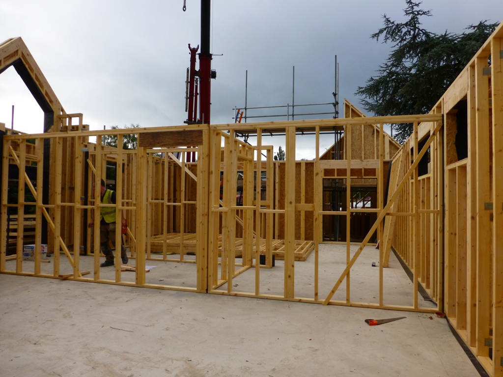

Jeremy Harris Posted February 18, 2019 Posted February 18, 2019 TBH I don't know. I've liked the idea of steel studs ever since seeing them in France, when a friend was renovating his house there. Looked a lot easier to get straight walls than when using timber. Having said that, all the internal stud walls for our frame came pre-assembled and were dropped in by crane along with the other panels for the frame, so all our ground floor stud walls were in place by 4pm on the first day of the frame going up. They were all dead straight and square, too. This photo was taken a bit earlier during the afternoon of the first day of the frame going up. You can see some of the internal walls that haven't been installed in a stack at the back: 1

ProDave Posted February 18, 2019 Posted February 18, 2019 Like @JSHarris our house has 2 internal supporting walls either side of the stairwell (in many ways it is a similar house layout). They serve 2 purposes, firstly to support the 11 metre long ridge beam, and secondly to minimise joist spans by allowing the joists to span the width of the rooms. These were the only internal walls supplied by the builders. All the other non load bearing internal walls were built by me and could have been metal if I had wanted. If we had tried to get a shell built with no internal walls at all, then the joists would have had to span front to back making them longer and bigger, and you would still have to find a way to support that ridge beam. So by all means ask the designer to minimise the number of load bearing walls as much as reasonably possible and then only supply and erect the kit with just the load bearing walls. The other thing I did to "simplify" the build was I stipulated no sleeper walls downstairs. The initial design had sleeper walls to help support the ground floor joists, but I argued the upstairs joists can span that gap with no intermediate support, so specify downstairs joists than can as well. 1

Russell griffiths Posted February 18, 2019 Posted February 18, 2019 You may find an internal wall may not be load bearing but it may be there as a racking wall, long runs of exterior walls will need internal walls to stop buckling and other things can you imagine building a complete outer shell with no internal walls, it would need to be very stiff to withstand wind pressure and loading from the trusses i would check with the frame manufacturer before getting to intothis idea. It maybe that that they can build in some nibs,and then you continue in steel, but that seems like a lot of hassle. 1
ProDave Posted February 18, 2019 Posted February 18, 2019 19 minutes ago, Russell griffiths said: You may find an internal wall may not be load bearing but it may be there as a racking wall, long runs of exterior walls will need internal walls to stop buckling and other things can you imagine building a complete outer shell with no internal walls, it would need to be very stiff to withstand wind pressure and loading from the trusses i would check with the frame manufacturer before getting to intothis idea. It maybe that that they can build in some nibs,and then you continue in steel, but that seems like a lot of hassle. Very true. My 2 internal load bearing walls either side of the stair well are also for racking strength, and for that reason covered on one side in OSB before the plasterboard. 1
