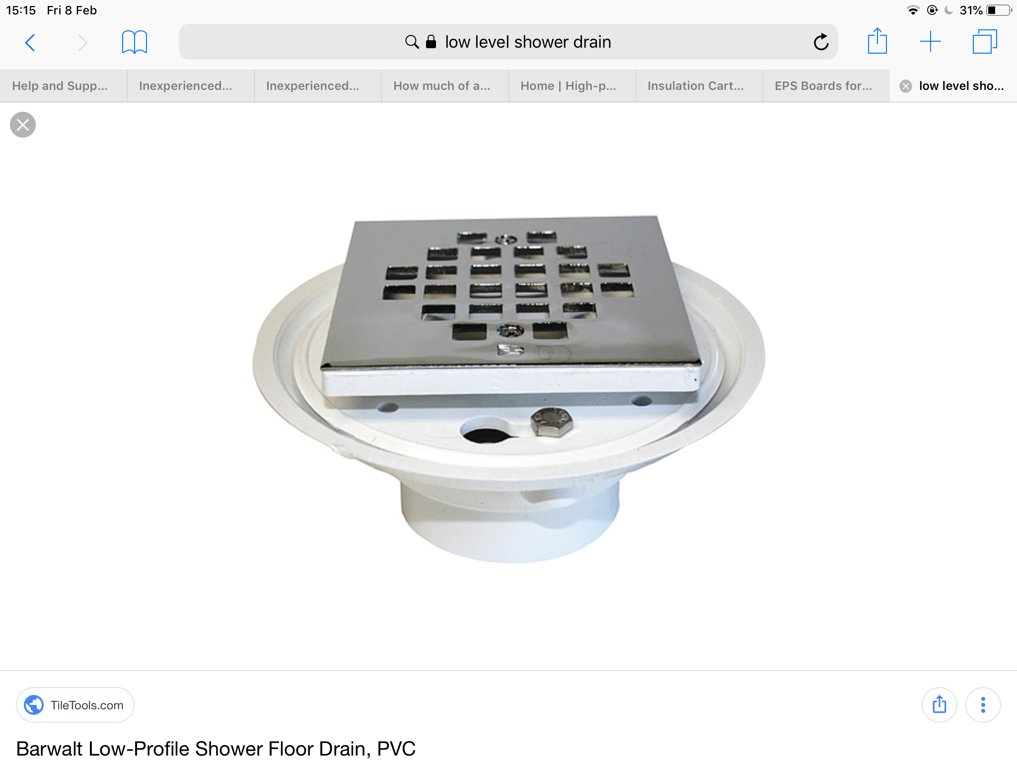

ToughButterCup Posted February 8, 2019 Author Posted February 8, 2019 1 hour ago, Carrerahill said: [...] you may at worst need to disc cut out a 300mm square around the drain pipe so you can bed a deeper drain back into the concrete but I see no major issues here. [...] I have just gone up to look at the hole in a bit more detail. Took a photo and its vanished into thin air.... There's a 300 by 300 (by at least 100mm deep) lump of polystyrene round a large diameter drain hole Whats a 1 hour ago, Russell griffiths said: [...] look at some low level grates and work back from that. [...] Might you mean a 'plug 'ol grating thingy ?
Russell griffiths Posted February 8, 2019 Posted February 8, 2019 dig all the polystyrene out and look at the pipe, you should be able to cut it lower if you need to. Choose your waste fitting. Pic just as an idea. Drop it on pipe and grab a straight edge and a spirit level go to tile shop and pick up half a dozen sample tiles get a bit of hard board or something to pretend to be your tanking adhesive and membrane if you are going to use one. Get on your old knackered knees and have a bit of a dummy up to see what falls you can get. This is all dependant on your floor finish or finish in the adjacent rooms, you may find if you put a 20mm thick timber in the bedroom then that will help you to loose any step. 1

Gone West Posted February 8, 2019 Posted February 8, 2019 59 minutes ago, recoveringacademic said: There's a 300 by 300 (by at least 100mm deep) lump of polystyrene round a large diameter drain hole I had put a block of polystyrene around the 110mm shower waste pipe in my wet room before the concrete was poured. It wasn't as big as 300mm square but big enough to allow a sufficient drop of around 20mm over 1.1m. I just had to chip a few mm off around the edge of the hole. After it was tanked I fitted a straight connector to the pipe and then a McAlpine shower trap. https://mcalpineplumbing.com/wet-room-products/tiledstone-floor-gullies/tsg2t6ssc-75mm-water-seal-gully-vertical-outlet-tiled-or-stone-floors

mvincentd Posted February 8, 2019 Posted February 8, 2019 36 minutes ago, PeterStarck said: https://mcalpineplumbing.com/wet-room-products/tiledstone-floor-gullies/tsg2t6ssc-75mm-water-seal-gully-vertical-outlet-tiled-or-stone-floors This is what i’m Planning....only needs 13mm from slab top, so if you used a liquid tray and thin tile you should sneak in (your 300sq x100 recess also allows an increased fall within this area).
