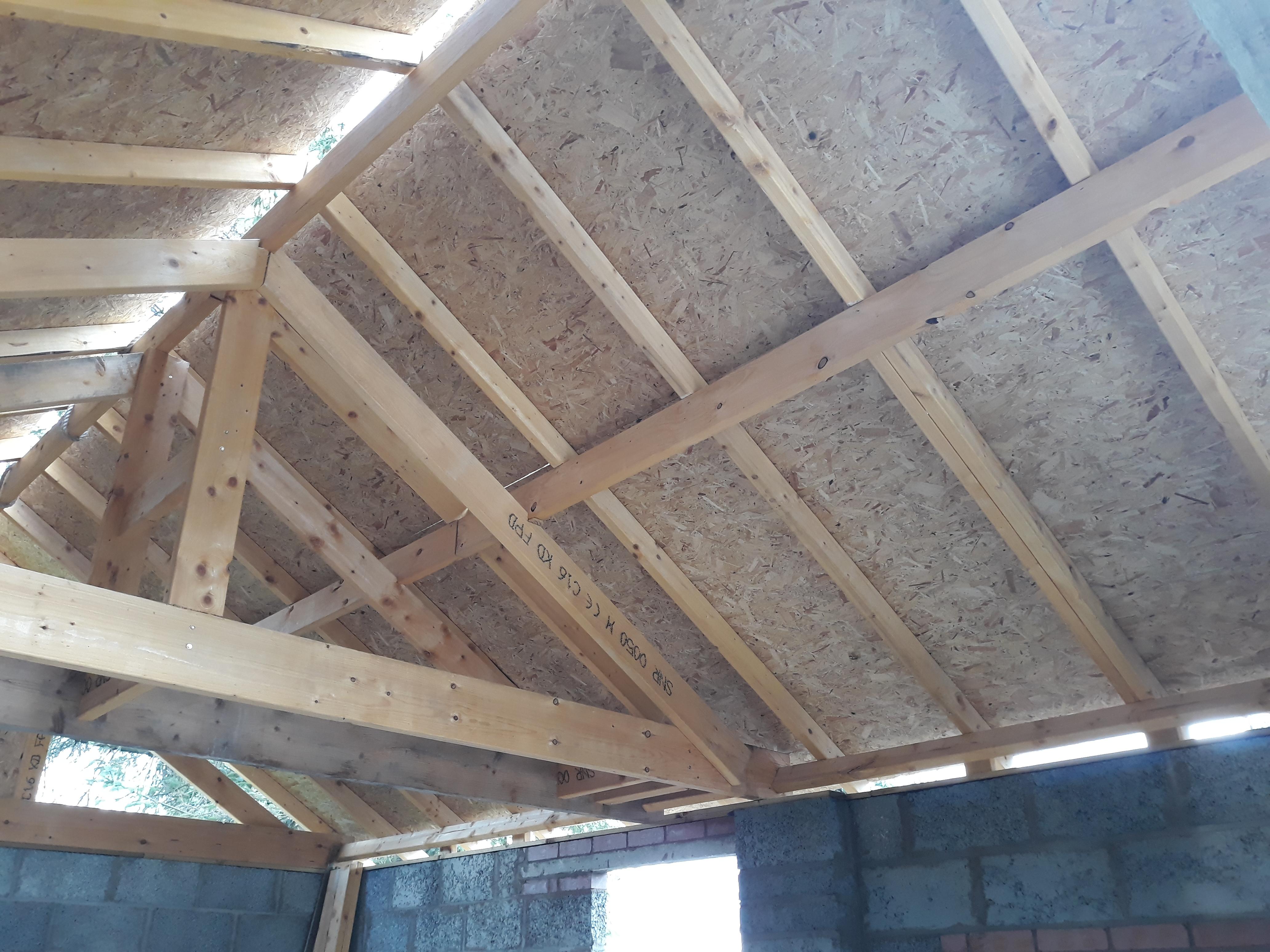

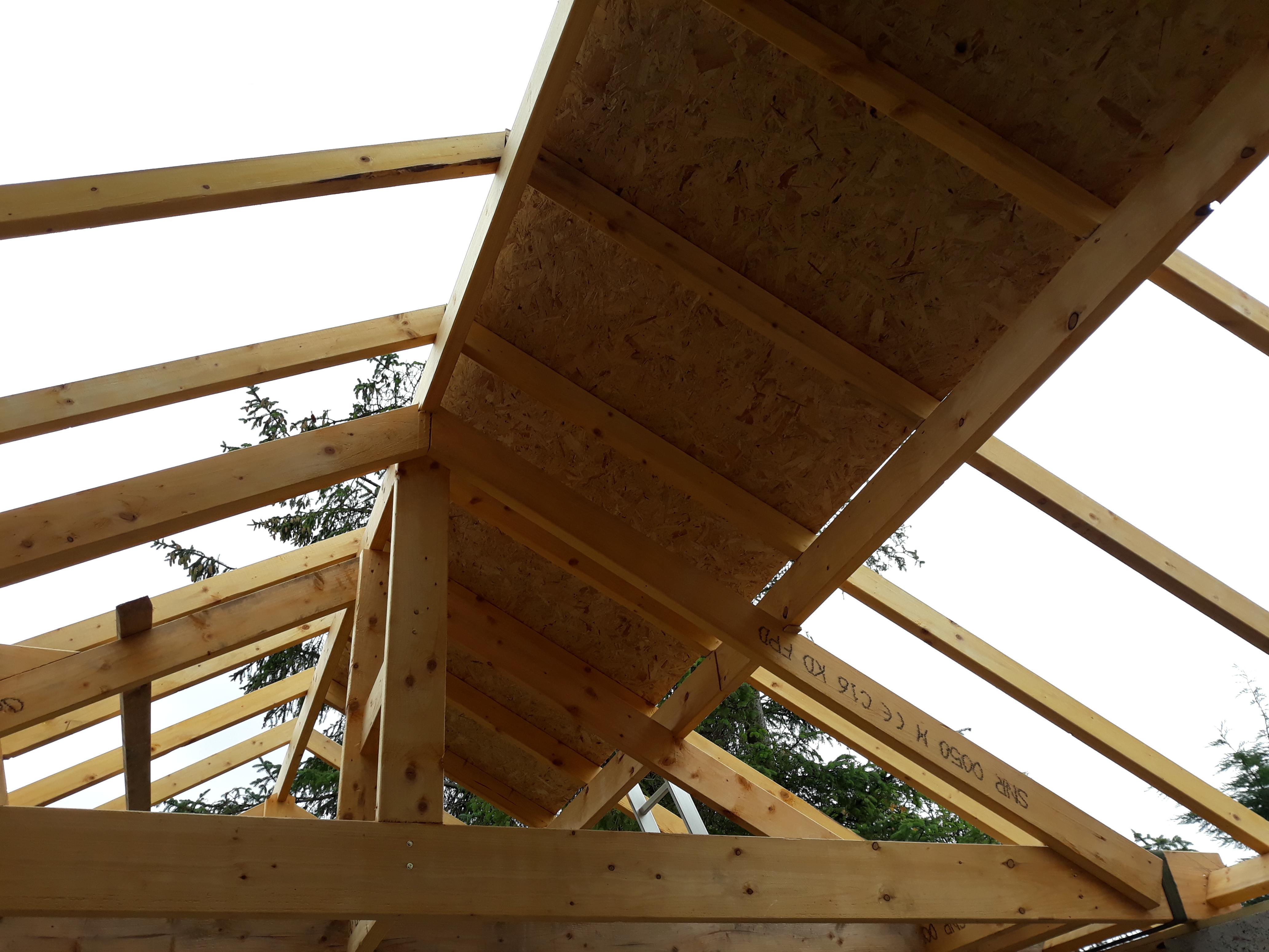

MarkyP Posted February 4, 2019 Share Posted February 4, 2019 I have OSB 3 sarking, as designed the intent was to full fill with mineral wool between 170mm deep rafters and then 70mm PIR below. This was passed at bc subsmission stage but since on site BCO has questioned condensation risk on the inside of the OSB. A VCL would if perfectly fitted address this from a CRA point of view but there is a tricky detail at eaves (this section is of the building is retrofit) and around dwarf wall uprights in the trusses which will be a fiddle to detail the VCL perfectly so perhaps not unreasonable of BCO to question whether I will 100% prevent vapour (or even air) moving from warm side into the build up. So my plan, while it will be a chore, is to drill two rows of 8mm holes @ 200mm centres through the OSB in each rafter bay and then run a strip of air tightness tape over each row to prevent wind washing of my insulation once fitted as the OSB was all carefully taped to be wind tight. Above the OSB is a ventilated counter batten void, breather, then batten/slate. I need to double check the tape of choice to ensure sufficiently vapour permeable. Have yet to discuss with BC but think this will address concerns. Link to comment Share on other sites More sharing options...
Cpd Posted February 4, 2019 Share Posted February 4, 2019 34 minutes ago, MarkyP said: So my plan, while it will be a chore, is to drill two rows of 8mm holes @ 200mm centres through the OSB in each rafter bay and then run a strip of air tightness tape over each row to prevent wind washing of my insulation once fitted as the OSB was all carefully taped to be wind tight. Sorry but I am a bit lost here, (happens quirte a lot...) if you drill a row of holes through the osb and then tape over them with air tight tape....... won’t that be a complete waste of time as you have just sealed it back up again........ sure I am just reading this wrong..... I am in a similar dilemma as I build my shed roof out of floor grade ply........ what a baboon I was to move away from traditional 22x150mm white wood sarking.... I was pretty ill at the time and was not in full control of this part of the project .... it’s still my fault but hay ho. I now have a surface that is not nearly breathable enough and am getting condensation build up and black mould. My plan is to take the tin off and the breather membrane that was damaged in the frost and cut some big old holes along the length of the roof top and bottom through the ply and then put new membrane on and re tin........ it was a stupid mistake..... but I was only functioning at about 20% on a good day when it was going on...... Link to comment Share on other sites More sharing options...
MarkyP Posted February 4, 2019 Share Posted February 4, 2019 yes this why I said I will need to double check choice of tape. If the tape isn't sufficiently vapour open then this would indeed will be a waste of time. My aim is to improve the vapour permeability of the OSB with a series of air tight but vapour open holes. Link to comment Share on other sites More sharing options...
Carrerahill Posted February 4, 2019 Share Posted February 4, 2019 What you are looking for is standard practice in Scotland, I have never seen a roof in Scotland without boarding (sarking) on it, well once by a major house builder building cheaply. This is just my garage and it's fully boarded! Link to comment Share on other sites More sharing options...

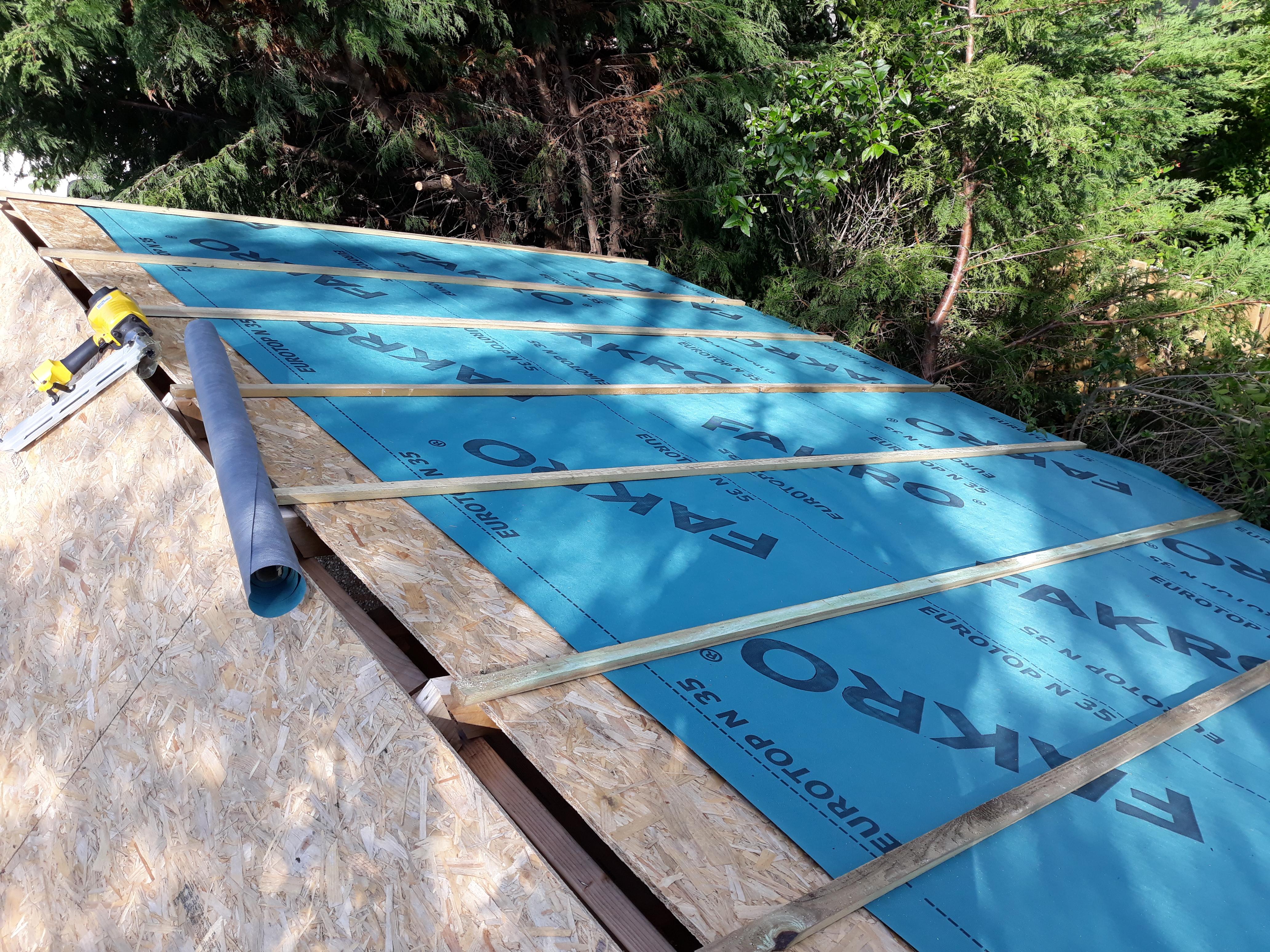

Russell griffiths Posted February 4, 2019 Share Posted February 4, 2019 The holes in the osb that scanda hause use are about the size of a 2p why not fit your membrane directly onto the osb with holes then counter batten. No wind washing then. Link to comment Share on other sites More sharing options...
Cpd Posted February 4, 2019 Share Posted February 4, 2019 2 hours ago, Russell griffiths said: why not fit your membrane directly onto the osb with holes then counter batten. That’s what I intend to do, cut me a bunch of holes, new membrane over the lot and put the tin back on. Link to comment Share on other sites More sharing options...
