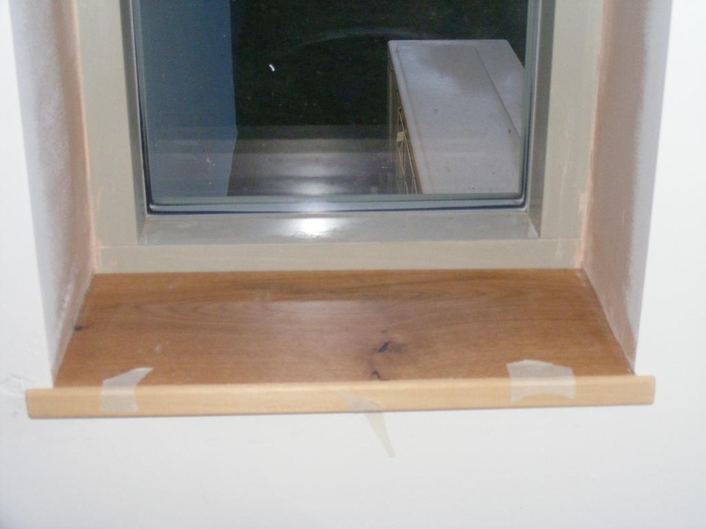

ProDave Posted December 12, 2018 Share Posted December 12, 2018 Trying to work out how to do them. In the previous house we bought softwood window boards and they were very disappointing, warped like mad etc. So this time we want something better. We have oak floors and would like something similar for the window boards. I tried all the timber merchants I knew and none seemed to offer anything. So in an idle moment, tidying up after finishing the floor I cam up with this idea and post it here for you to either tell me how rubbish it is, or praise it, or recommend improvements. The Oak flooring is engineered board so 3 layers with oak as the top layer. That should hopefully mean it is not inclined to warp. It just happens that each floor plank is just a little wider than the window reveal depth so easy to plane to the depth needed. But of course the edge, being a 3 layer engineered wood, is too rubbish to leave as the finished edge. So I have mocked up this on the smallest window: The trim along the front is pine and not treated yet. That is all I could get locally in a BM. If I go ahead with this I would hope I could get similar trim in oak from a timber merchant, or failing that experiment staining it to at least look closer to the oak board. What does the forum think of this idea? SWMBO thinks it's okay but wants a more appropriate bit of trim. Link to comment Share on other sites More sharing options...

ProDave Posted December 12, 2018 Author Share Posted December 12, 2018 Nothing else is decided. We have oak floor, oak kitchen worktop and will have oak doors. So logically want oak door liners (that one is not going to be fun finding them) and oak architrave and skirting (easy, Howdens sell oak veneer of both) Link to comment Share on other sites More sharing options...
Mr Punter Posted December 12, 2018 Share Posted December 12, 2018 You can get oak stair nosing with a groove at the back but I don't know if it would fit with your floor. 1 Link to comment Share on other sites More sharing options...
joe90 Posted December 12, 2018 Share Posted December 12, 2018 10 minutes ago, ProDave said: So logically want oak door liners I had this decision to make but after seeing pictures (on here?) of oak doors with painted skirting/architrave found it looked good. I like your cill idea, I would have biscuit joined the facing piece myself but think pine won’t look good unless you have pine elsewhere. Personally you can never stain pine to look like oak (but I am OCD according to er indoors). You would IMO be better off having lengths of pine machined by a local firm then trim to length and stick them on. I am making oak calls fir my oak sunspace and using 18mm oak faced ply and biscuit joining a bull nose to the front. Link to comment Share on other sites More sharing options...
Square Feet Posted December 12, 2018 Share Posted December 12, 2018 I think it looks good. Link to comment Share on other sites More sharing options...
Redoctober Posted December 12, 2018 Share Posted December 12, 2018 Plus one to that. You should be able to source oak trims from a BM. If your budget can stretch have a look at the UK Oak Doors website. We got our oak Cills and boards from them. Link to comment Share on other sites More sharing options...
Simplysimon Posted December 12, 2018 Share Posted December 12, 2018 @ProDave back the flooring onto a piece of mdf/ply and mitre the front edge, a piece of solid oak mitred and fixed to give the edge. as for the standards, where the door is, rebate slightly more depth than the thickness of the door and beyond the margin for facing, fill with oak. alternatively, if fitting planted stops then a full oak facing slightly more than the depth of the margin. 1 Link to comment Share on other sites More sharing options...

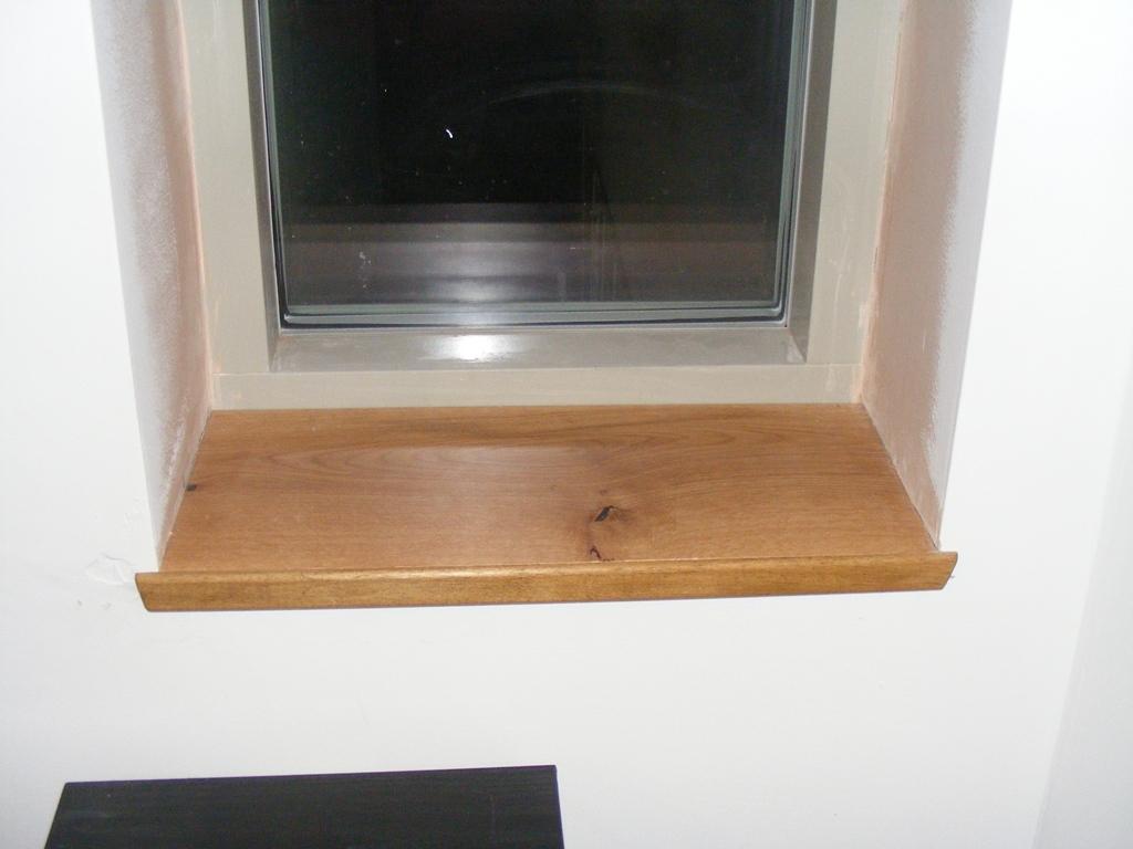

ProDave Posted December 13, 2018 Author Share Posted December 13, 2018 I found a donkeys years old pot of "Dark Oak" wood stain in the garage. Gave the trim the very thinnest possible coat of that so as not to be too dark, followed by a coat of clear varnish. I think this is acceptable: Link to comment Share on other sites More sharing options...
Redoctober Posted December 13, 2018 Share Posted December 13, 2018 Tidy job there ? Link to comment Share on other sites More sharing options...
CC45 Posted December 13, 2018 Share Posted December 13, 2018 yep, looks good. Link to comment Share on other sites More sharing options...
newhome Posted December 13, 2018 Share Posted December 13, 2018 Pity you're not closer. I have a ton of oak bits and bobs left over from the build. I actually burnt some of it in the summer ? Link to comment Share on other sites More sharing options...
joe90 Posted December 13, 2018 Share Posted December 13, 2018 I am impressed with the colour match, so much for me saying otherwise, well done ? Link to comment Share on other sites More sharing options...

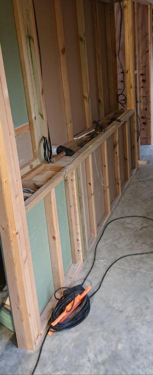

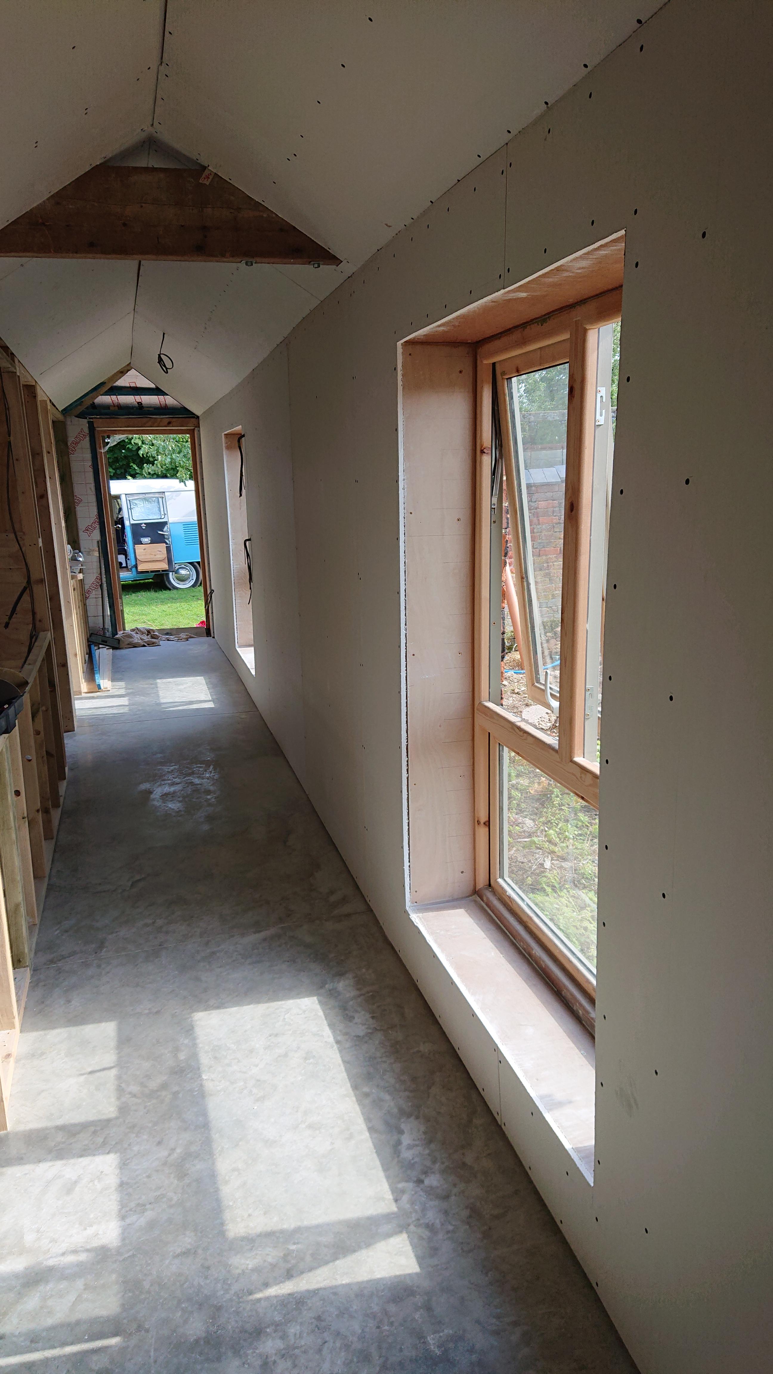

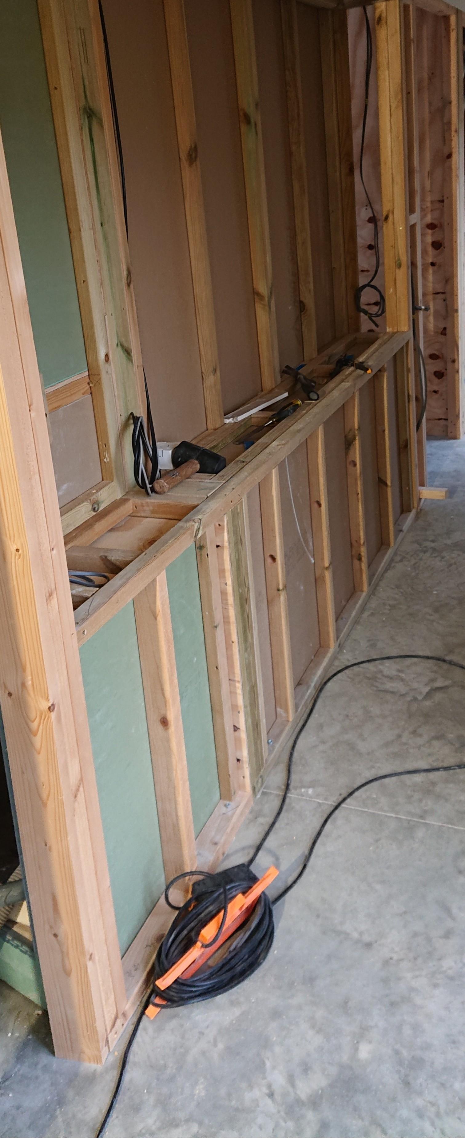

Jenni Posted March 23, 2021 Share Posted March 23, 2021 (edited) Thank you both for tips so far. I do have access to a rail saw, as you say its an excellent bit of kit. I thought a couple of pics might help. The windows already have a base ply on them so good support for oak faced to go on top of. The shelf has a fair amount of timber to support it, I was thinking I may plasterboard it first then put the oak faced ply on top. Edited March 23, 2021 by Jenni Link to comment Share on other sites More sharing options...
jack Posted March 23, 2021 Share Posted March 23, 2021 10 minutes ago, Jenni said: The shelf has a fair amount of timber to support it, I was thinking I may plasterboard it first then put the oak faced ply on top. Oh, that'll be fine. I assumed that you were talking about a shelf sticking out from a wall, rather than one supported from underneath like this. 1 Link to comment Share on other sites More sharing options...
Jenni Posted March 25, 2021 Share Posted March 25, 2021 Thank you. Do you think thinner ply would be ok, say 12mm, given that there's already (I think) pretty good support there? Will plaster skim run flush to the ply work ok? I'm a bit worried it's will end up a flaking away and looking a mess. Any suggestions for fixing the ply to the existing ply on window sillls, and to plasterboard? Link to comment Share on other sites More sharing options...
jack Posted March 25, 2021 Share Posted March 25, 2021 1 minute ago, Jenni said: Thank you. Do you think thinner ply would be ok, say 12mm, given that there's already (I think) pretty good support there? Will plaster skim run flush to the ply work ok? I'm a bit worried it's will end up a flaking away and looking a mess. Any suggestions for fixing the ply to the existing ply on window sillls, and to plasterboard? I think you'd get away with 12mm given how well-supported it is. Re plastering up to it, you could perhaps put a stop for the plasterer to skim up to then install the plywood and caulk the remaining gap. I'm sure a couple of people on here have done that when skimming up to windows and door frames. Not sure about fixing. Glue would work, although it'll be a devil to get off of you ever want to replace it. Perhaps just use a minimal amount? Link to comment Share on other sites More sharing options...
