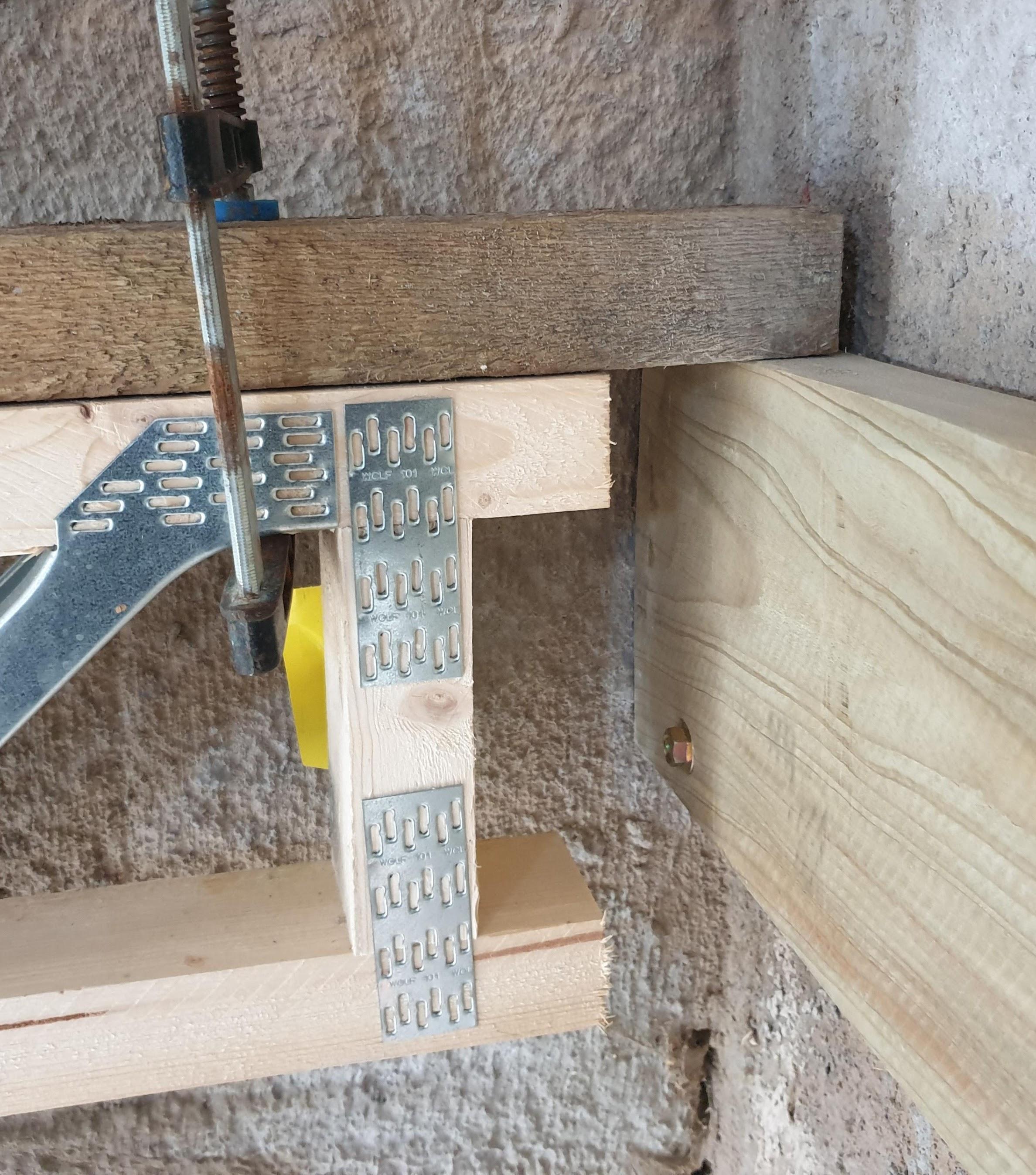

ToughButterCup Posted November 26, 2018 Share Posted November 26, 2018 If I cant take a joke, I shouldn't have started should I? So, folks, what I can I do about that then? Booked a call from the BCO, architect sucking his teeth, suppliers humming and haa-ing. 1 Link to comment Share on other sites More sharing options...
PeterW Posted November 26, 2018 Share Posted November 26, 2018 Whats the span and what goes on top ..? Just a flat roof ..?? Link to comment Share on other sites More sharing options...
ToughButterCup Posted November 26, 2018 Author Share Posted November 26, 2018 The span at that point is 3646, and the joist supports the first floor. Link to comment Share on other sites More sharing options...

Gav_P Posted November 26, 2018 Share Posted November 26, 2018 Can you double up on the wall mounted joist thingy? Link to comment Share on other sites More sharing options...
Gav_P Posted November 26, 2018 Share Posted November 26, 2018 Just now, Gav_P said: Can you double up on the wall mounted joist thingy? Or replace it with a thicker one? Link to comment Share on other sites More sharing options...
Barney12 Posted November 26, 2018 Share Posted November 26, 2018 3 Link to comment Share on other sites More sharing options...
Mr Punter Posted November 26, 2018 Share Posted November 26, 2018 How many joists? If you are at fault, can they be used elsewhere with modification or did you get all the joists for the project? Link to comment Share on other sites More sharing options...
jamiehamy Posted November 26, 2018 Share Posted November 26, 2018 Is that the gap at both ends or one? Could get a Rolled Steel Angle fabricated and coach bolted into the timber? Would ensure the down force is almost unchanged rather than bolting in timbers which I doubt would be acceptable. Link to comment Share on other sites More sharing options...
ToughButterCup Posted November 26, 2018 Author Share Posted November 26, 2018 26 minutes ago, ProDave said: Embarrassing question time: WHO got the measurement wrong on the order? Surprisingly, not me. The supplier's rep was quite open and frank about it: he's even been honest enough to transfer my annotation ( 'This dimension is the internal wall dimension, not taking into account the 50mm timber bearer' ) on his initial plan. BCO pointed out that since there are no POSI Joist guidelines equivalent to the TRADA ones, he can't advise on whether its possible to compensate for the error. Looks like the suppliers will need to replace them. Pity - it'll be costly. Link to comment Share on other sites More sharing options...
ToughButterCup Posted November 26, 2018 Author Share Posted November 26, 2018 9 minutes ago, Mr Punter said: How many joists? If you are at fault, can they be used elsewhere with modification or did you get all the joists for the project? 55 or so. Every one exactly 100mm short. Link to comment Share on other sites More sharing options...
Onoff Posted November 26, 2018 Share Posted November 26, 2018 Build another wall? Link to comment Share on other sites More sharing options...
Mr Punter Posted November 26, 2018 Share Posted November 26, 2018 How are these supported - top chord on the top of the wall plate or joist hanger or what? Just that the wall plate does not look as deep as joist. Link to comment Share on other sites More sharing options...

Russell griffiths Posted November 26, 2018 Share Posted November 26, 2018 Is that a photo angle thing, is the pole plate the same depth as the joist. Link to comment Share on other sites More sharing options...
joe90 Posted November 26, 2018 Share Posted November 26, 2018 Glad it wasn’t you Ian, let the supplier sort it and explain it’s urgent and holding up work. I once worked on a loft conversion for a friend and we were installed an RSJ in the ridge, crane arrived, road blocked, steel lifted ........and that was 100mm short, friend forgot to add 100mm EACH end, very embarrassing for him and costly ? Link to comment Share on other sites More sharing options...
ToughButterCup Posted November 26, 2018 Author Share Posted November 26, 2018 24 minutes ago, Russell griffiths said: Is that a photo angle thing, is the pole plate the same depth as the joist. Yes, Russell, I think it is a (photographic) 'angle thing' . I'm not sure what a pole plate is, but the POSI joist is a good few ml lower than the wall plate (sometimes called rim joist). So the bottom chord of the POSI is 'free' - to the extent that the joist hangers will allow it to swing. Link to comment Share on other sites More sharing options...

Tennentslager Posted November 26, 2018 Share Posted November 26, 2018 (edited) Swap the wall plate for one 50mm thicker each side...they pay. Maybe...? Edited November 26, 2018 by Tennentslager 1 Link to comment Share on other sites More sharing options...
