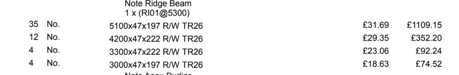

Thedreamer Posted November 11, 2018 Posted November 11, 2018 I've just got your standard old fashion joists. I have attic trusses at the gable end and for a centre middle section I order the rafters and joists from the truss fabricator as well. Our plans showed C16 but I went for truss grade for the centre joists/rafters. If it helps this was the cost of this timber. Not having MHVR but plan to install a joules aero, so shouldn't have to many large holes.

Patrick Posted November 16, 2018 Author Posted November 16, 2018 (edited) On 11/11/2018 at 20:38, Thedreamer said: I've just got your standard old fashion joists. I have attic trusses at the gable end and for a centre middle section I order the rafters and joists from the truss fabricator as well. Our plans showed C16 but I went for truss grade for the centre joists/rafters. If it helps this was the cost of this timber. Not having MHVR but plan to install a joules aero, so shouldn't have to many large holes. Seems expensive. For regular beams. Edited January 28, 2020 by Patrick Confidential information 1
