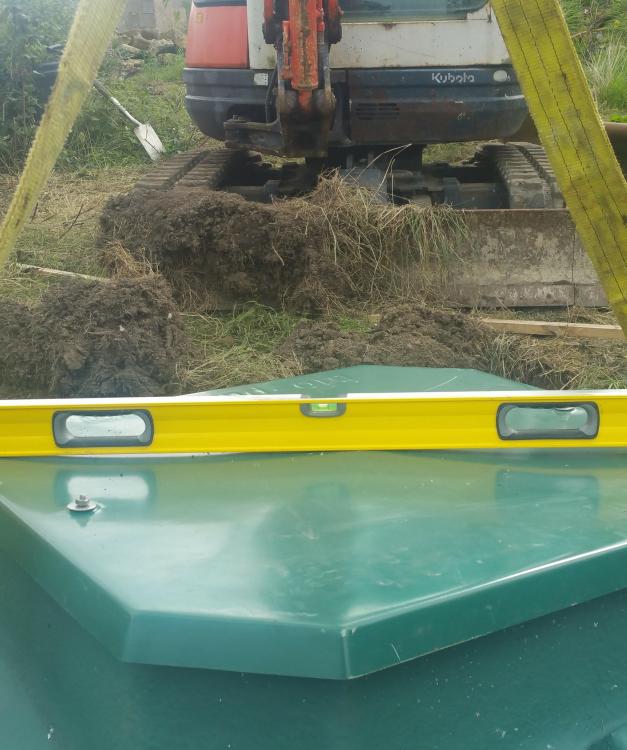

There wuz I Digging this 'ole .....
Well, actually, I have been avoiding it. Doing a Big Time @Onoff. Procrastinating  a treat.
This needs to go in the green space next to it.
I have the guidance on how to do it. Here
There's a couple of things that are making me eat too much chocolate today.
  • The empty weight is only 125 kg: an easy job for my digger  - But will the arm have the reach?
  • The hole only needs to be 2.25 meters deep - But the sides of the hole won't be vertical so will the arm have the reach (to dig out the middle of the hole)?
Which all comes down to do I hire a 5 tonner ? (Mines 2.6 tonnes)

Going by that link your hole is under 2m wide so your digger will be plenty able.
Why would you not be digging the sides vertical???

The answer is to dig down 300/400 mm beside the hole to create a hole for the digger to sit in
nice level base track the digger into the lower shelf sit there to complete the lowest dig.
I have seen the level piling matt you made, I don’t know why your worried ???
crack on son.

Yer a star Russel.
Piling matt? Yeah, with a 16 tonner. Oh, bliss, sheer bliss - proportional controls, a full-on sound system, pedal track controls,  steel tracks ?
Why am I worried?
Because the more experienced I get, the more cautious I get but the more ambitious I get.

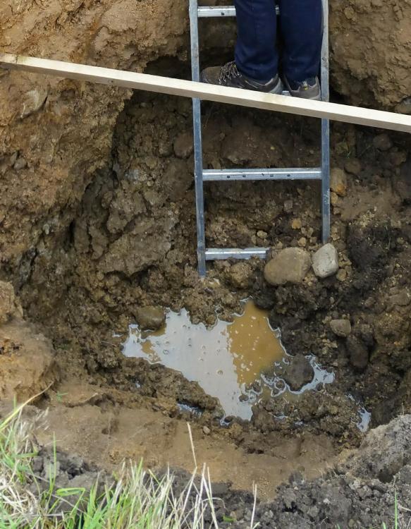

Do you have a high water table
Partly deliberately delayed 'til now because the water table will be as low as it ever gets this week, (I hope)

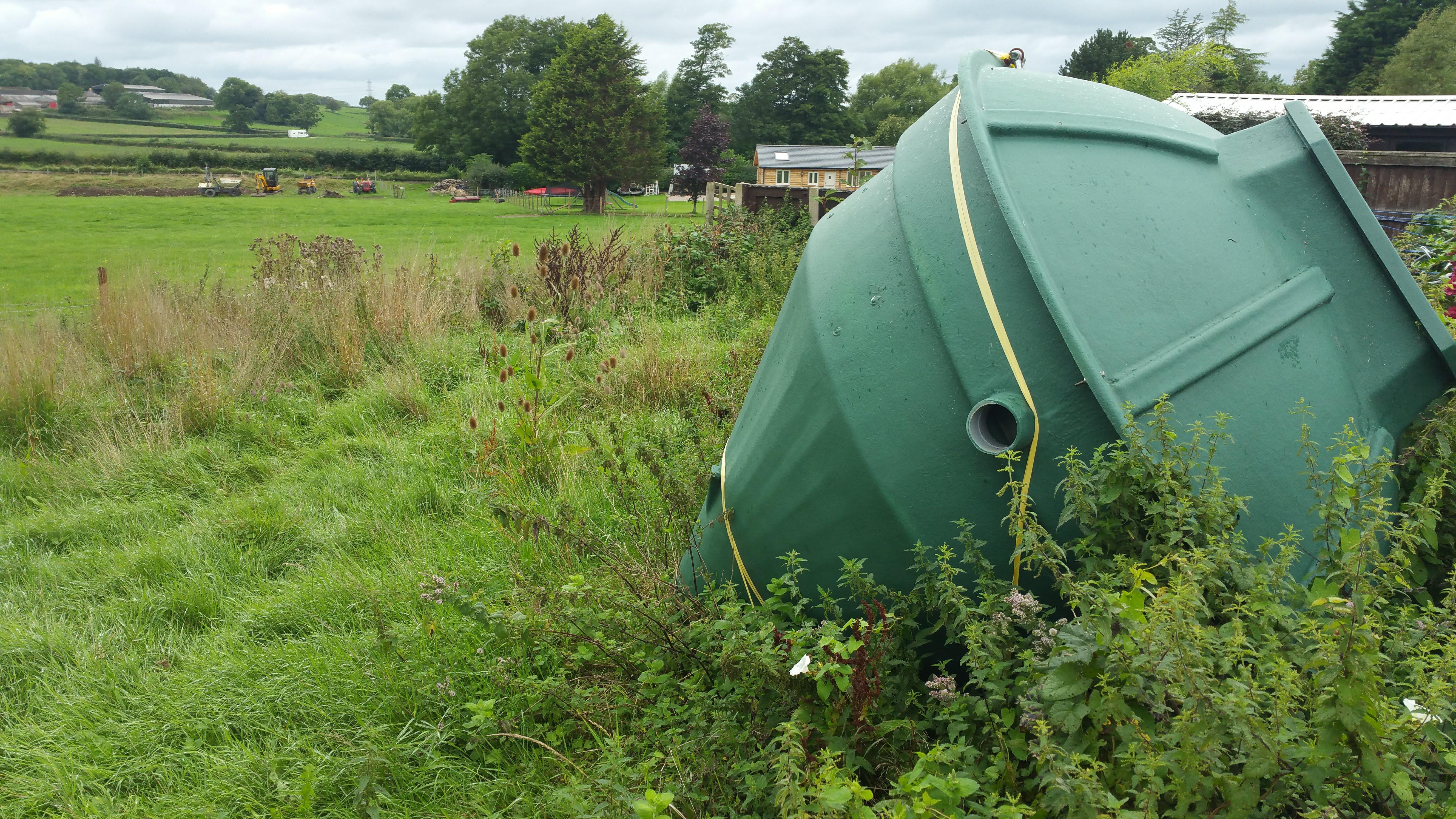

Our guys dug a stepped hole for our conical tank.  Looked easier to dig to me, plus it allowed them to pour concrete around the bottom to  secure the tank in place (it's held down by those wedge-shaped projections at the bottom of the cone - they lock into the concrete ring poured around the base).

You don't need the ground anchor kit with that tank if using concrete.  Those wedges around the base key into the concrete ring you pour around the base and hold it down.
Our tank was pretty much exactly the same, and is set below the water table, so we anchored it down using concrete, as it looked a better bet that using their ground anchor kit, which was a galvanised angle cross plus some galvanised chains, IIRC.  Concrete just seemed easier, as we had a mixer on site.
One tip, if using concrete, then make a chute down the side of the hole, just dug out of the ground, so that it's easier to get the concrete right to the bottom with the water filled tank in place.

Your digger is about the same size if not larger than what I had, it will do the job no problem.
I was almost at full reach down into the hole by the time I got deep enough but could easily have dug a little ledge for the digger to go down onto if I had needed to go deeper
There wasn't much headroom to lift it so just a short bit of rope
The ONE thing I would do differently if preparing to do it again, is get a HOOK to hang from the bucket.  I think it took 3 tries of lowering it in, no it;s not deep enough, take it out and dig a bit more, and that was a right PITA having to undo shackles. A HOOK would have made it a lot easier.

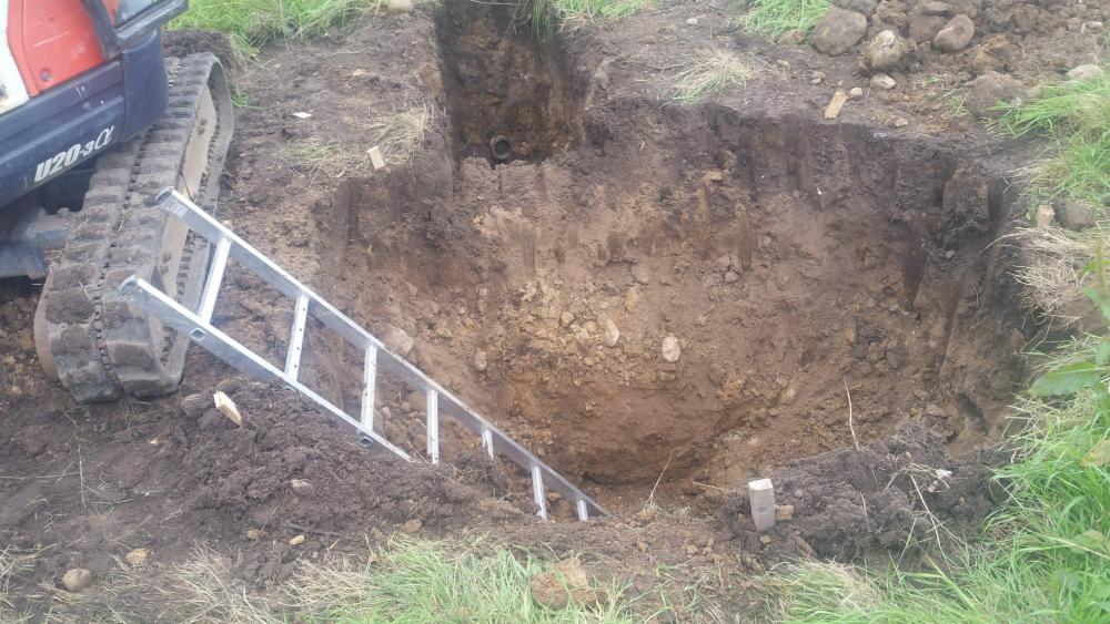

I dug a tapered hole.  Less likely for the sides to cave in, and less concrete to fill it. The plant is after all a cone shape so why dig a cylinder shape hole for it?
In my case it was concreted in up to the ring around the bottom as the anchor to prevent it floating out.
You don't necessarily need to concrete the tank into the hole, you can fill the tank with water as you backfill around it with selected backfill. The weight of the water in the tank keeps it down!

Some good points made about the need to concrete the tank in place. So to recap......
Concrete the tank in place if you have high groundwater.
If you have low or no groundwater then you can simply backfill around the tank with selected backfill material.
its good practice to fill the new tank with water as you start to backfill,  it helps weight the tank down, even when using concrete as the backfill material.
I’ve worked on s couple of jobs where the lads have been rushing at the end of a day, placed the concrete late in the afternoon, not added the water and left site, only to come back in the morning to find that heavy rain overnight has flooded the excavation and the tanks is sat there floating above the concrete
Folks, quick question: how do you define a high water table?  How high, relative to a 3 meter deep hole, is a high water table?
I'd say that if you dig a hole 3 metres deep and you get water flowing into it from the ground at this time of the year, then you need to consider that you may get enough water around the installed tank to float it out of the ground when it's just been emptied and there's been a period of heavy rain for a few weeks.
In our case our hole filled to about 1/4 of it's depth overnight, in very hot, dry, weather, which was enough to cause me concern and choose to fill it with concrete.
