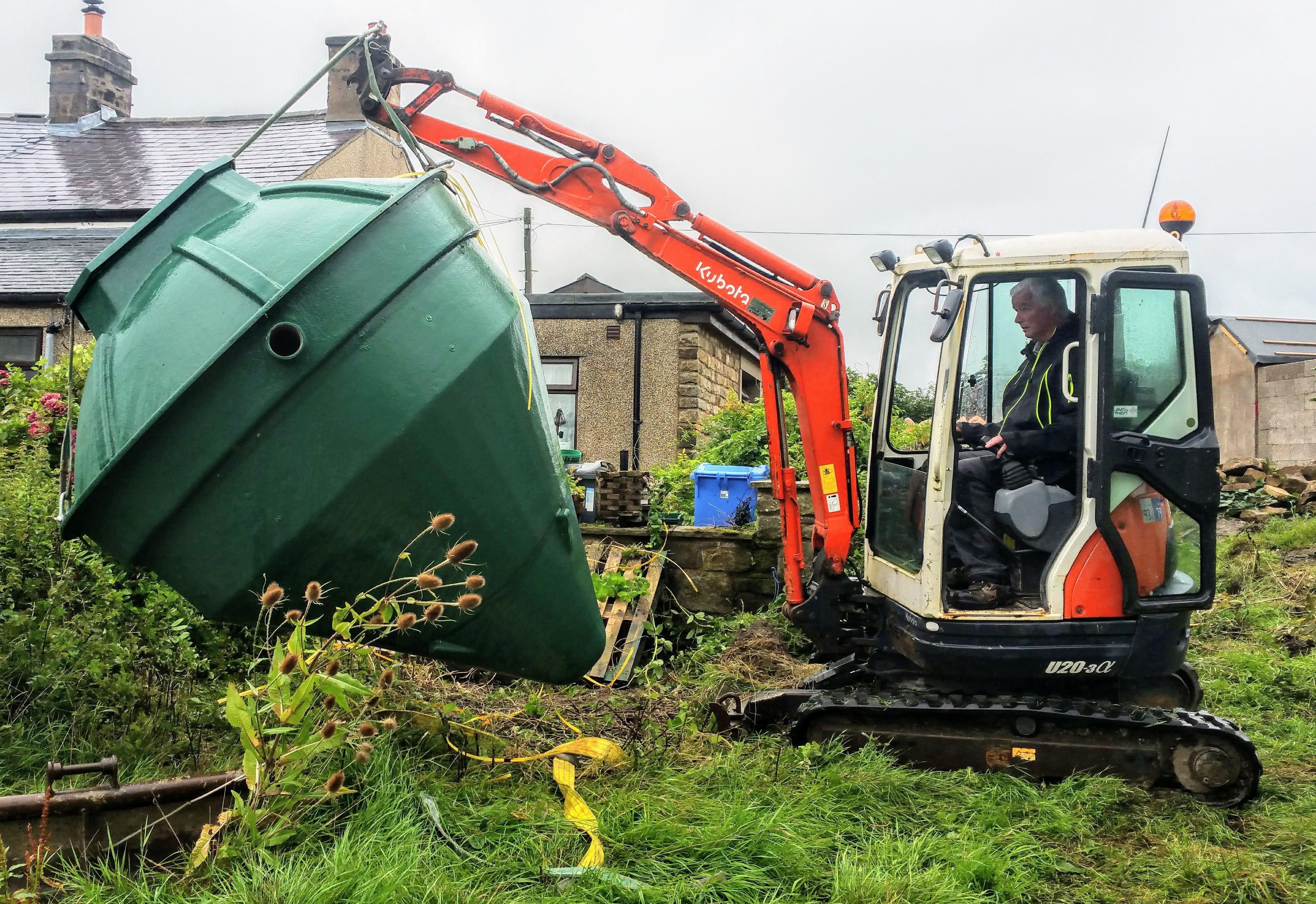

Right then, off to have a coffee and take some piccies and then get stage 1 done..... just need to check if the digger really will lift the tank. Its not the weight that's the issue: its the vertical reach.
Posted

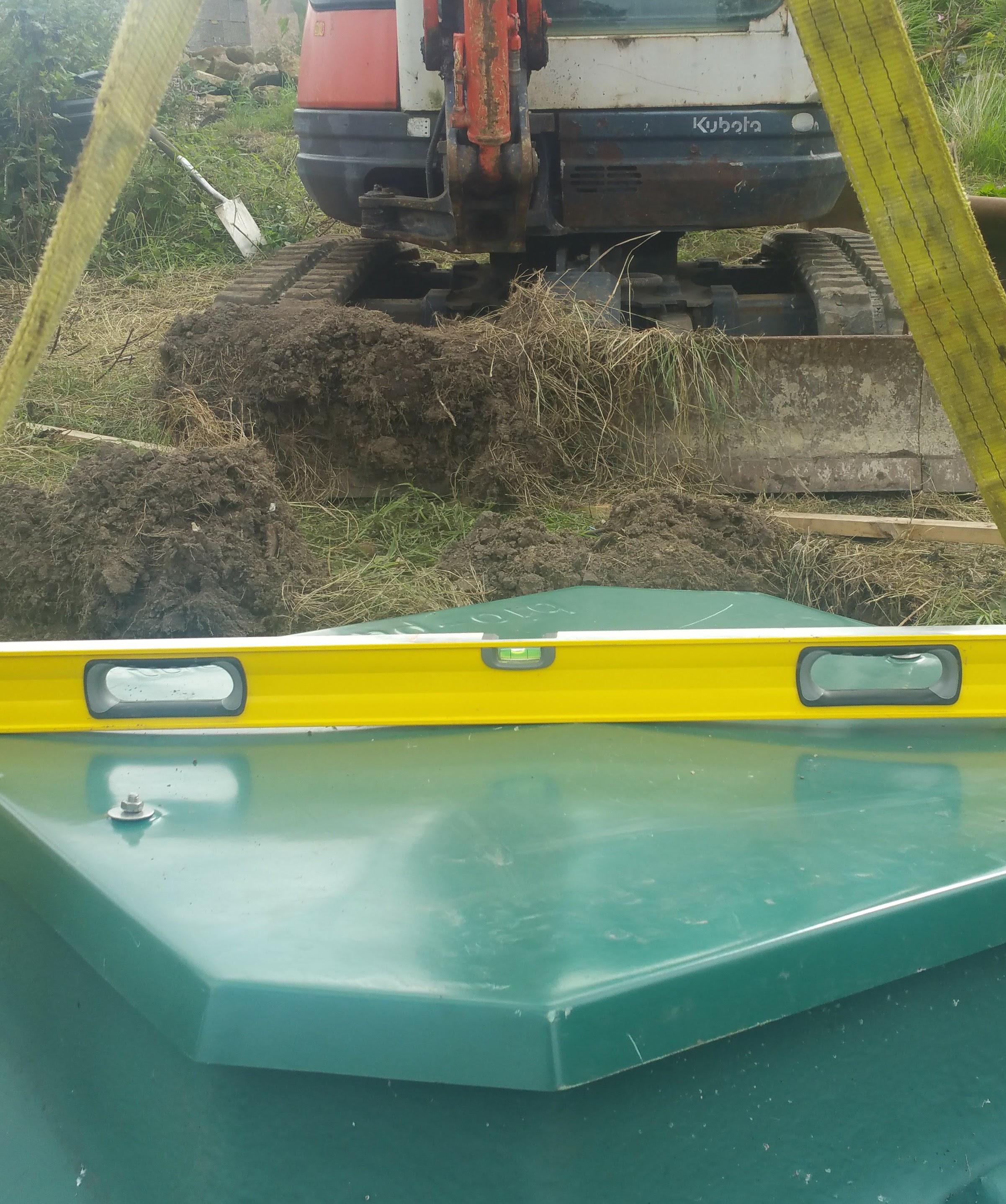

Will the digger lift the tank - weight's not an issue (250Kg) : but in terms of reach?
Yo Sushi!
With 300 mm to spare.  I am officially pleased

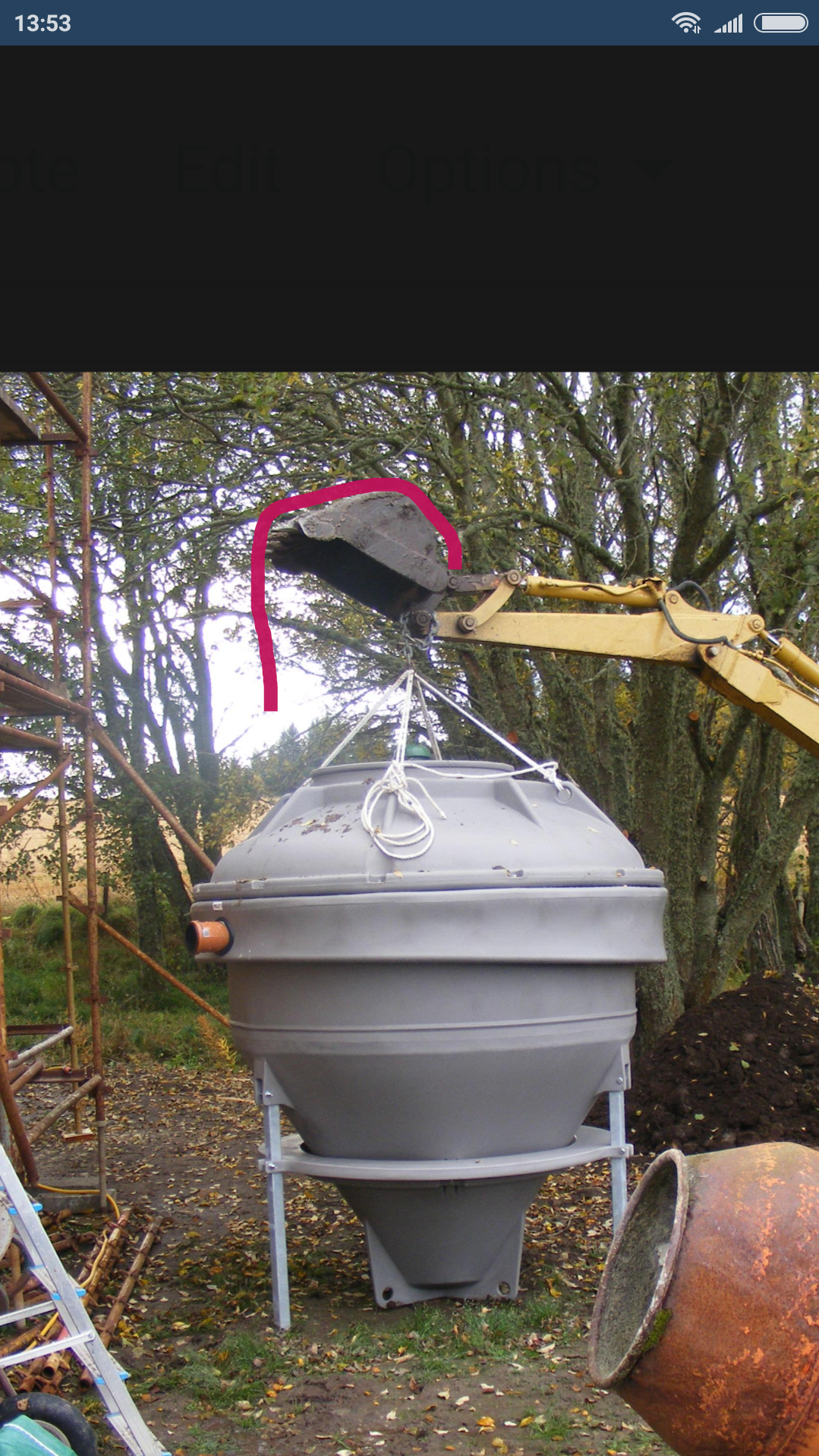

Can you not try it with your small bucket so when you open it out it will give you another 2ft of reach plus shortens the sling lifting it up higher.
Posted
I lifted with the bucket on.
If you lower it into the hole, and it's not quite deep enough, you don't want to be faffing about putting the bucket back before you can dig further. (even when you have the luxury of a quick hitch)

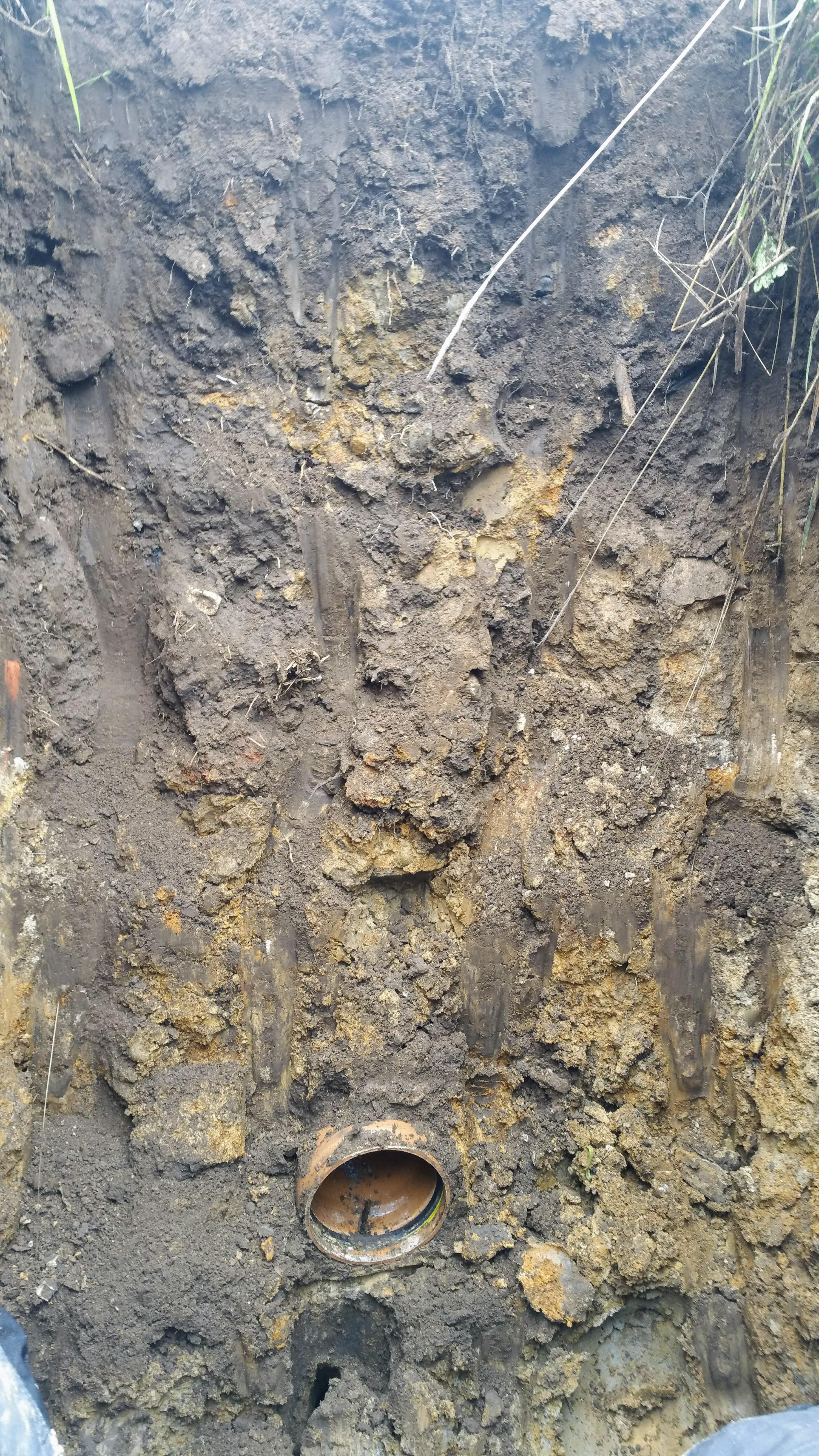

And here it is, much deeper than I thought..... about 1500mm down.
Yes, @Declan52, I'll leave the bucket on tomorrow: the back of the bucket acts as a cam.  Hadn't thought of that.

The pipe in the picture is the post-treatment discharge ' line ' , i.e. the final trickle to the stream some 150 yards away.
To save us going all the way to the discharge point, I'm putting in a manhole so we can sample the treated discharge.
@ProDave
I am trying to work out the exact centre of the hole that I should dig for the treatment unit. To do that, I need to work out where to put the sample chamber. The position of the  post-treatment pipe is a given: about 1500mm down.
So the vertical gap between the tank invert  (700ml -ish) and the post-treatment discharge line needs to be  '' bridged'  with a manhole.
My question is; horizontally, how far away from the treatment unit  do I put the manhole- (sample chamber). I ask because I know there is a rule about putting treatment tanks at least 7 meters away from a dwelling. I don't want to have to nudge the treatment unit any closer to the house than I have to.

If you want to put your treatment plant at 7m away then do that, the discharge pipe and sampling chamber can be placed on the far side by cutting back the pipe you have already buried
just cut it back to suit your needs.
Its the inlet side that is important you get the right height.

Our guys had a special tooth with a bloody great shackle welded to it that they bolted on when needing to lift stuff.  I doubt it had been anywhere near a lifting gear test or certificate, but having the load attachment right out at the end of the bucket did seem to give a give a fair bit more manoeuvrability with the load.

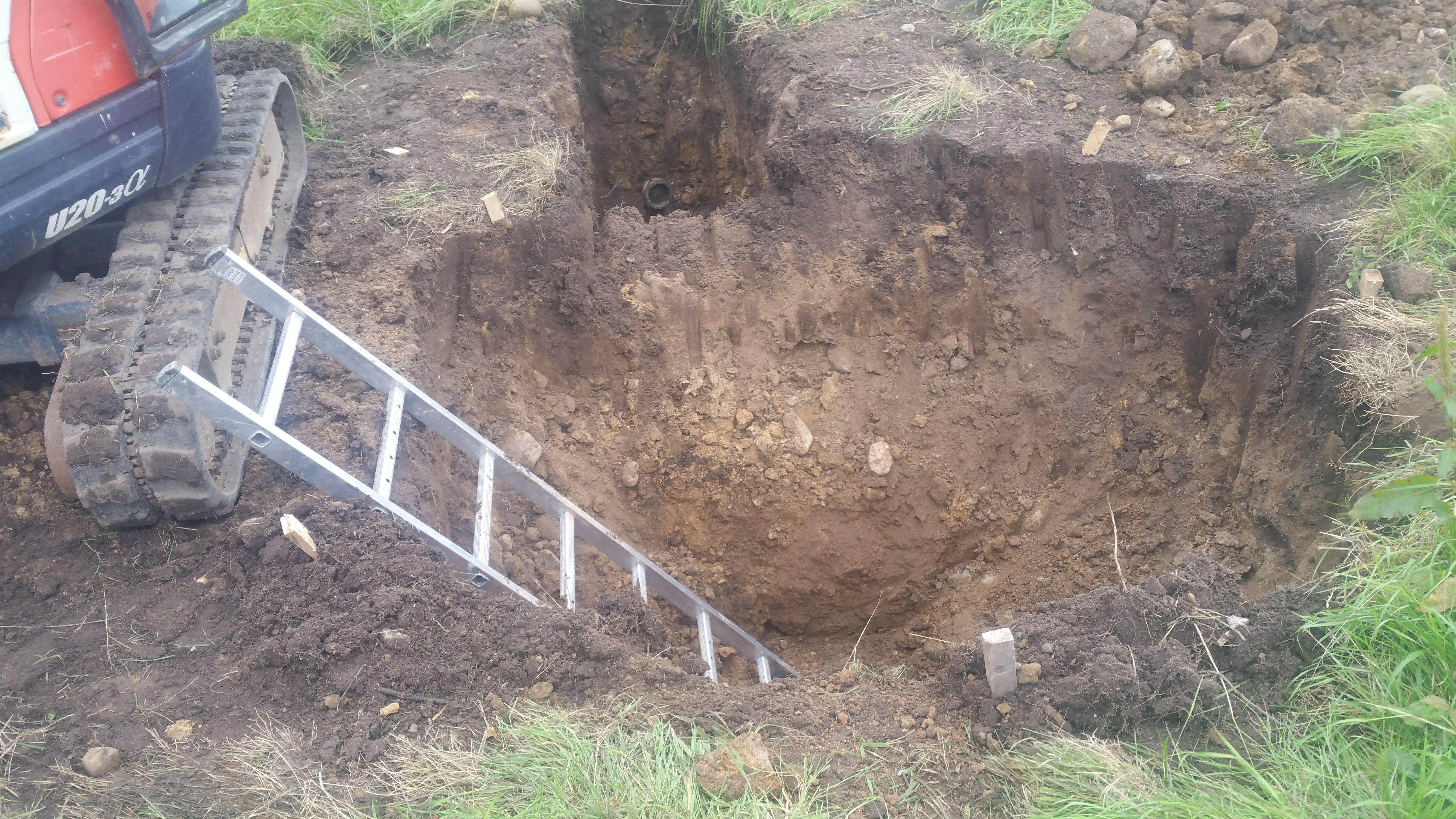

The clay was dusty: and in today's brisk wind, I almost needed eye protection.
So now....
Tomorrow tarting the hole up and popping it in. That should be a laugh.

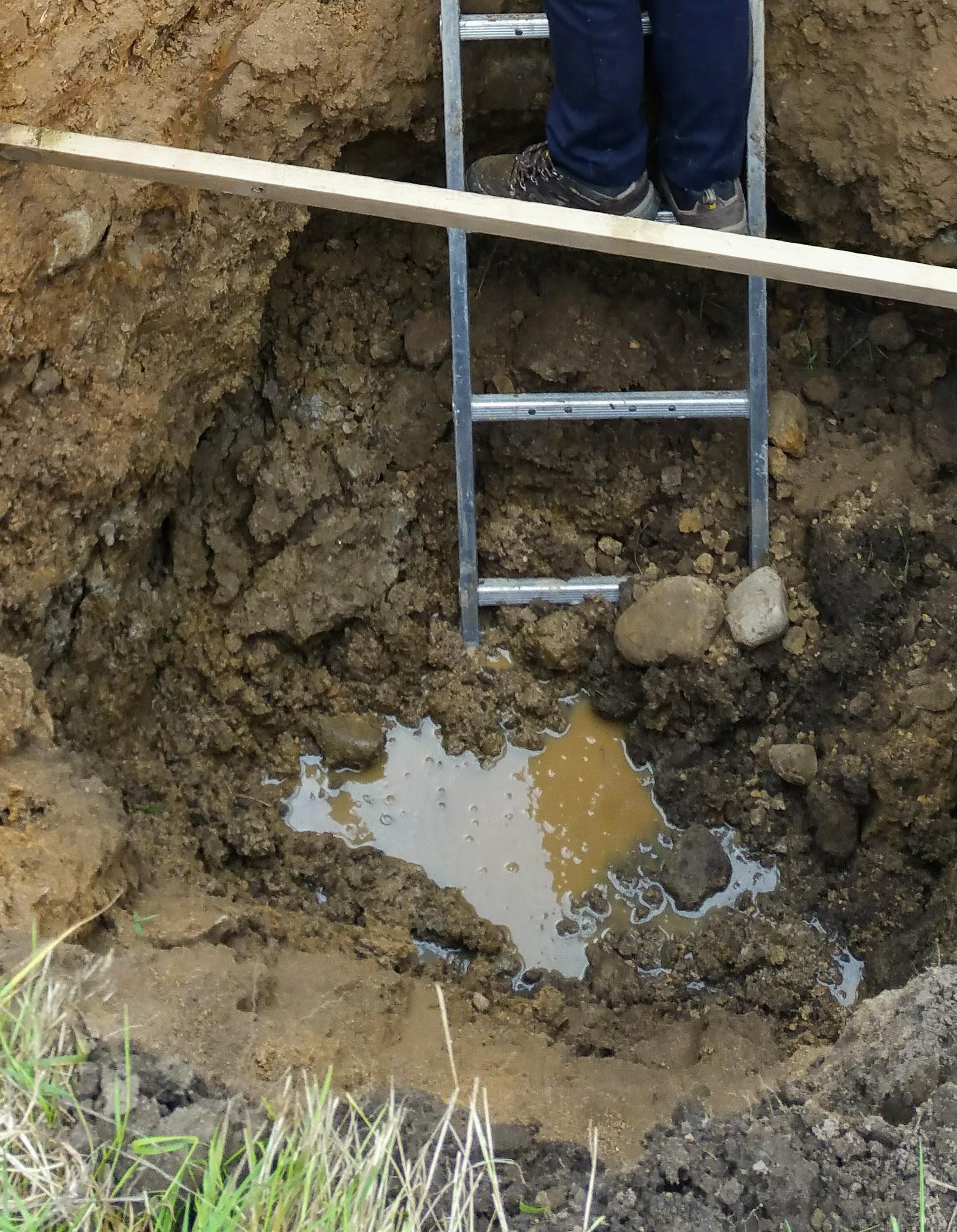

And now I need to fill the damn thing in.
I can't get a concrete pump close to the tank (unless its a 26 meter machine : £500 + concrete) : nobody round here does a small concrete pump. So it's mix it yer' sel' time.
There's 6 inches of water at the bottom of the 'ol, as in this heavily edited image .... Does the water in the bottom of the hole matter? Please tell me I don't have to pump it out.......
Posted
It took us a day and a half to concrete ours in. Mixer set up next to "the ole" but still had to barrow it from the mixer to the 'ole and pour.
After the first day we had water on the top of the previous days mix and pour, pumped as much as we could off then made the first few barrow loads a bit dry to soak up that puddle.
Fill the tank with water as you go, you don't want to over fill it to start with, but keep the water level in it just above the level of the poured concrete.
Posted
Our guys backfilled around ours with a dry mix, poured down a plastic waste chute fitted in a channel cut into the side of the hole to get it to the bottom.  They kept the tank half full of water suspended from strops on the digger whilst they did this.  The hole was around 1/4 to 1/3rd full of water at the time.  It was a bit like using postcrete, pouring a dry mix into a hole with water in it.
They poured concrete up to around 150mm or so above the triangular anchor lugs that stick out near the bottom of the cone, let the concrete go off a bit, then filled the rest of the hole up with pea shingle, which added to the  ballast holding the tank down as it was resting on the ring of concrete at the bottom.  As soon as the pea shingle was in, they untied the tank from the digger and pumped more water into the tank to hold it down.
