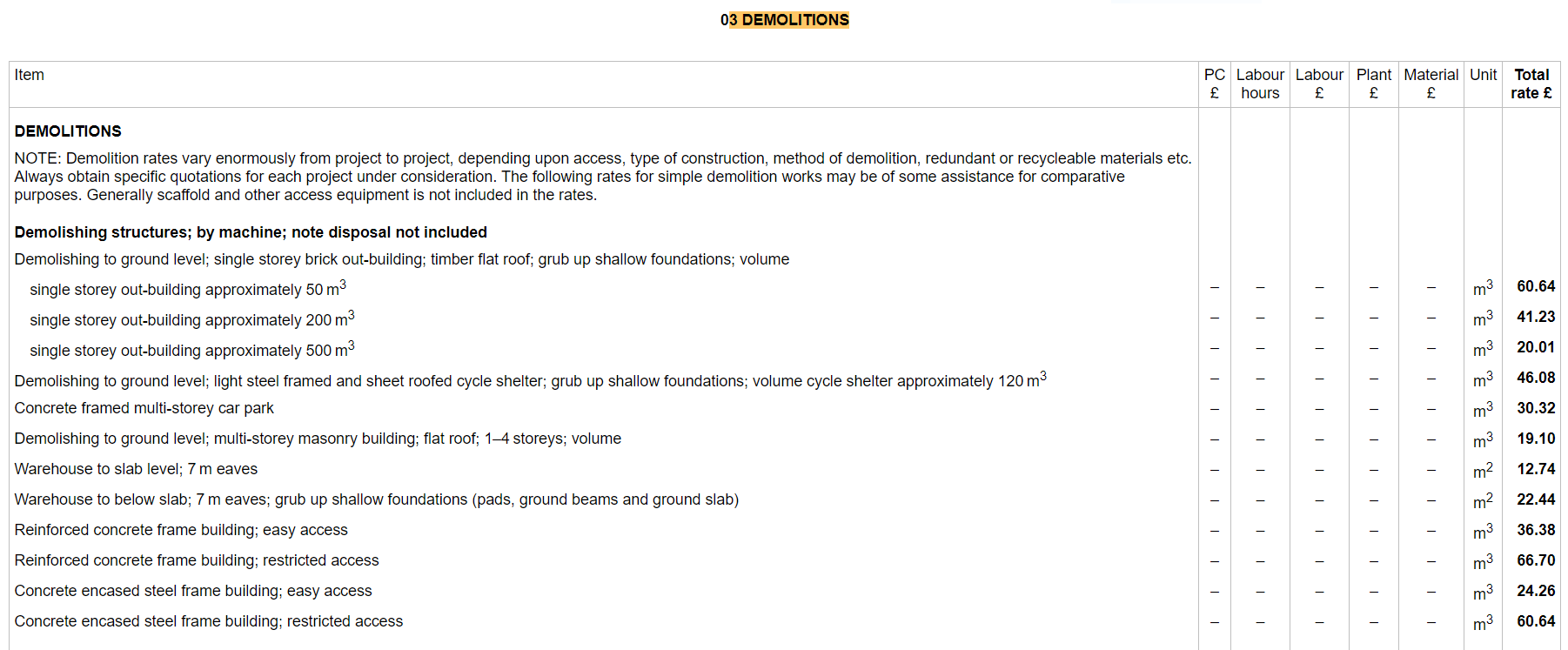

ToughButterCup Posted August 23, 2018 Share Posted August 23, 2018 2 minutes ago, Ferdinand said: [...] There are various ways of helping to deal with it - involving professionals (eg PM), or books, [...] Good post F. Nudged me into looking it up in SPONS Here's the relevant entry 1 Link to comment Share on other sites More sharing options...
Ferdinand Posted August 23, 2018 Share Posted August 23, 2018 (edited) 2 minutes ago, recoveringacademic said: Good post F. Nudged me into looking it up in SPONS Here's the relevant entry It doesn't say whether that includes taking away the rubble , even in the blurb at the top. So presumably that is considered to be a separate operation. Edited August 23, 2018 by Ferdinand 1 Link to comment Share on other sites More sharing options...
ToughButterCup Posted August 23, 2018 Share Posted August 23, 2018 1 minute ago, Ferdinand said: [...] So presumably that is considered to be a separate operation. Yes. Caveat Emptor. Link to comment Share on other sites More sharing options...
