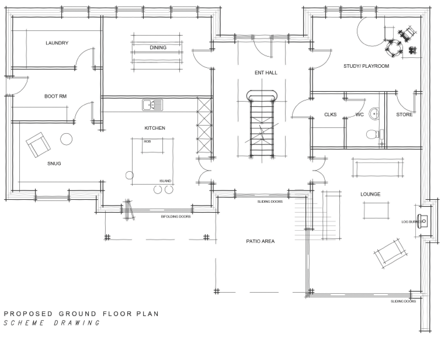

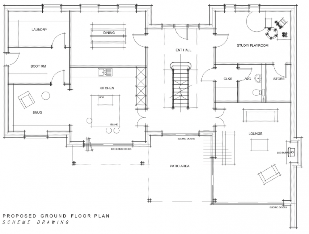

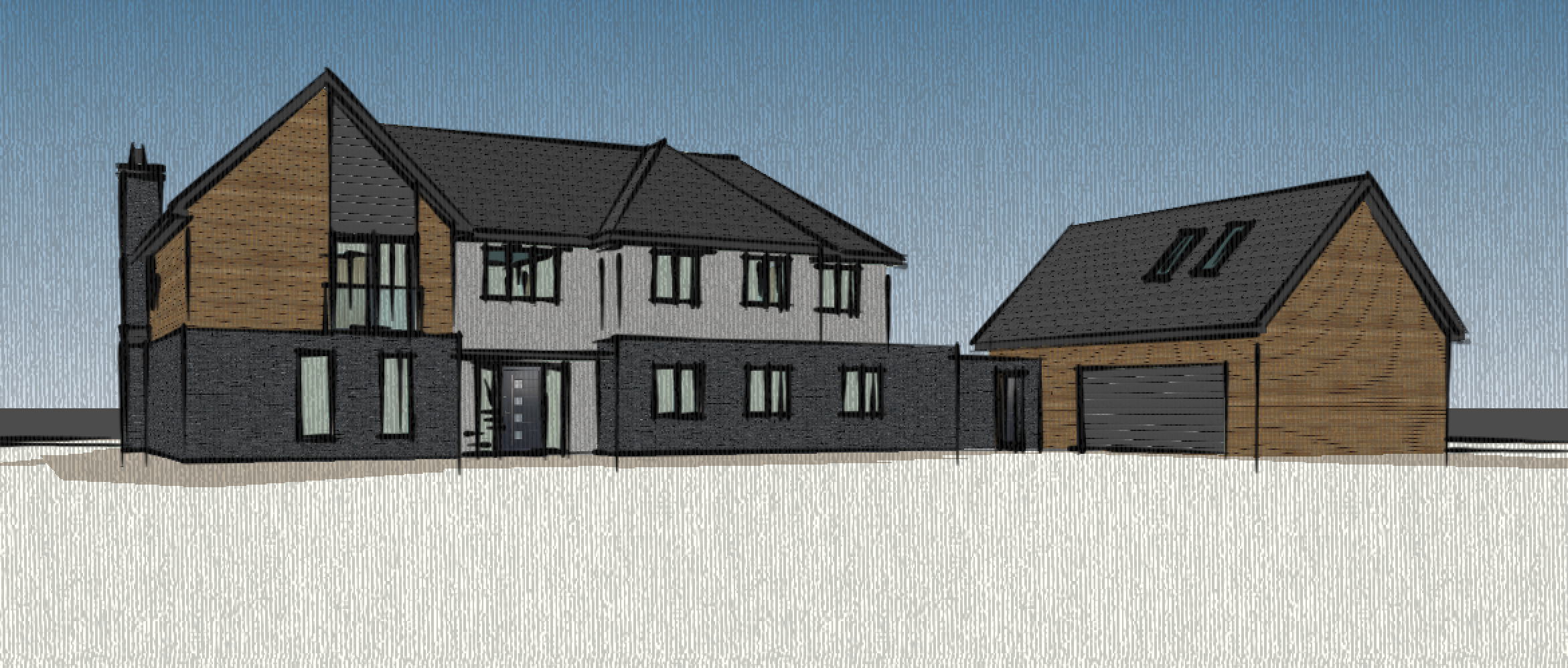

CADjockey Posted June 12, 2018 Share Posted June 12, 2018 So I'm in a quandary over why I'm not excited about the design we currently have. Not gone to planning yet, Could do with some external comment as cannot now be objective. Here are the floor plans from the designer, and some SketchUP views by me. Any help appreciated, thanks in advance. 1 Link to comment Share on other sites More sharing options...

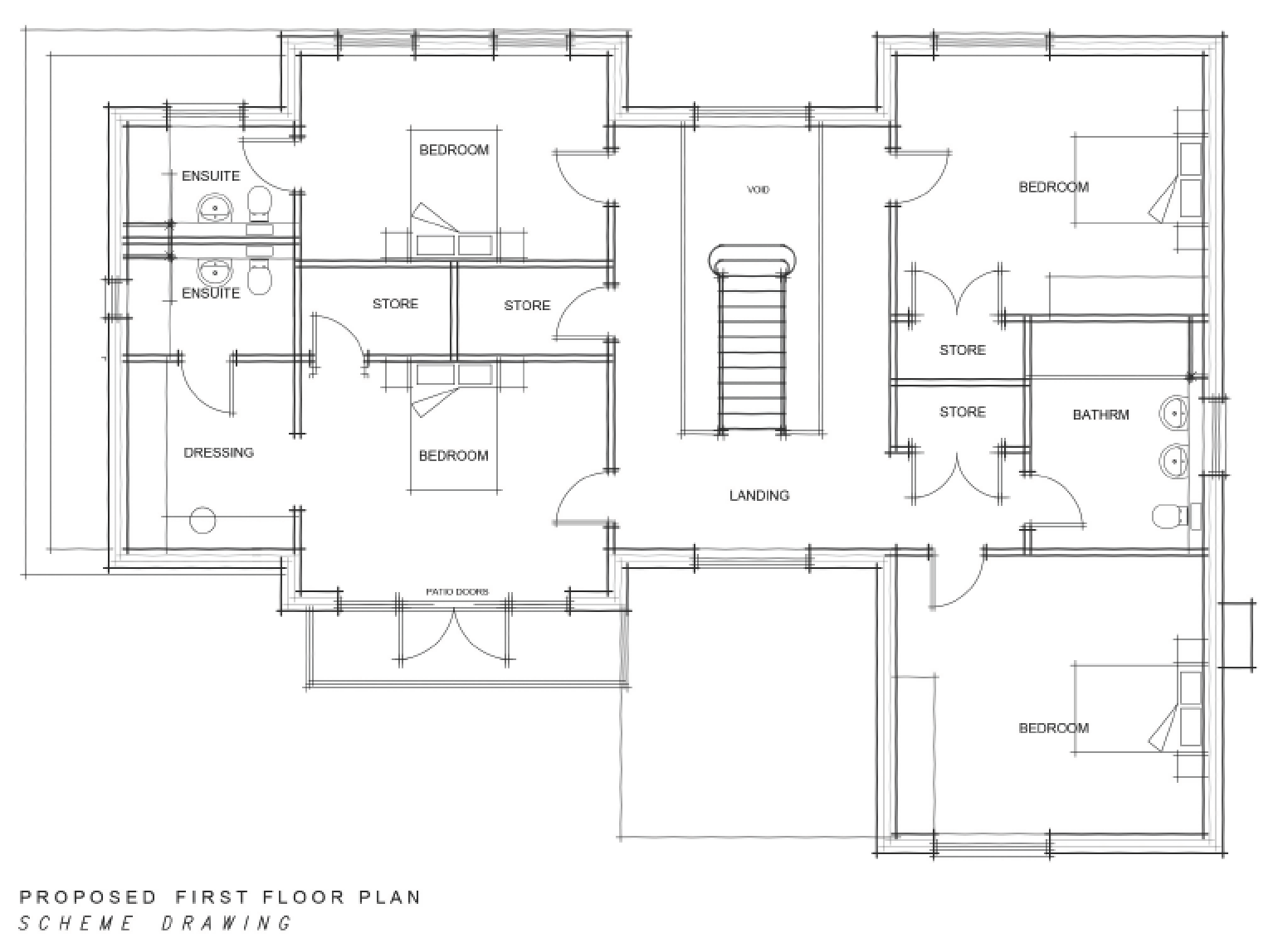

PeterW Posted June 12, 2018 Share Posted June 12, 2018 Right ... - too many “stores” upstairs - move bathroom to be accessed by landing and make bed 3/4 share a jack and Jill ensuite - master shower has a window in it .... in the tray area ..? - no direct access from kitchen to dining, you’ll never use it ... - snug isn’t snug, it’s an alcove off the kitchen - plant isn’t big enough, laundry and boot are too big so combine - study and playroom..? How old are they..? Consider finding somewhere for an office space - what’s the square above the patio for upstairs ..??? - master balcony - will you ever use it..? I’ll have another look in a bit .. Link to comment Share on other sites More sharing options...

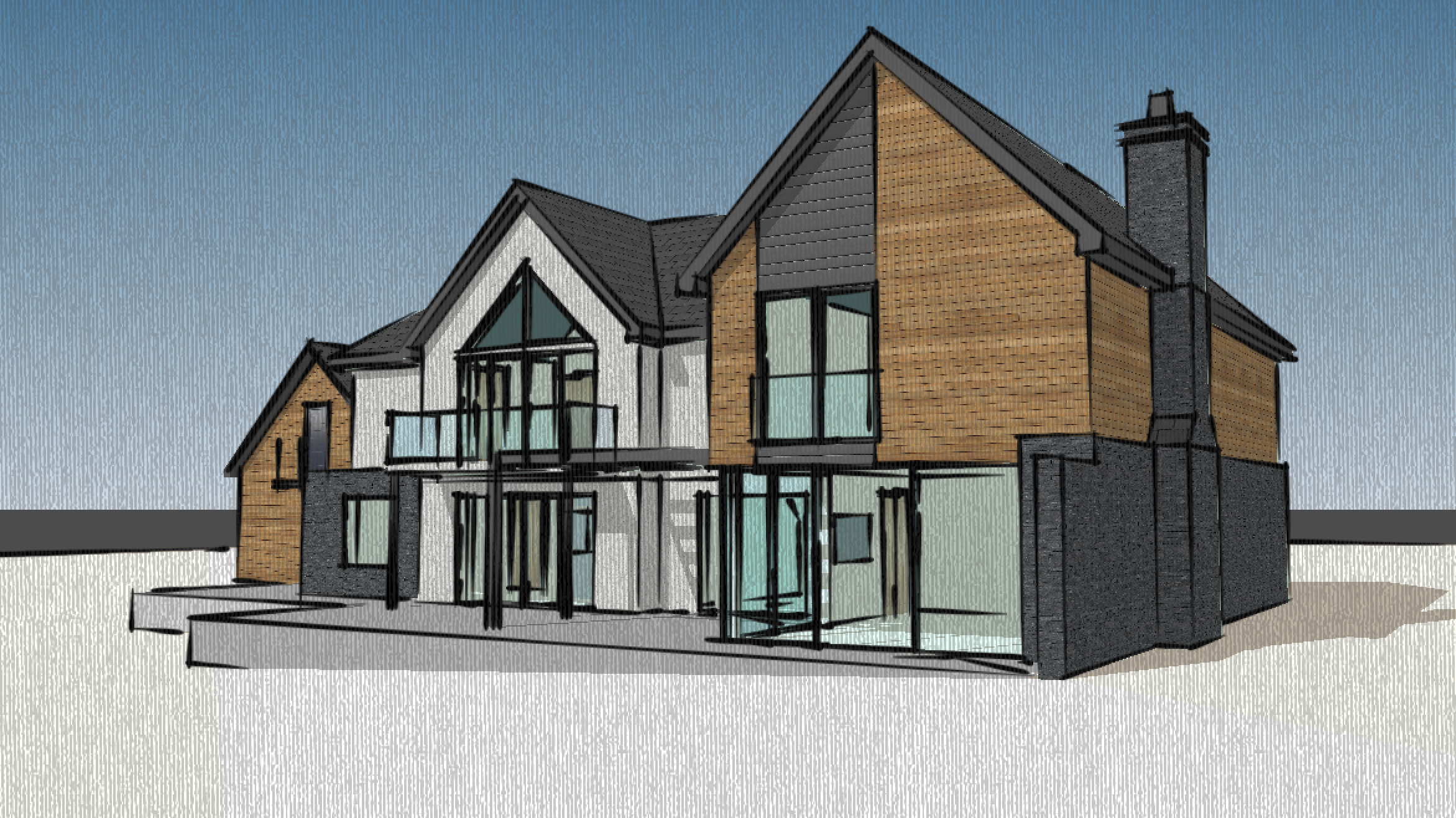

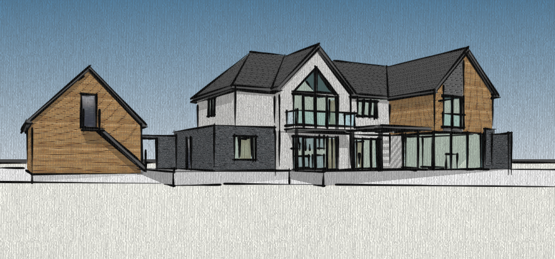

pdf27 Posted June 12, 2018 Share Posted June 12, 2018 You've also got quite a lot of what appears to be detail for the sake of detail - it's quite a complicated shape for what appears to be no real reason inside, presumably purely to add external interest - you should be able to break the building up into smaller sections in other ways that are cheaper and give a better airtightness & insulation result. Having upper level floors & roof offset from the ground level floor is going to give you structural headaches - if you can line them up it will save a load of cash. Likewise unless you really need one deleting the basement will save you a lot more money - delete it and you can just use an insulated slab which is a hell of a lot cheaper unless you're on a major slope. In some ways the current design reminds me a bit of something found on http://mcmansionhell.com/ , at least externally. On the insides I agree with @PeterW that it looks like it has an awful lot of house for not all that much space: the hall for instance is taking up a huge amount of internal volume, and unless you already have plans for the space the gym, most of the storage and possibly even the cinema would be much better off in the garage roof space than where they currently are in the basement. Link to comment Share on other sites More sharing options...

MikeSharp01 Posted June 12, 2018 Share Posted June 12, 2018 What general feel are you trying to achieve, do you want to stand out on the street but be broadly in keeping with the vernacular or are you trying for very much more 'out there' look to the outside? Was the downstairs layout done by the erstwhile architect, it seems to me to have too many routes and not enough synergy, you have loads of 'spaces' which would be great if you have about 20 people living there all of whom need a separate space to do their thing. If you have young children in that layout you will be well out of touch with them in the playroom while you are cooking, if not then why have a playroom, I would swap the snug / playroom - study over and make a connection with the dining room direct from the kitchen, you could use a Narnia door, great fun. Link to comment Share on other sites More sharing options...

newhome Posted June 12, 2018 Share Posted June 12, 2018 Downstairs seems to have too many separate rooms and not much flow. Dining room needs to flow from the kitchen - who wants to carry stuff into the hall from the kitchen and then into another room? The downstairs loo sandwiched between the cloakroom and a store seems a bit odd. Would a downstairs shower room serve you better? Walking through a wall of coats to use the loo seems strange. The 'snug' (I'm going to call it a family room cos that's what it will be) is small compared to the boot room and laundry. I bet you will use that space a huge amount so look at making it larger to suit. A study / office can be on its own at the front of the house, but a playroom cannot. So ditch the idea that a playroom can be located there. Will you really use patio doors off the hall? That seems an odd idea to me TBH. I like the bifolds from the kitchen however, those should work well. Can't get my head around all the stores upstairs. Is there a bath in the upstairs bathroom? Can't see a bath anywhere else. And 2 sinks? Having 2 sinks is more usual in the master bathroom, and I think the master bathroom is quite small in relation to the size of the house. Externally - there is something about the grey bits on either side of the rear elevation that look a bit tacked on to me, like they've been added as an afterthought or after an extension has been added. Sorry if we've all been a bit frank and none of us are 'right', as it's your house, but throwing some comments out there for you to reject or consider as you choose. Link to comment Share on other sites More sharing options...
dpmiller Posted June 12, 2018 Share Posted June 12, 2018 In some ways the upstairs layout reminds me of ours; I'd have to ask tho, why does the bedroom with the dressing room get a "store" but the one next to it doesn't? Link to comment Share on other sites More sharing options...
ProDave Posted June 12, 2018 Share Posted June 12, 2018 It's all too disjointed. Make the current kitchen, dining and snug all one big "familly room" (kitchen dining and living on one) Then make the Lounge your snug to get away somewhere quiet. Laundty and boot to become the playroom, near everyone else. Playroom to become boot, laundry, planr etc out of the way. Upstairs, 2 right hand bedrooms to share jack & jill bathroom but you need a familly bathroom so make that one or both of the stores? Big gallary landing is a wow feature, but boy what a waste of space. Can't comment further until I know which way is North. Link to comment Share on other sites More sharing options...
AliG Posted June 12, 2018 Share Posted June 12, 2018 (edited) Welcome to the forum. As you already mentioned that you are thinking getting rid of your architect, this reinforces that I probably would. I do like the look of the outside, but this is one of the strangest interior layouts I have seen on here and I would echo most of the comments above. I think the best advice is to make a list of rooms that you need and how you plan to use them and then decide how big you want them to be as a starting point before getting onto details. 1. Combine boot room/ laundry room and use the space freed up to make the snug bigger. 2. You walk through double doors into the kitchen and right into the island. As a general rule I think there should be a lot of space around the entrance to a room to make it feel spacious when you enter. The island is also in front of the bifolds. The whole kitchen layout needs rethought. You might want to move the kitchen area to where the snug is, if you made it bigger via point 1. A lot depends on whether you want a sofa in there or a table (which I prefer to an island). It really depends how you want to live in the space. Also square islands don't work well as you can't reach the middle. 3. I have a large double height entrance hall, and what you have there is very grand, but it uses a large percentage of the space. I see that the entrance to downstairs is under the stair and then you have patio doors that are unlikely to get used. Moving the stair to one side might actually make the hall feel bigger and allow a larger more open double height space if that is what you are going for. 4. I would hate having to walk through a cloak cupboard to get to the WC. I'd try and have a cupboard off the hall and a WC. I would also try to have a window in the WC if possible, 5. Not sure why the master bedroom has a store and a dressing room. I would probably make the store a wardrobe for the bedroom next door. I would not have an ensuite bedroom that did not have a fitted wardrobe. 6. I would make the master en suite larger and swap it around so the window is next to the sink/WC. 7. I also am not a big fan of balconies. Do you think you would actually use it? 8. Making upstairs just slightly smaller than downstairs at these side will be very awkward to build. It would probably cost more and give you less space than if the area where the master ensuite and dressing room are just went right to the side of the house. You could use this to make them larger also. Actually looking at it, it is a really bad piece of design. There is an upstairs corner with nothing to support it for the sake of bringing it in roughly 2 feet. I think the house e has enough shape and interest to it that this would not make it too boxy. 9. I would concur that I would make the master en suite larger than the main bathroom. That's the room you'll use every day. 10. As drawn, it appears that the downstairs ceiling height is 2.4m. A house of this size would normally be 2.6-2.7m on the ground floor nowadays. 11. The garage is almost connected to the house, but not quite. It looks like the garage is designed to have usable space above it. If so, I would connect the garage properly to the house so you don't have to go outside. 12. You could consider putting the cinema and gym in the roof space rather than a basement, or rejigging the rooms to put a playroom up there and the cinema downstairs. It will probably be cheaper. We have put a games room up in the roof and it is a lovely light space. I hope this doesn't sound too harsh. Some designs on here have been excellent and I wish I asked for advice on my own design. I also really like the outside look of the house. The layout though, seems to do some quite strange things and make some basic errors. Edited June 12, 2018 by AliG Link to comment Share on other sites More sharing options...

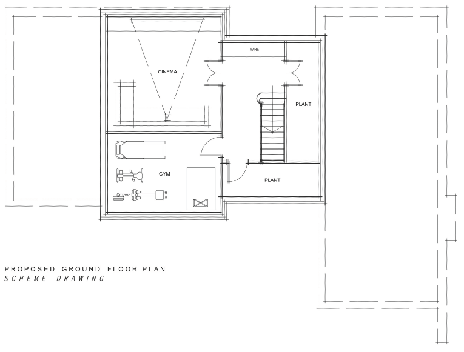

Bitpipe Posted June 13, 2018 Share Posted June 13, 2018 Lots of feedback here that is valid. A basement is good value and adds valuable space that planners tend not to look at too closely, but they're only really economical if they follow the footprint of the house and act as the foundations. Great for cinema room, gym etc and as teenager space when the kids get older. You will need a means of escape that is independent to the internal stairwell or a sprinkler system to meet regs though. If you put these rooms in loft then consider the noise transmission to bedrooms below (It's very expensive and difficult to minimise impact noise from floor to floor). Think also as to which bedrooms are above which reception rooms and how they will be used in the evening - when you have teens and want an early night, will their watching TV disturb you? Orientation to sun is also key - we put the kids rooms on east so bright in morning and darker at night. I think theres a lot to be said for designing the house from inside out vs the other way round... Other than that I agree on the comments on flow. Our previous house was new build but lots of individual rooms which never really worked (after we sold it, the new owners made it open plan). Current self built house is effectively a cube with an open plan U downstairs from kitchen to dining to living and a separate study. Rooms are defined by furniture and there is more flexibility in use and layout - works well. Before you redesign, read the Mark Brinkley Home Builders bible - lots of important principals there on designing out cost - a cube always has the maximum practical usable area to wall ratio, rectangles less so and corners cost money. Gable ends vs hipped roof reduce complexity and offer more room in roof space. Obviously you don't want a plain facade but too much detail will just end up costing you money (I have pretty bedroom balconies that I will rarely use and they gobbled up lots of budget) balustrade glass is quite expensive and needs careful structural thought on what it sits on or attaches to. Also, assuming you build to a relatively decent standard of airtightness and insulation, overheating will be your main concern, especially with large expanses of glass. Have you given thought to your heating / ventilation strategy? location of DHW generation / MVHR wrt use (i.e. as central as possible) Where will your DHW storage be? Why do you have a chimney? If its for a log burner etc, consider whether it is needed for heat generation (big risk of overheating that small lounge) and the environmental issues of wood burning and possible restrictions on that. Regarding storage, you always need more than you think but my experience is that long shallow cupboards are more useful than narrow deep ones. We gave each bedroom a run of ikea wardrobes that were framed in once assembled and that's more than enough for each room. A large cupboard downstairs for coats, shoes, and cleaning/ironing equipment and one on the first floor for laundry, towels bedding etc. Link to comment Share on other sites More sharing options...

epsilonGreedy Posted June 13, 2018 Share Posted June 13, 2018 A kitchen sink facing a long wall = no. Sometimes a necessity with an existing house or small kitchen but should be designed out given a cleansheet. 1 Link to comment Share on other sites More sharing options...
CADjockey Posted June 13, 2018 Author Share Posted June 13, 2018 Thanks, I think... I probably should have added some additional detail before opening the flood gates, but all comments interesting. So, a few things, by no means all... I for example might have said that layouts of bathroom, kitchen content are just plonked in by the designer and are not reperesentative of final condition. As are the naming of all the 'Stores'. The Study/Playroom is a reflection of how we use our current one off our existing lounge, whereas in this plan it's more Study, no intent to watch over little ones now they are 7 & 10. I take your points about the scale of the hall/landing space, yes it's big, you should have seen his first draft! My only real intent for that was that I want to access all the main rooms of the hall/landing without passing through other rooms. This is not an issue for the en-suites or dressing room or boot room and laundry which are functionally different. The stores on the first floor are wardrobes, except the landing accessed one which is linen, airing cupboard if you will. But can be repurposed to accommodate stairs if ever we wanted to expand into the loft. The family bathroom was accessed from the landing but ended up being too small and there was an intent to try and make the kids rooms as similar in size as possible. I can't be doing with Jack'n'Jill, I just not going to happen, but I do see the point. We use our separate dining room every meal time unless we are outside. I get the distance from kitchen comments, and my wife has some reservations in that area, I just think an additional door between kitchen and dining is a waste of storage space, and a 70s hatch seems out of time. Still undecided. We are not fans of the current trend for endless open plan living, and personally I think it's really a just side effect of rooms being too small in modern houses. I do have a minor concern that if we put in an island that drops down into a table on the patio side we end up never using the dining room, but only because we have an additional table that is... yes... closer. Thinking still required. Balcony wasn't our idea, but came from the designer, I've skinned it down from the 5m square landing pad that he originally drew, I could literally have relaunched the Falklands conflict from it, and am leaning towards a Juliet as shown on the RH bedrooms. The cellar... yes, I know it's pouring money into a hole, quite literally, but for one thing I can't see where to put the additional rooms, connected to the house in some kind of flow with the other main rooms and have them on the GF where they belong. Yes I will have a 9m space above the garage, but I don't plan on going out to the garage to watch a movie. And for another thing, we want a cellar. Additionally it's kind of free planning space. Interesting comments on the differential footprint GF to FF and additional cost implications and the GF ceiling heights is not something I'd considered. I can go on, but that's probably enough for now. Further comment still appreciated, I still think :-) Added site plan for interest, the garage is in the wrong place and so are the steps to the first floor and the huge patio is all wrong, so not much right then... Link to comment Share on other sites More sharing options...

jack Posted June 13, 2018 Share Posted June 13, 2018 15 minutes ago, CADjockey said: My only real intent for that was that I want to access all the main rooms of the hall/landing without passing through other rooms. Any particular reason for this requirement downstairs? For less-used rooms (eg, lounge if you generally use the snug), why does it matter if you need to go via another room? Saves wasted circulation space (not that all circulation space is wasted, of course) and can help link everything together. Picture the scene as you walk through the front door at the moment: a cavernous reception room dominated by a central staircase, and then... some doorways around the perimeter. The only one of these that gives you any glimpse of what's to come is the slight view you get through the lounge to the garden. The view from the front door through all the other doors is onto a wall adjacent each of those doors. 17 minutes ago, CADjockey said: We use our separate dining room every meal time unless we are outside. I get the distance from kitchen comments, and my wife has some reservations in that area, I just think an additional door between kitchen and dining is a waste of storage space, and a 70s hatch seems out of time. Still undecided. Is your current separate dining room a several minute walk from the kitchen? Believe me, you'll get sick of that traipse after a while. "Oh, forgot the ketchup", "Bugger, I forgot to get a drink", "Can you refill my drink while you're there", "Sure, I'd love some more if there're leftovers", "Right, what's for pudding", etc. I think the distance of the dining room from the kitchen is the biggest problem with this design. If I fixed nothing else, I'd fix this. 28 minutes ago, CADjockey said: We are not fans of the current trend for endless open plan living, and personally I think it's really a just side effect of rooms being too small in modern houses. Have you ever lived in a house with a properly designed and scaled open plan area? You worry that you won't use the dining room, but that's surely a feature rather than a bug? If you make it pleasant to eat adjacent the kitchen, then a separate dining room, and all the extra cost it entails, becomes redundant. If you really must have it separate, you could put your dining room where the current snug is, and maybe pinch in the doorway a little. You'd be a lot closer to the kitchen, while still have the dining area feel separate. You also seem to be conflating open plan per se with "endless open plan living". There's a balance, surely? And as for house sizes leading this, we intentionally chose open plan kitchen and dining, despite our house being nearly 300m2, because I've lived with both and vastly prefer it this way. That said, it's your house, and it has to reflect the way you live. However, I found it telling that the way we live changed in ways I hadn't thought about once we moved into our new house. For example, we've always lived in our lounge, but once we got a snug, we found ourselves living in that instead, and hardly use the lounge at all unless we have people over. Link to comment Share on other sites More sharing options...
epsilonGreedy Posted June 13, 2018 Share Posted June 13, 2018 3 hours ago, CADjockey said: We are not fans of the current trend for endless open plan living, and personally I think it's really a just side effect of rooms being too small in modern houses. Or maybe due to the fact that butlers and footmen became too expensive to employ. ? The isolated formal dining room is a legacy of the times when domestic staff brought food to the dining table. Link to comment Share on other sites More sharing options...
CADjockey Posted June 13, 2018 Author Share Posted June 13, 2018 3 hours ago, epsilonGreedy said: Or maybe due to the fact that butlers and footmen became too expensive to employ. ? The isolated formal dining room is a legacy of the times when domestic staff brought food to the dining table. When did they become too expensive? And on that note, where's the chauffeur going to sleep if I put the media room over the garage? Seriously though, my dad has lived in NZ for 20 odd years and NewZealanders seem to love the kitchen/dining/lounge space. Two things that we didn't like about it from experience was the simple fact that we don't want to sit in the same room as the pots and pans whilst eating and also have the smell of food lingering about the combined space after. Or maybe we are just grumpy and unsociable, or maybe that's just me :-) Link to comment Share on other sites More sharing options...
epsilonGreedy Posted June 13, 2018 Share Posted June 13, 2018 45 minutes ago, PeterW said: Why ...?? No window to allow focus on something beyond 3 feet and nothing to view 90 degrees left or right. Natural light obscured by the body of the galley slave. 50% of the kitchen worktop in a linear 12ft run. The OP's house must be 2500 sq ft, at this size most modern Britons want a convivial family space connected to the kitchen. Link to comment Share on other sites More sharing options...
