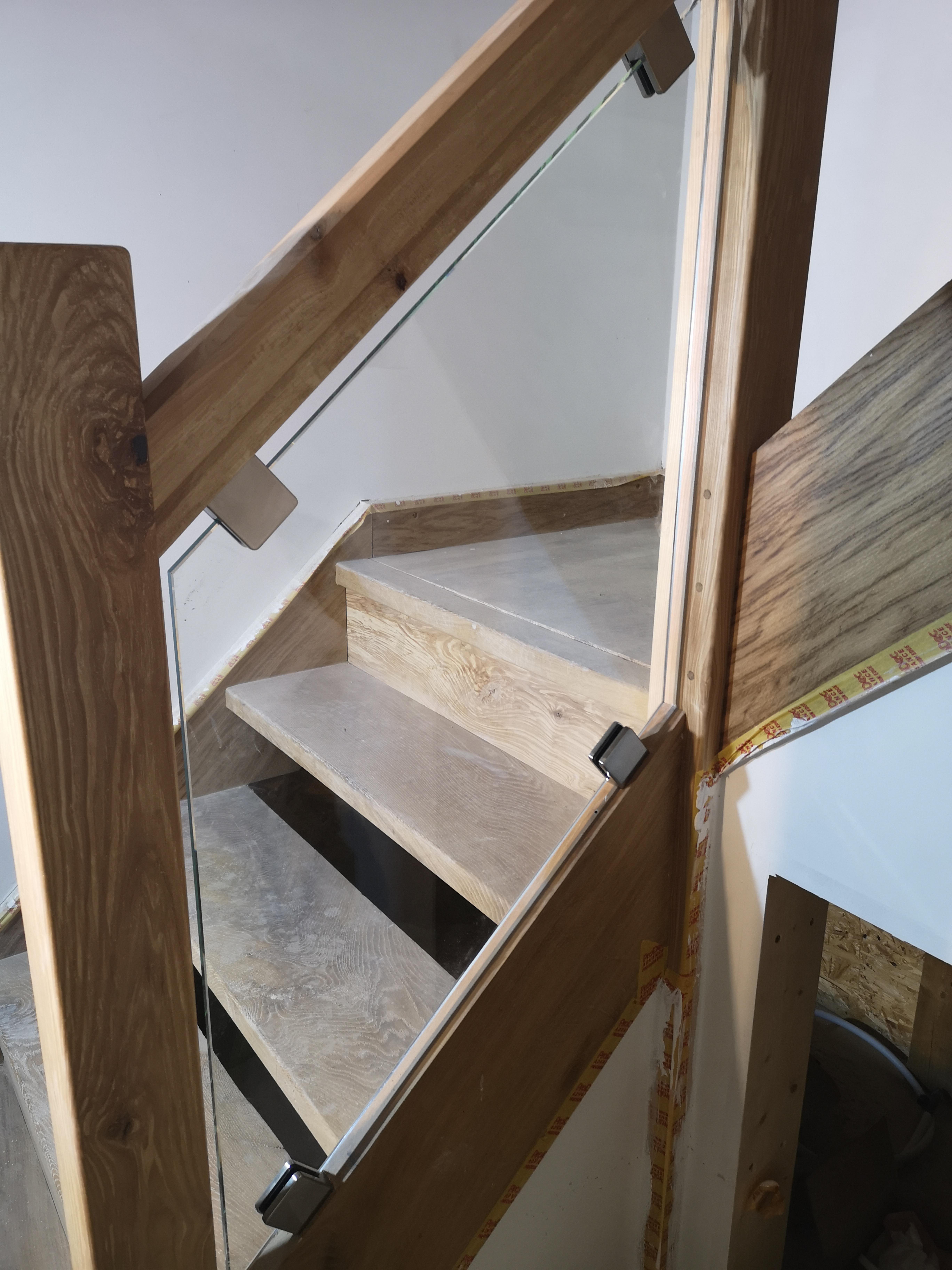

Construction Channel Posted November 6, 2019 Share Posted November 6, 2019 44 minutes ago, Onoff said: Have you just come back from The Plough? ? (Swmbo's vetoed the pile of skulls at the base of the pillars btw). Unfortunately no. Iv been messing about with my worktop shuttering and putting some plugs in the stairs. I really should spend more time in the plough ? Link to comment Share on other sites More sharing options...
Construction Channel Posted November 6, 2019 Share Posted November 6, 2019 Did get the first bit of glass in yesterday though ? 4 Link to comment Share on other sites More sharing options...
