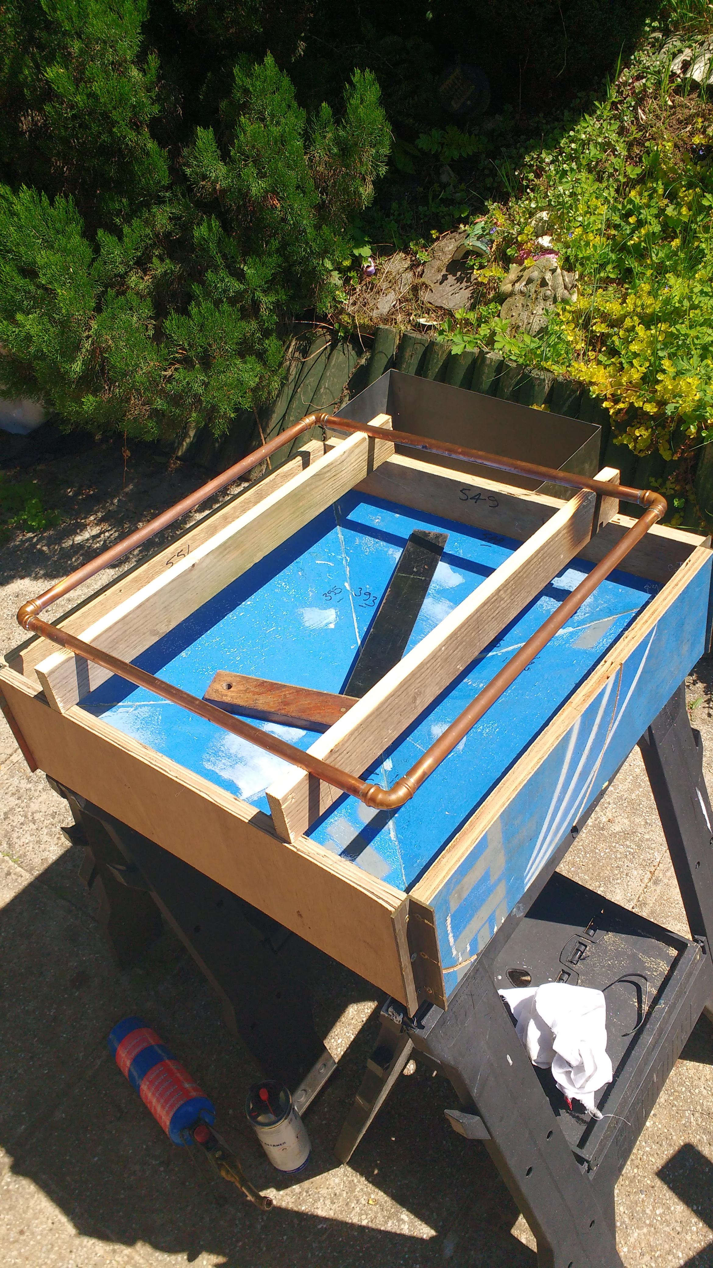

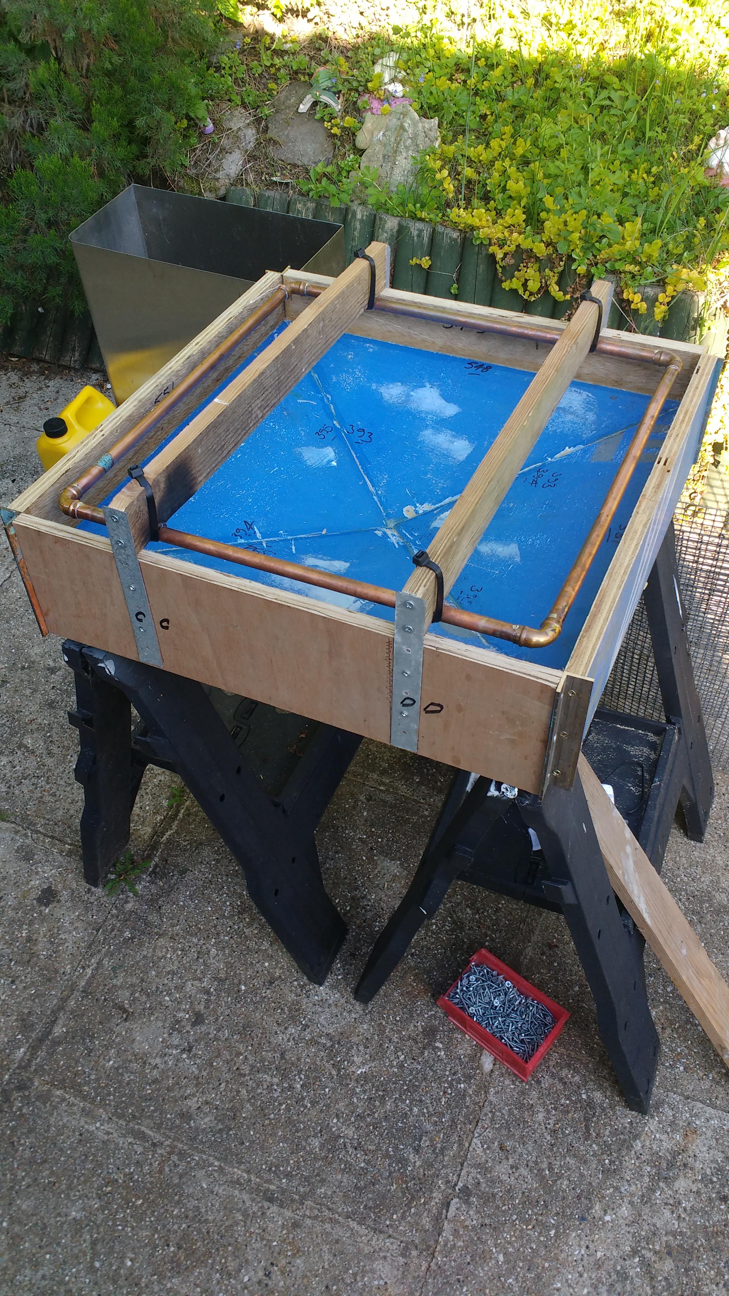

Finished my capstone mould...I guess. For tomorrow we cast!
Made up a square of 15mm copper to give a drip recess.
Currently got the copper glued to the timber with some blobs of CT1 and cable tied on whilst it sets:

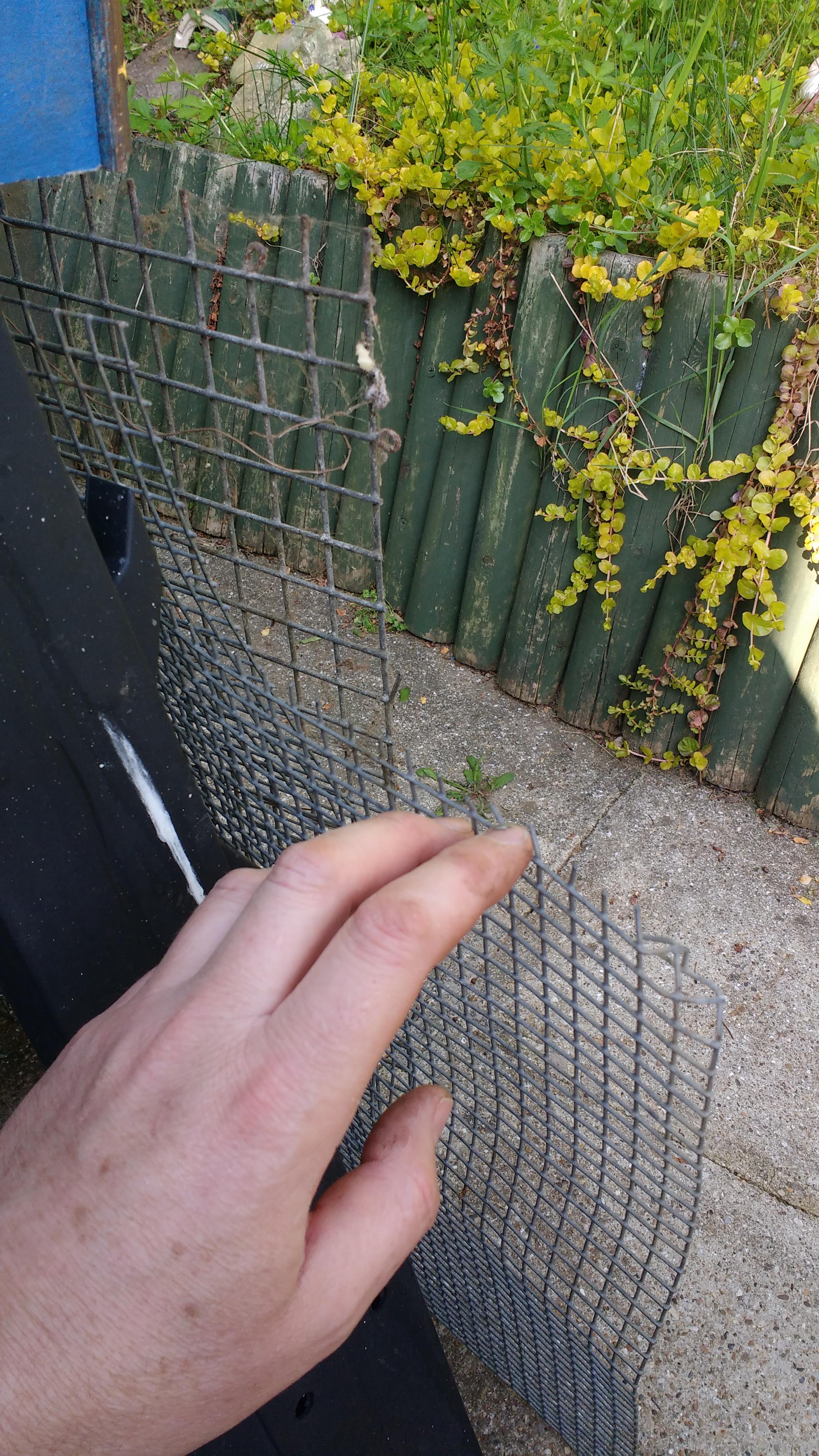

I'm going to put a square of galv mesh in halfway through the pour. Got one piece of 25x25x2.5 enough for just one cap.  Then some 12.5x12.5x1.5, enough for two. Not sure if the smaller mesh will be strong enough?
I was going to line the mould with say plastic sheet DPM. Just couldn't get it flat. Even tried ironing it with SWMBO's iron. I did put a fillet of silicone on all the internal edges and took it off with a 5mm radius Cramer Fugi tool. Guess I'll just brush the internal faces with vegetable oil? Seems preferable to engine oil etc. Another thought was lining it with duct tape.
Mould oil/release oil is available in diy shops.
ive seen others use diesel?
The write up for this says it can be used as a release agent.
https://www.toolstation.com/action-can-dry-ptfe/p57723?
Tbh I like the idea of vegetable oil, a bit more environmentally friendly etc. Once the caps are on I imagine it'll just degrade and wash off.
