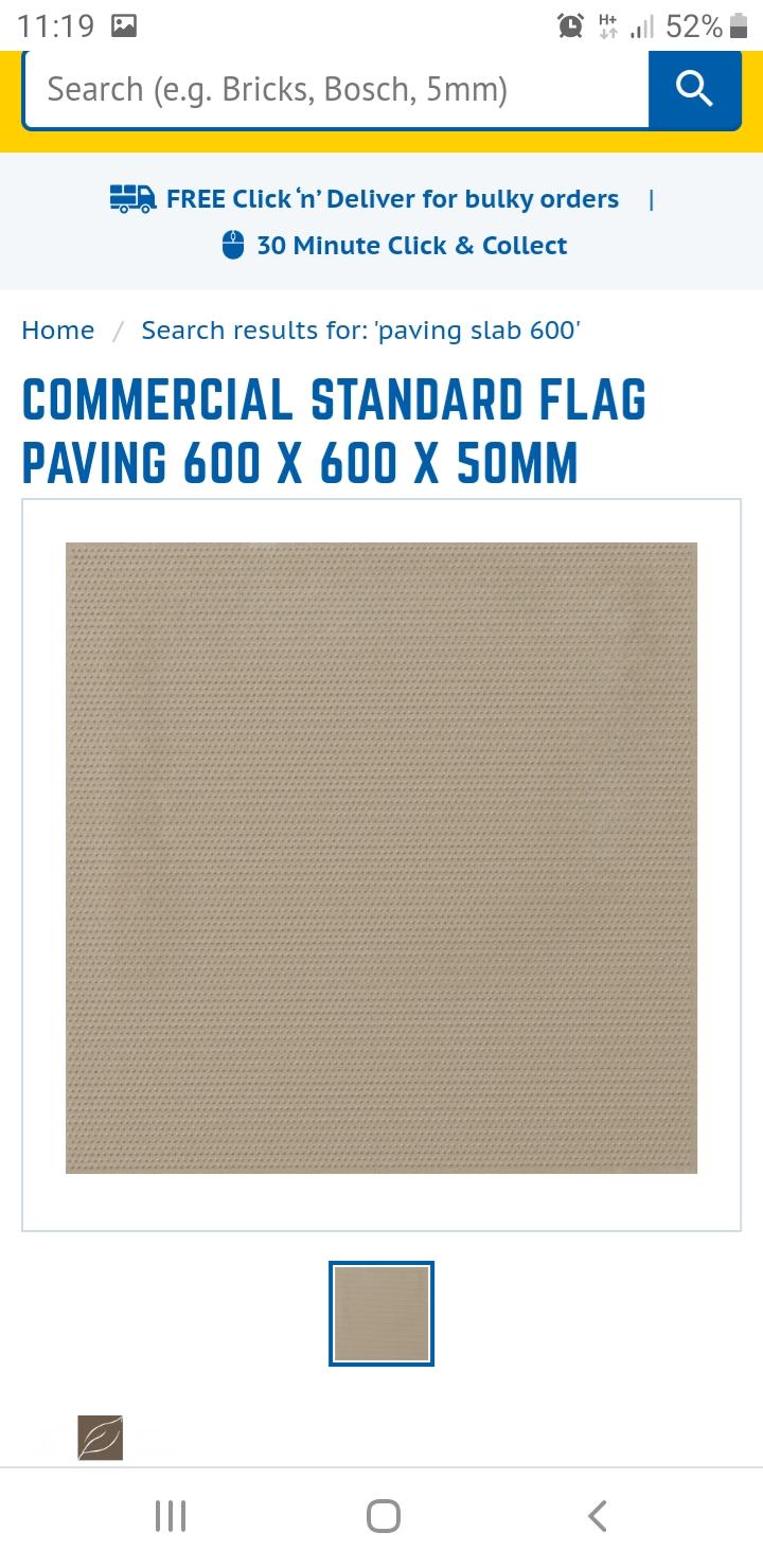

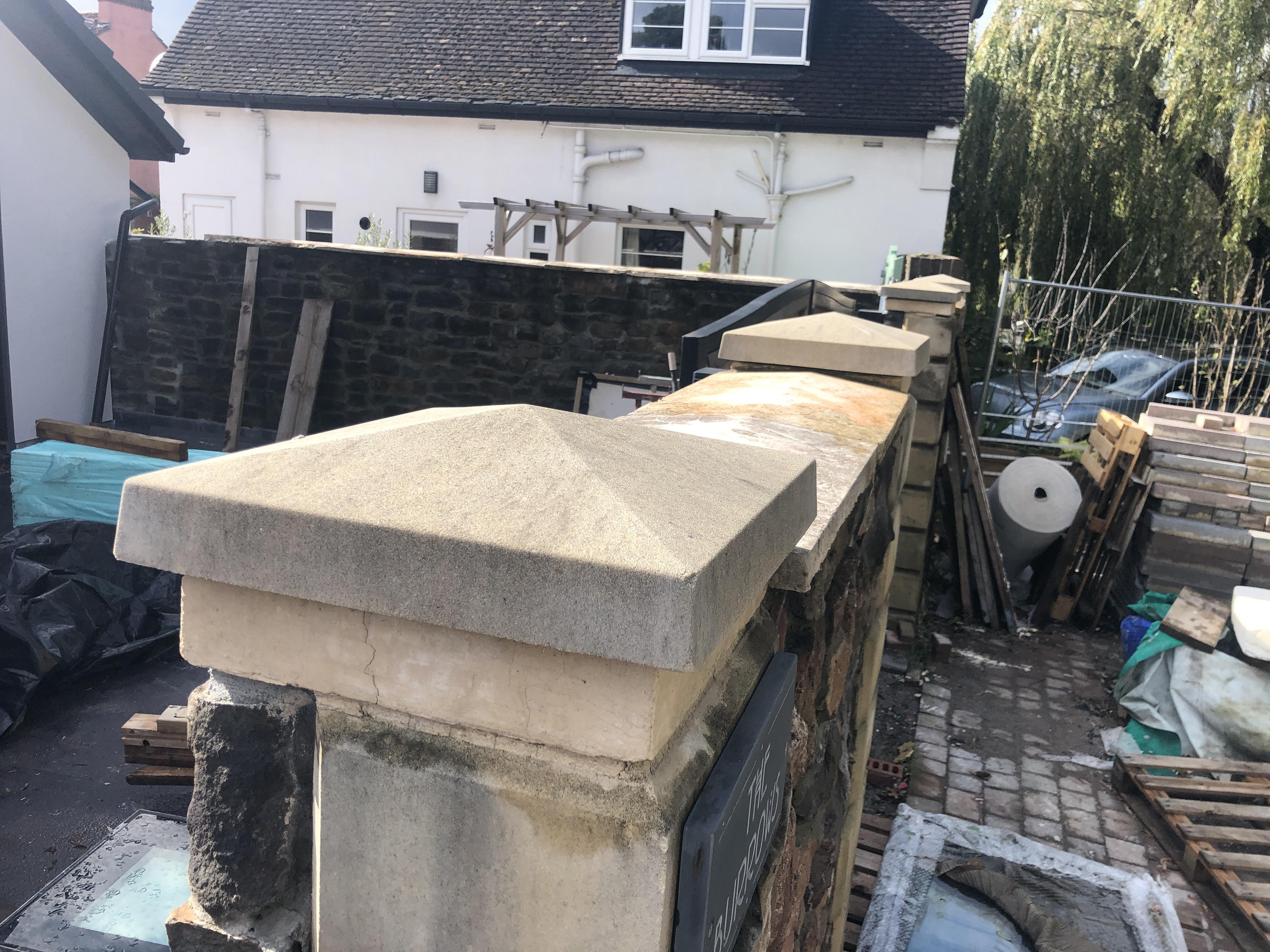

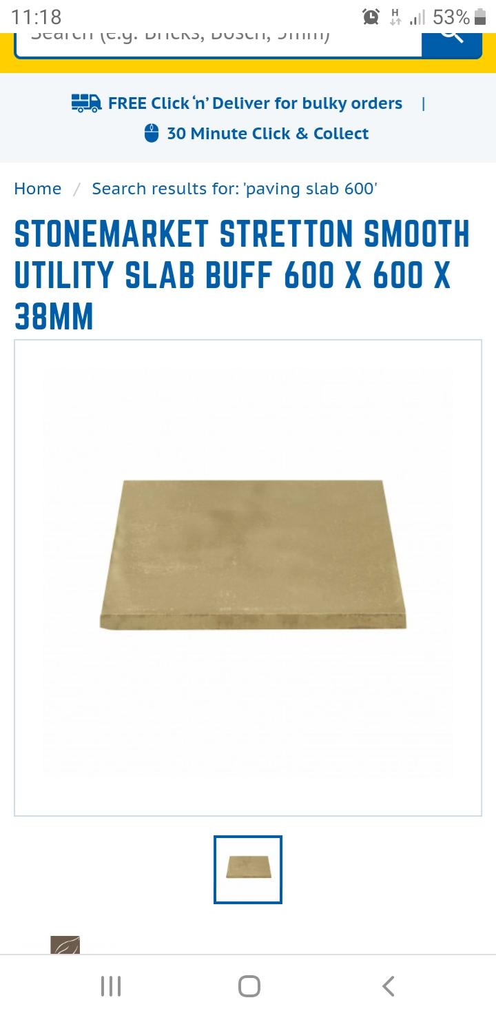

How to cap these pillars?
or
or
Nah get nice caps
