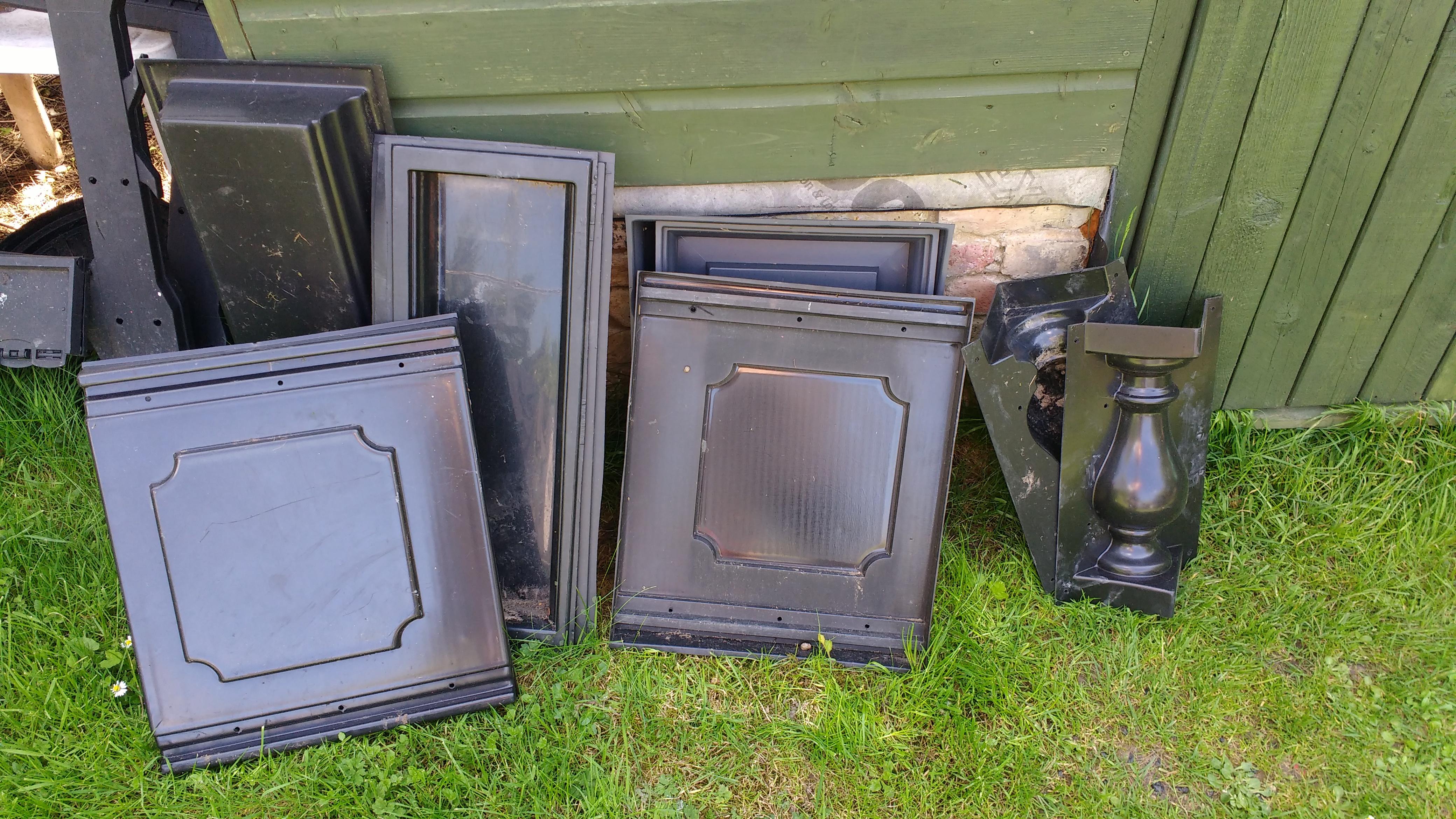

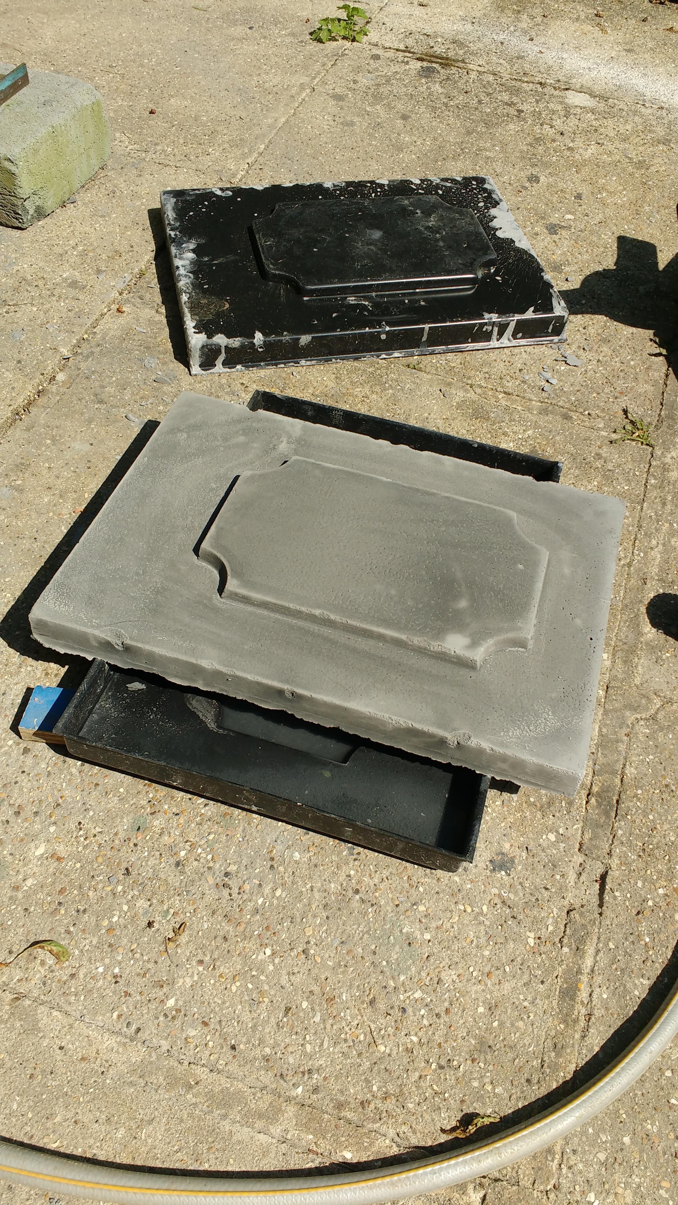

I was recently given a whole load of plastic concrete moulds. No immediate use for them...but they were free!
Typically none the size I wanted for atop the gate hence making the bespoke mould.
With some leftover mix from doing the first cap stone I did then fill one of these moulds up. It is at least indicative of what the cap stone might come out like.
Thinking once on to treat it with a liquid waterproofer / rain repellent  like Thompson's Waterseal. Might help keep its colour too.

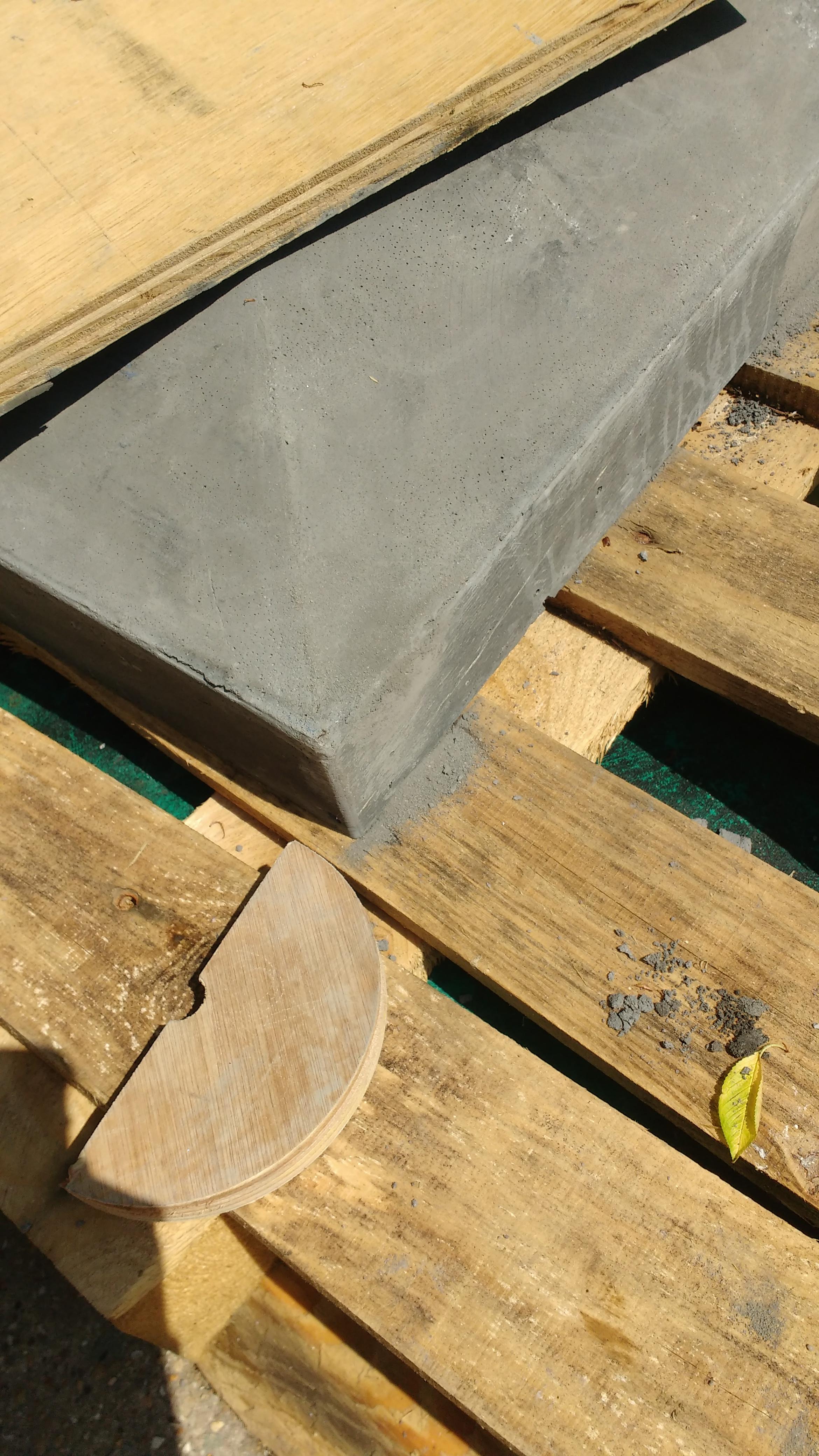

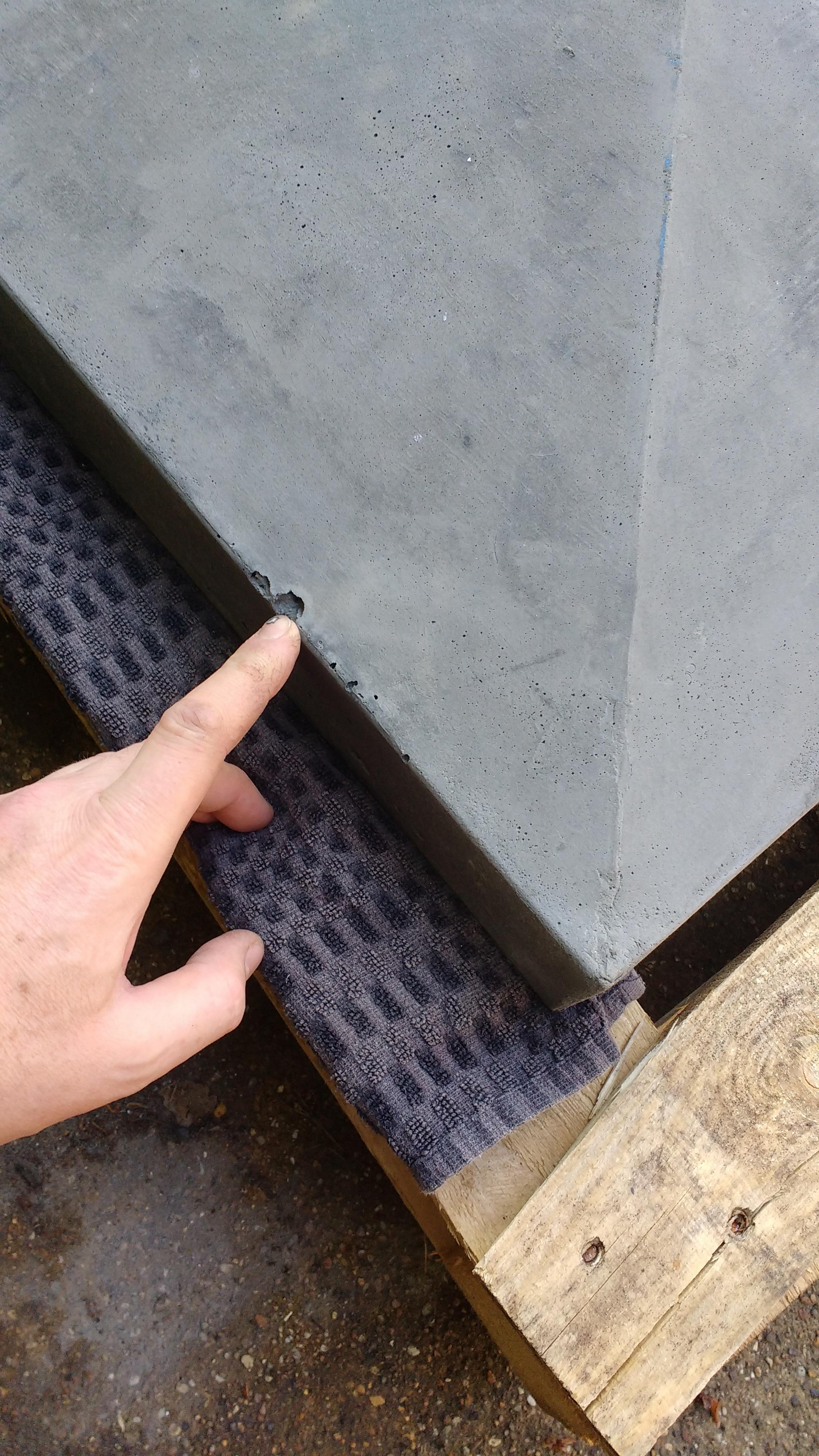

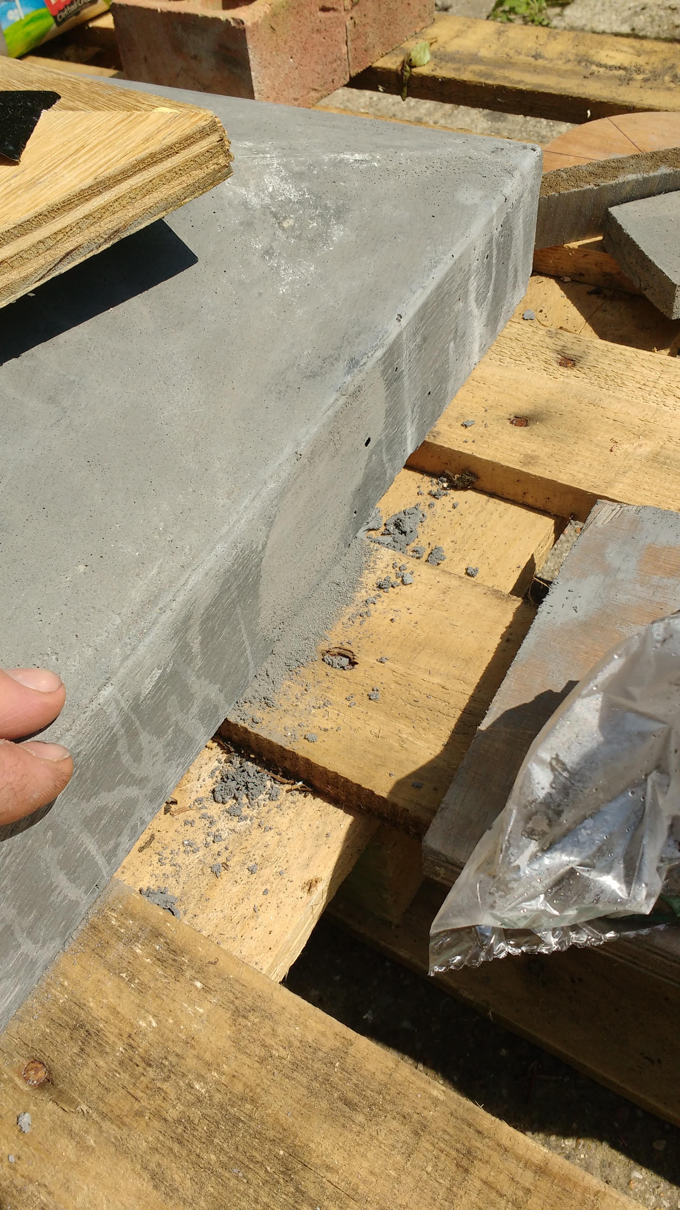

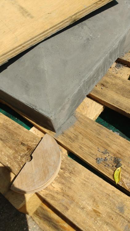

Rolled the first cap stone out onto a pallet, protecting the edge with an old towel:

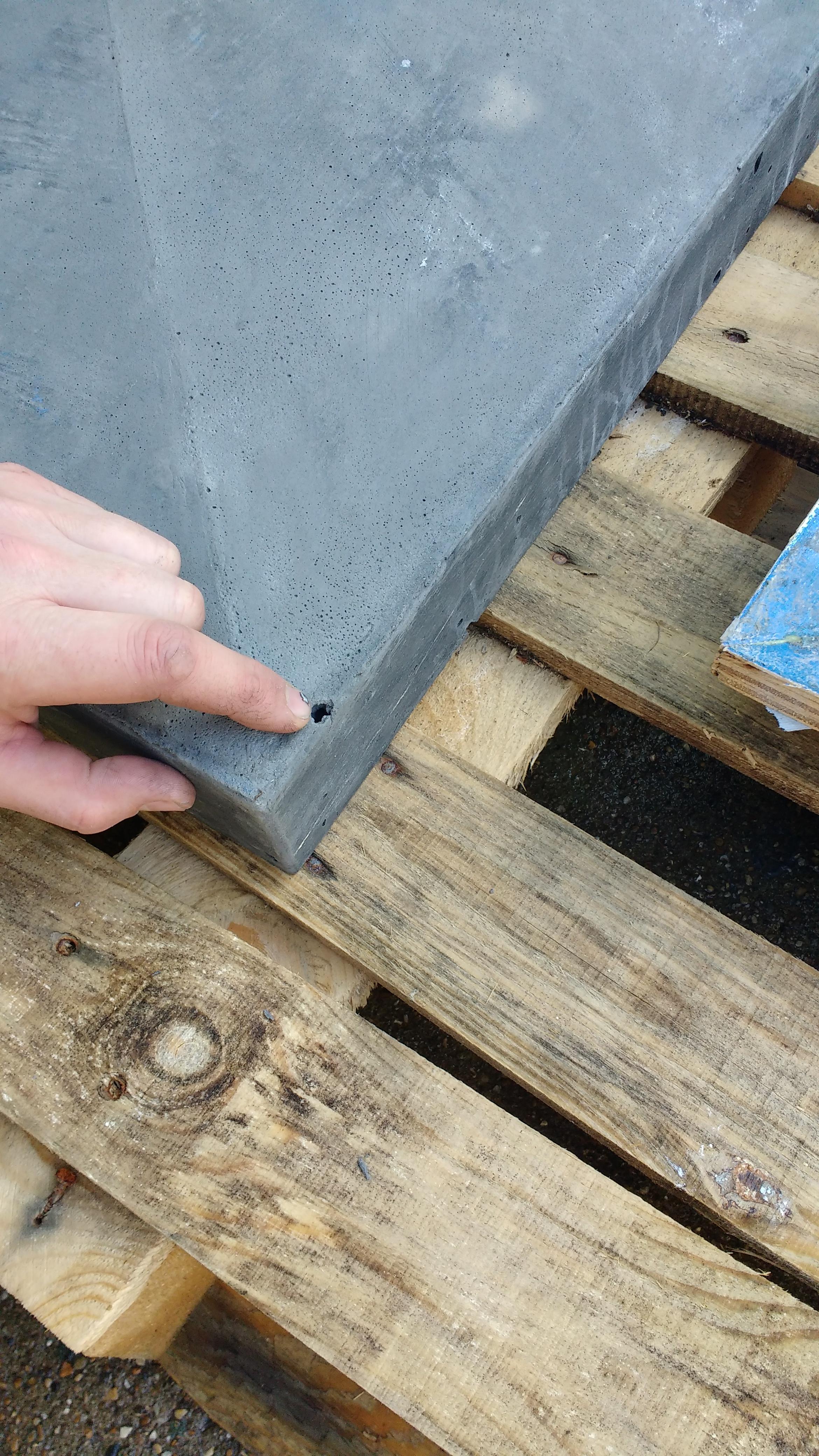

Two edges have imperfections:
For a first attempt I'm pretty happy with that.
The finished surface has a few pinholes close up. I'm a tad concerned, over time, of those being a bit of a "key" for frost action. I was going to just install this atop the brick pillar and paint with Thompson's Water Seal. Veering now towards filling those imperfections and just painting with a decent, black masonry paint. On the basis the paint will fill the pinholes. Also, if it does flake off it won't look too bad as the substrate is the dyed grey colour anyway.
For a first attempt I'm pretty happy with that. OMG is it heavy though!

I'd cast number 2 and use the leftover mix to finish no.1.    should save you half an hour and the colour match should be closer.
You could try rattling the mould on each side with a 1/2 sheet sander or DA to settle the mix half way through then end of the pour to help get the air out.
That looks great IMO. I used self level compound to fill the pinholes in stone cills i cast.
Too late! ? The small/same ratio mix came out alright imo:
I'll try an orbital sander for the next one.
Mix up a slurry and rub it in to seal the pin holes and cover the whole cap.

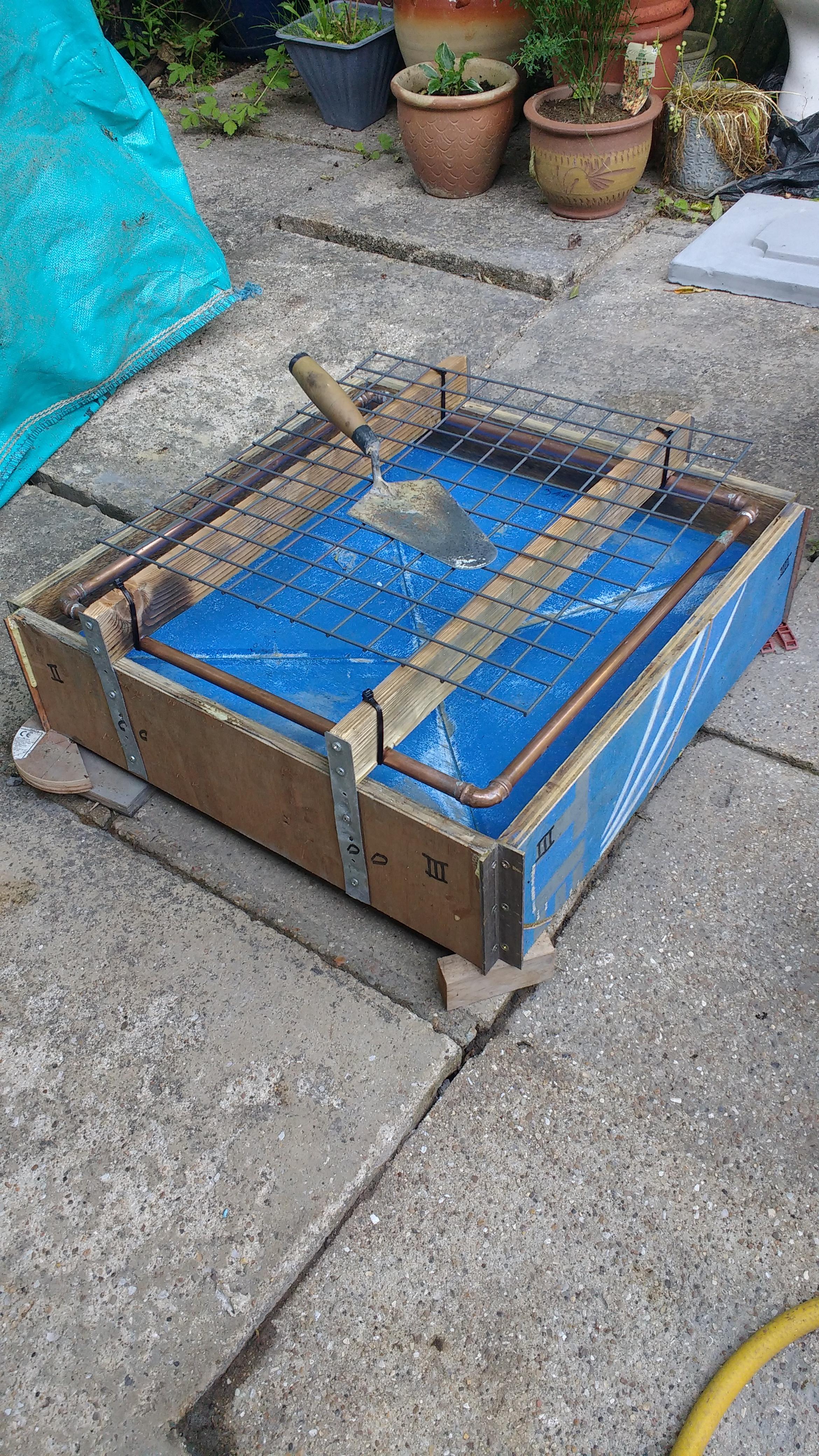

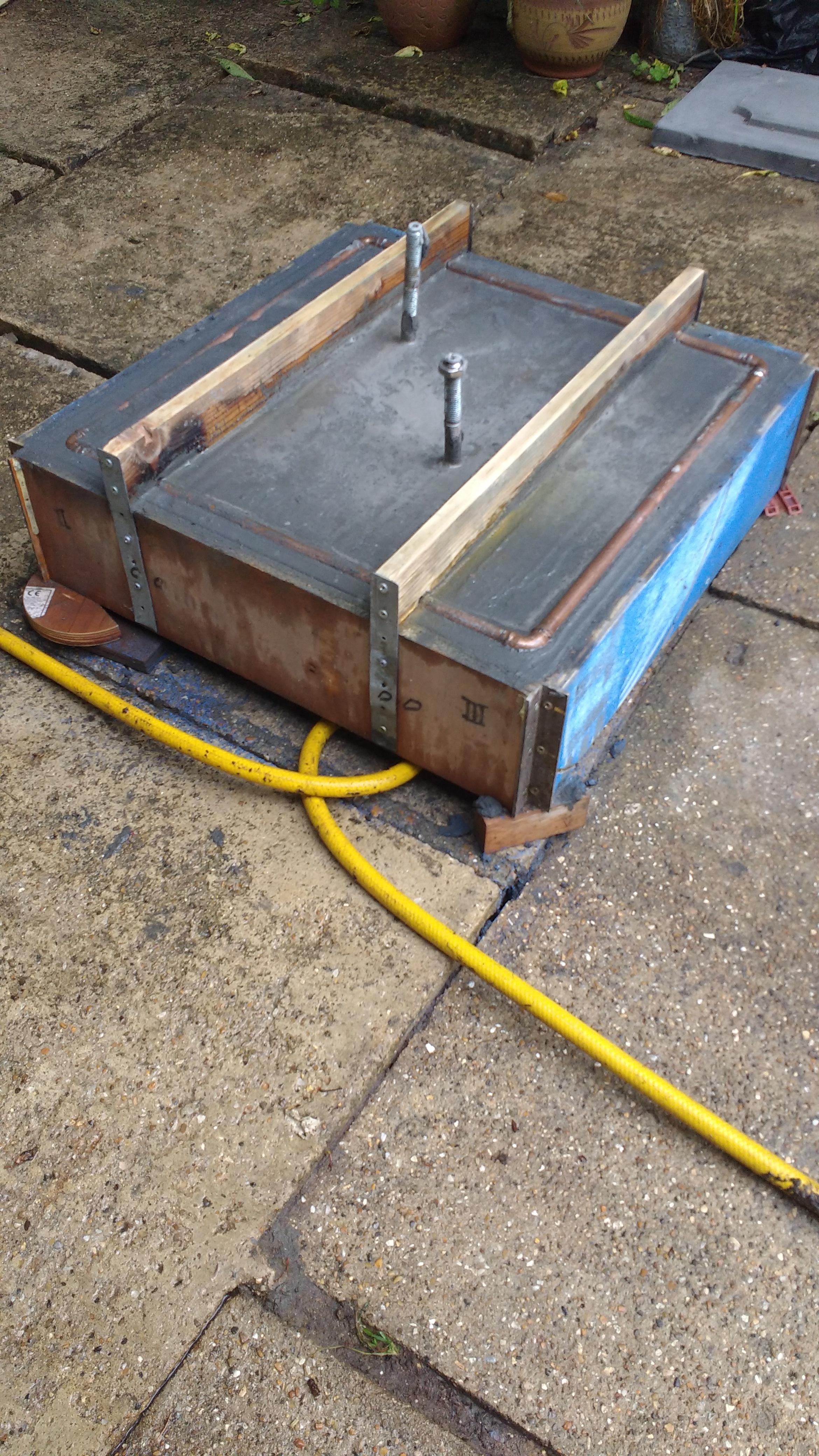

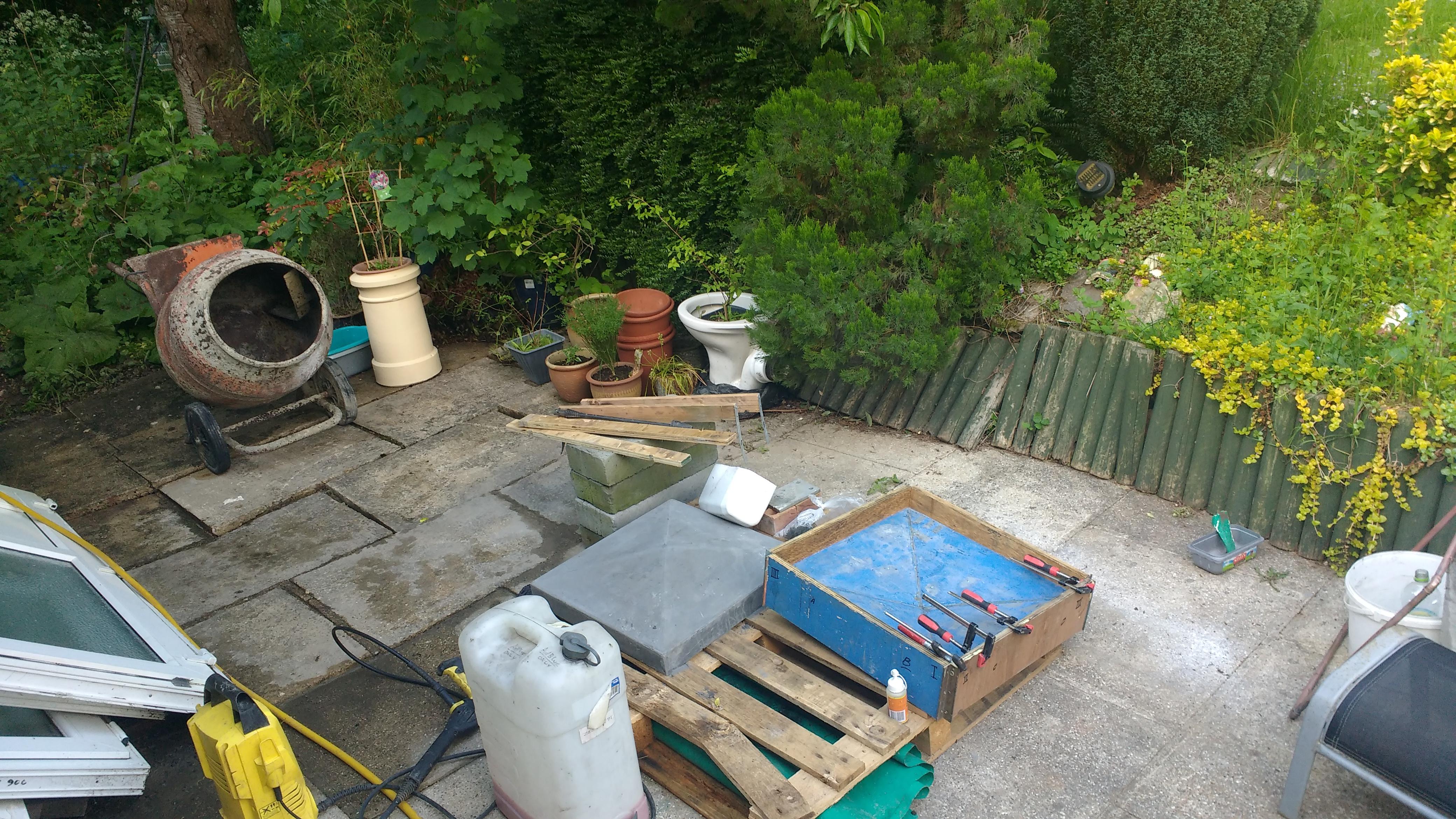

Mould under repair, (bloody cheap, 20 year old, free ply ?), ready for the next one.
Ready for the next one once the copper pipe has stuck to the cross members. Cleaned the mould out and re-siliconed the internal corners:
Found a bit of slightly bigger mesh than before, not galvanised, so gave it a quick coat of zinc spray.

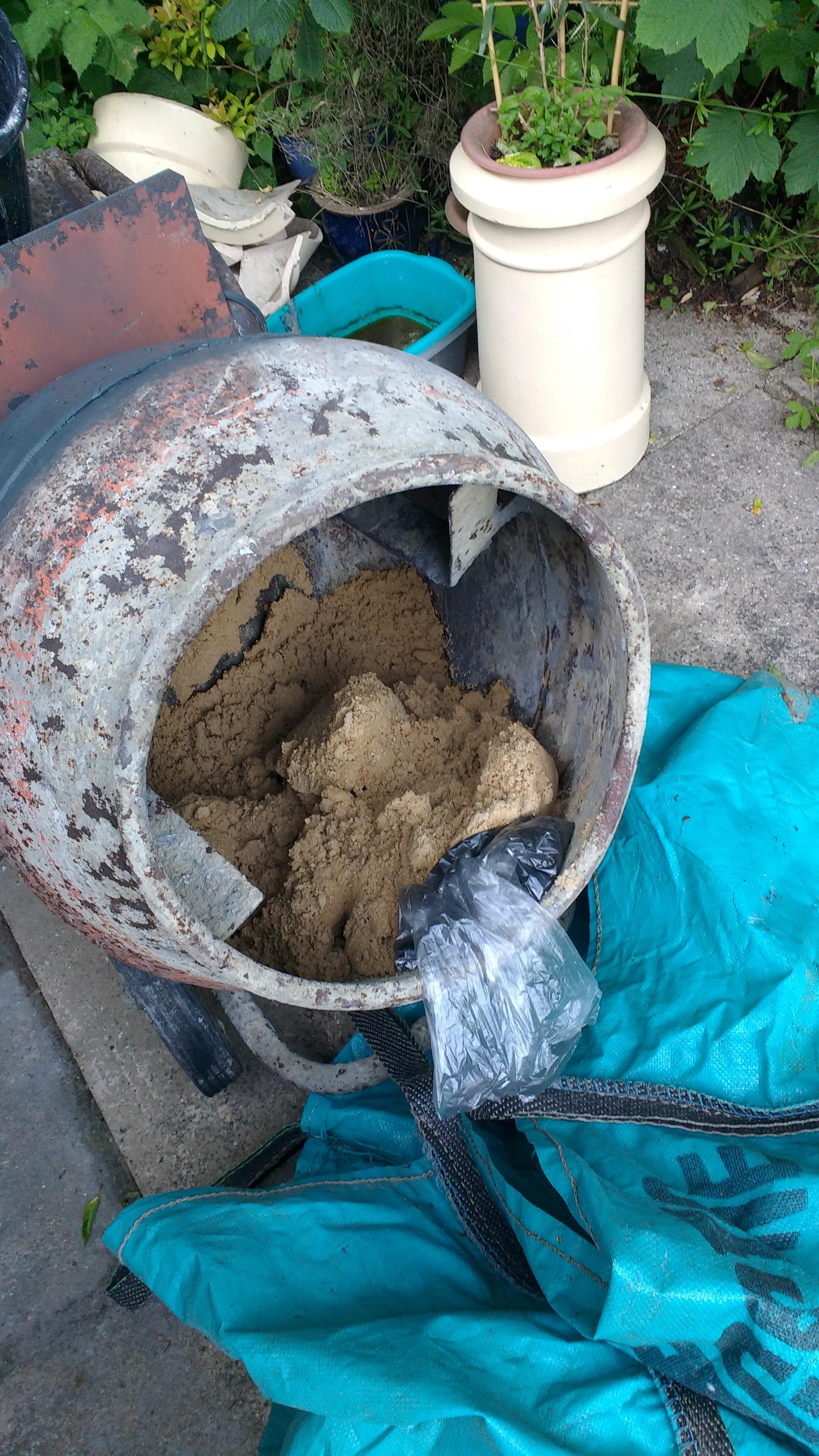

Sand and dye already in the mixer:
Cement and lime measured out ready.
Edited by Onoff

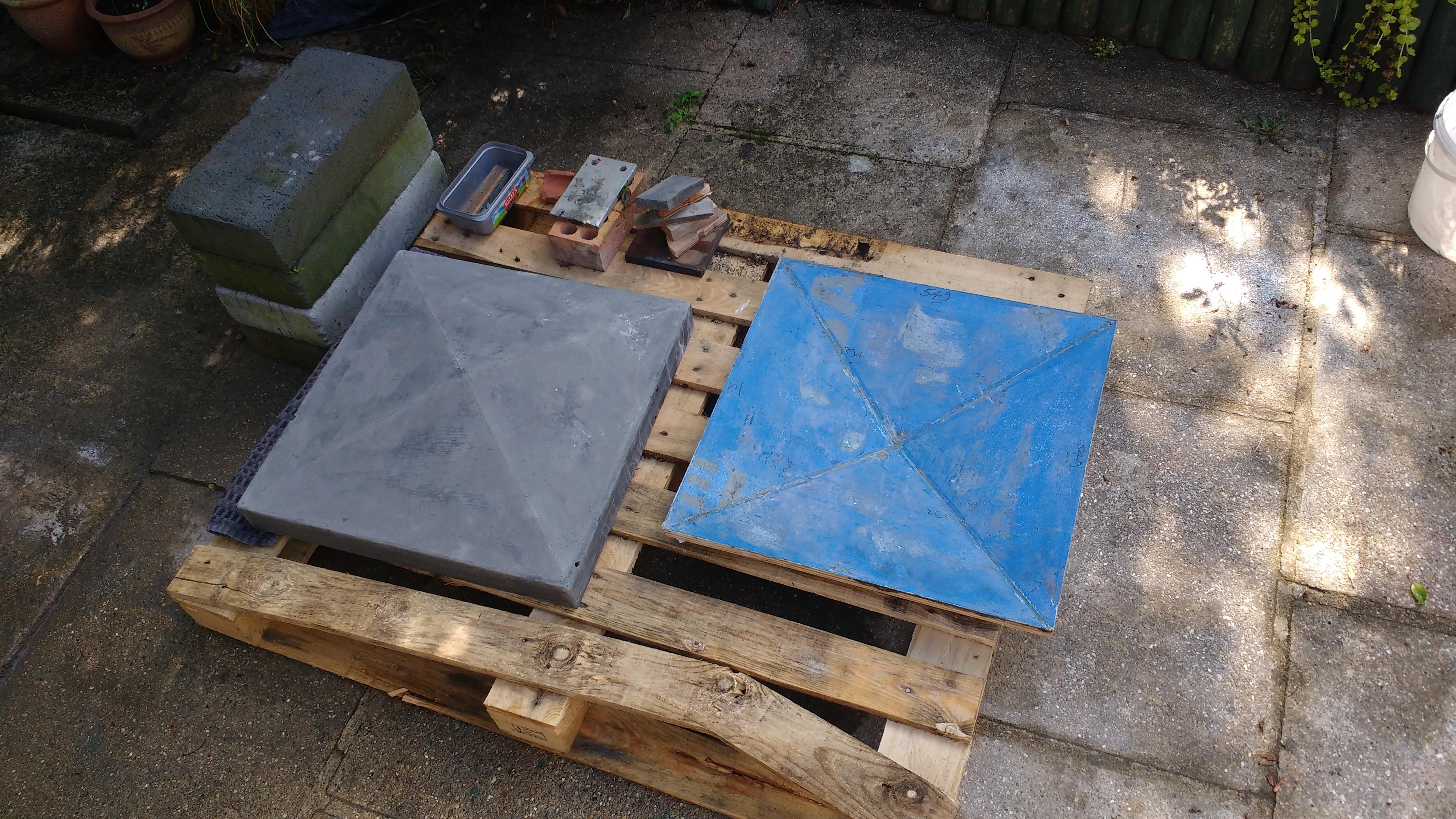

Second one done. Used the orbital sander against the sides to vibrate it down this time.
Typically I did only 75% of last time's mix (when I had too much left over) and this time was a bit short! Scraped to the sides and filled the hollow in the middle with a nom. 4:1 mix, no lime, no dye, just whatever it picked up from the drum. Was a bit sloppy tbh.
Far left corner of the copper pipe came detached from the cross timber so I think is sitting about an 1/8" too deep. I used CT1 first time round but ordinary silicone to "glue" it the the cross timber. Guess the drip channel will just be a bit deeper.
Fingers crossed!
Been waiting 14 pages for this and the pipe has sunk like the Titanic.  Jesus what a let-down!  Let us just say that @pocster may be left wanting.
To be fair I was thinking of suggesting some tabs soldered to the pipe to secure it to the timber might save curing time.
