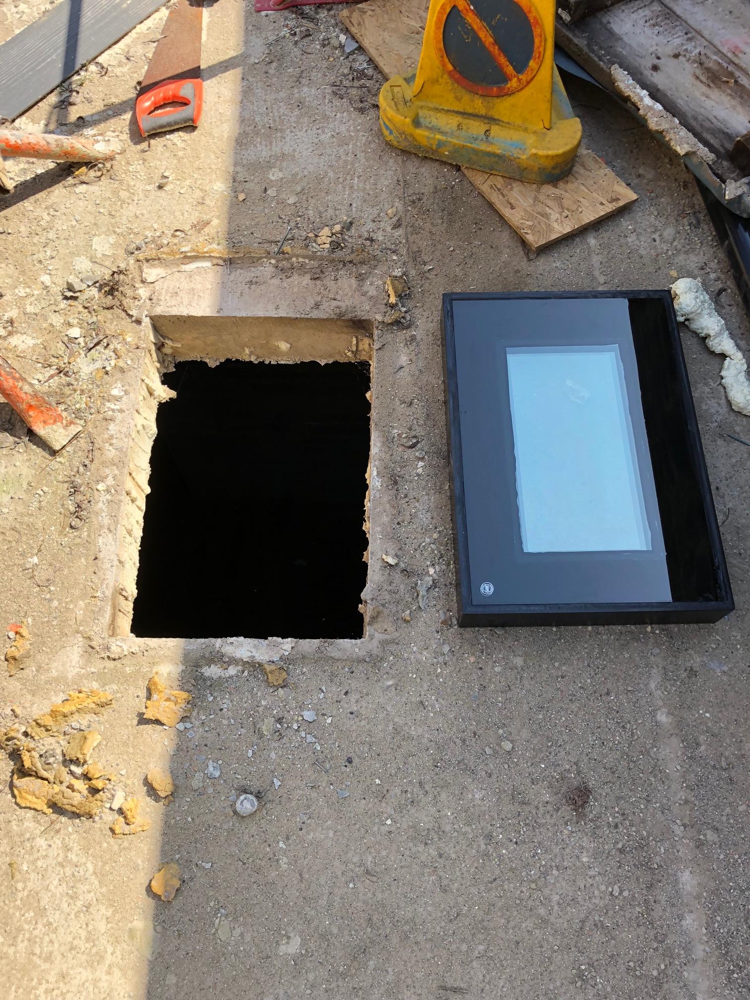

Pocster Posted April 20, 2018 Posted April 20, 2018 (edited) Oh man! Walk on glass arrived today! All along I gave dimensions of the internal opening and referenced them as 'windows'. I even signed off the drawings - showing the dimensions I thought were internal as across the whole unit! F**K!. No one at the manufacturer has got back too me - but looks like I'm at fault! - an expensive mistake...... Got 4 in total - some larger than this.... Edited April 20, 2018 by pocster

Russell griffiths Posted April 20, 2018 Posted April 20, 2018 So how much are they going to cost to re make ? would it be cheaper to alter the hole. Ive looked at it and I have a couple of ideas rattling around in my head to fix it. 1
Triassic Posted April 21, 2018 Posted April 21, 2018 Cut the frame off and Resin bond the glas straight into the concrete opening! 1
Onoff Posted April 21, 2018 Posted April 21, 2018 Floor saw? https://www.hss.com/hire/p/floor-track-saw-petrol-350mm

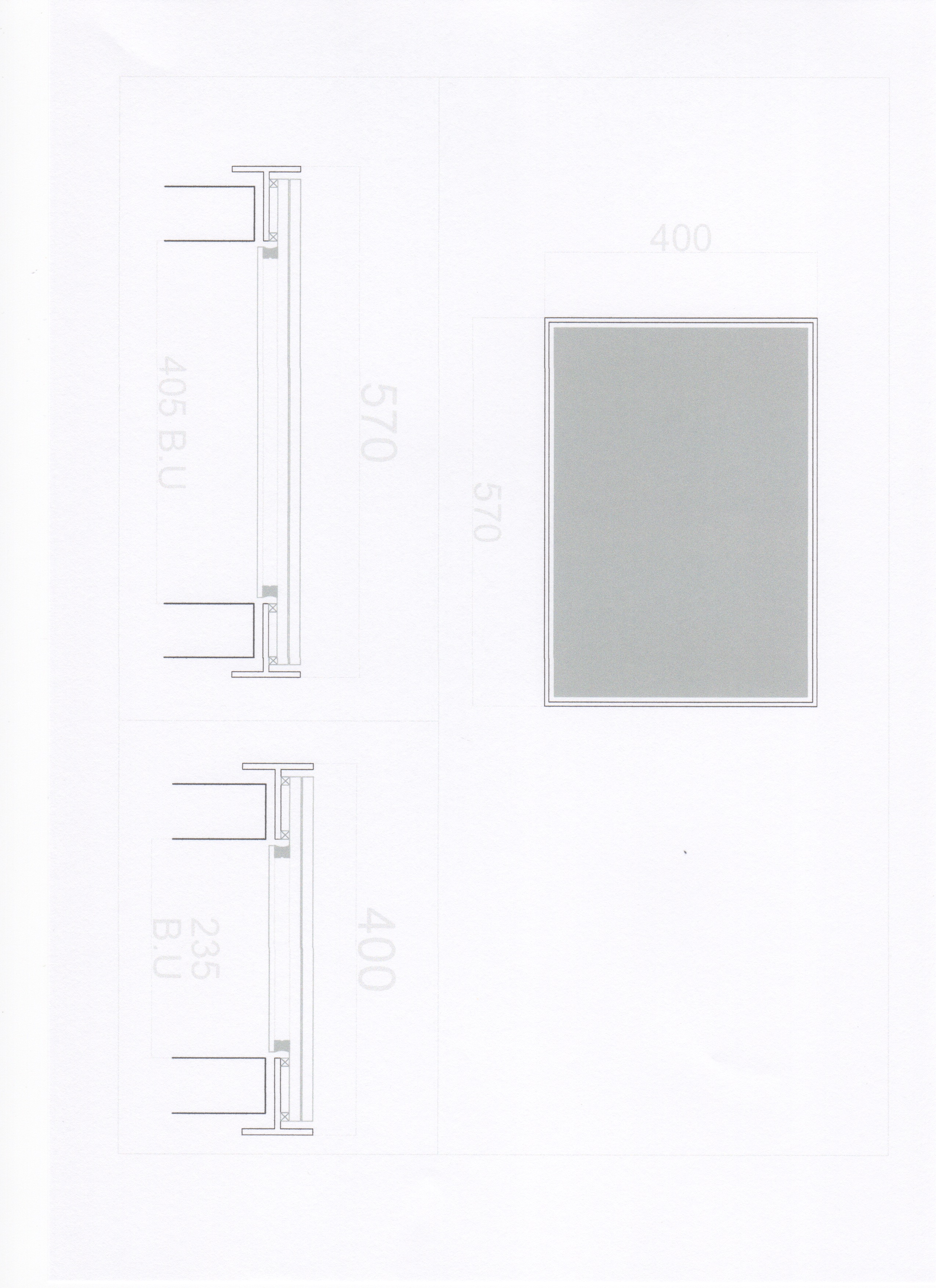

Pocster Posted April 21, 2018 Author Posted April 21, 2018 (edited) Actually.... Though I am grasping at straws here is one of the drawings - I think it's mis-leading but rather than lead you lot; can anyone see what I mean before I post what I believe the drawing should be.....????? @Onoff why an earth do I want to make the hole larger???!!! @Triassic the thick black frame is meant to sit around the openning i.e. it's the actual part that goes on the up stands. Edited April 21, 2018 by pocster
Onoff Posted April 21, 2018 Posted April 21, 2018 (edited) Sorry I thought the skylights were too BIG. So first photo...hole in slab is massively over size? The skylight on the right of the hole consists of a really thick black frame and a piddly little window in the middle? So make the hole smaller? Drill a line of holes into the slab edge, fit studs say M16 and resin anchor them in. Shutter up in ply and recast the edge of the hole. Edited April 21, 2018 by Onoff
newhome Posted April 21, 2018 Posted April 21, 2018 Overall dimensions 570 x 400 Inner dimensions (glass?) 405 x 235 But I know nowt about skylights! I think the diagram on the right is misleading however.
newhome Posted April 21, 2018 Posted April 21, 2018 If some of them are larger can you not be creative and fit those in the smaller openings somehow? Or are they not that much larger? 1
Triassic Posted April 21, 2018 Posted April 21, 2018 The drawing they’ve sent you is for an upstanding, hence the confusion. They should have send you a different drawing for it going into a hole in concrete.
