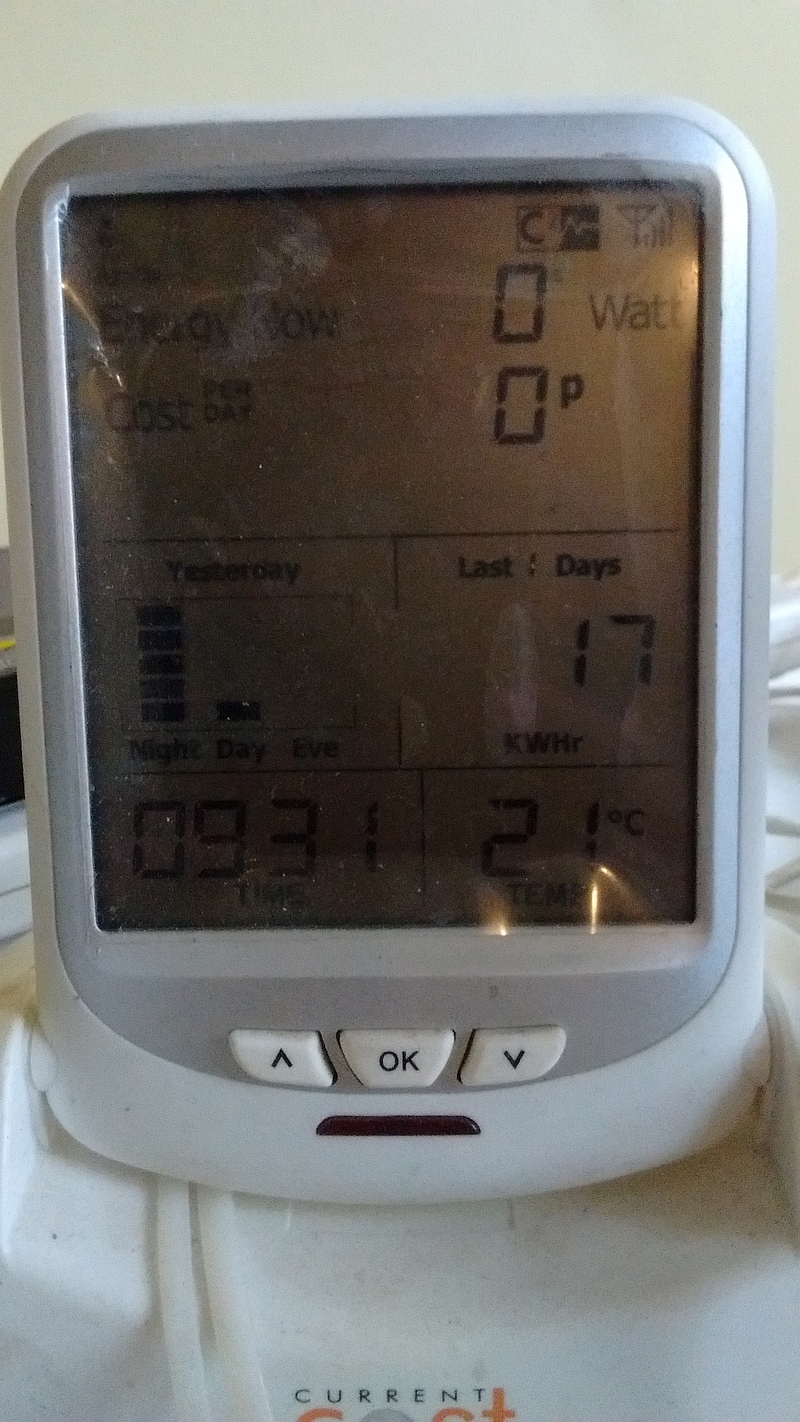

SteamyTea Posted March 27, 2018 Share Posted March 27, 2018 Just a quick update on my energy and why it is best at night. Having tinkered a bit with the temperatures of my new water cylinder and storage heater, I have reduced my daily usage by 10 kWh/day. Now it is 17 kWh/day. Yesterday my mean was 703W, during the day it was 75W and at night is was 2320W. The room temperature is now at a better 20.5°C, yesterday it was at 21.9°C, day before it was 21.7°C. Link to comment Share on other sites More sharing options...
