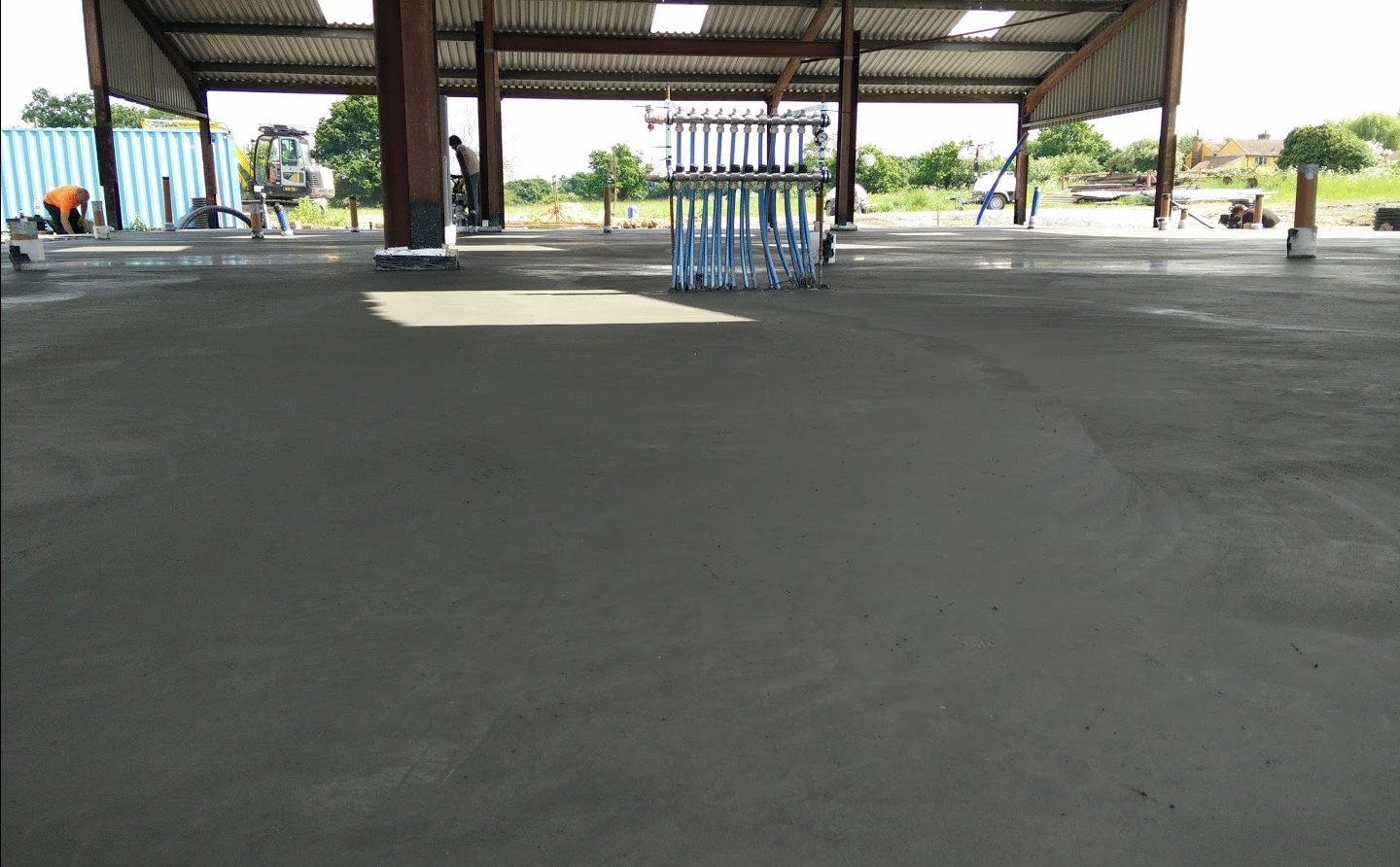

IanR Posted February 7, 2018 Share Posted February 7, 2018 (edited) 20 minutes ago, Fredd said: sorry i think you read it wrong, i meant pouring a slab and expecting it to be level is wrong. They just arnt that accurate. never are. There's quite a few here that have a different experience. Here's mine, 465m2 of C35 reinforced insulated raft, with UFH included and ready to take final floor finish. U Value: 0.1W/m2K Might be worth having a read up and update your knowledge on Insulated raft/slab foundation systems. Here's a few links, if you search Google you will find many more. http://www.advancedfoundationtechnologylimited.co.uk/our-product/ http://www.springvale.com/products/groundshield/index https://www.kore-system.com/kore-products/floor-insulation/kore-passive-slab/what-is-kore-passive-slab http://mbctimberframe.co.uk/passive-foundation/ http://www.isoquick.de/construction-process.html Edited to add: Very cost effective as well. Edited February 7, 2018 by IanR Link to comment Share on other sites More sharing options...
