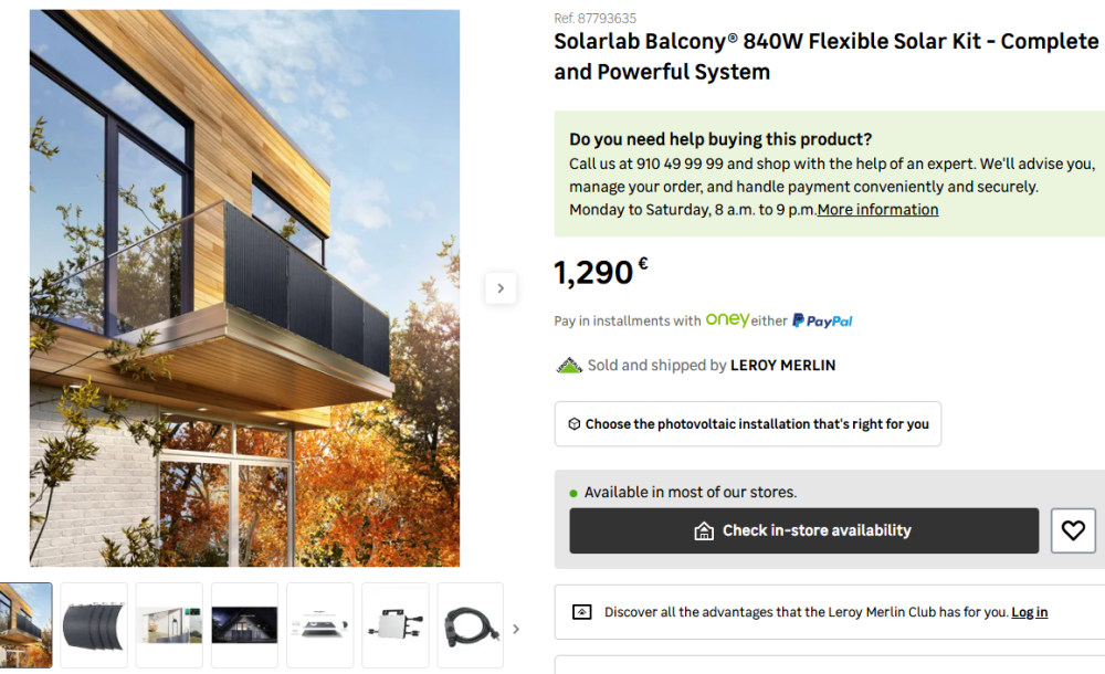

May 22May 22 I'm always researching for you all..... I went in to a Spanish diy store yesterday. Think b and q with more emphasis to trade. Eg lots of plumbing and electrics that would be from survivalists in UK. They are revamping so there was less solar to see than is on their website. But I could have bought from a big stack, a 440W balcony panel, for €449. That simple. Trolley, checkout, take home and plug in.

May 22May 22 5 hours ago, saveasteading said: I'm always researching for you all..... I went in to a Spanish diy store yesterday. Think b and q with more emphasis to trade. Eg lots of plumbing and electrics that would be from survivalists in UK. They are revamping so there was less solar to see than is on their website. But I could have bought from a big stack, a 440W balcony panel, for €449. That simple. Trolley, checkout, take home and plug in. I think you can pop into a shop over there and buy antibiotics? It doesn’t mean you can everywhere. 5 hours ago, ProDave said: So those of us with PV fitted over 10 years ago have got the "rwong" RCD's fitted. Likely yes. I know you’re also an experienced sparks, although I think retired (my old man also retired fairly recently and wouldn’t know what I was on about with this specific subject)? I’m not sure if that was a genuine question, but in case it was… As I understand it, most BS61009 devices are uni directional, unless marked otherwise. Check manufacturer’s specs. Most, if not all, BS61008 devices are bi directional, so perhaps you’re ok? BS60898 also bi directional. 21 minutes ago, JohnMo said: Ever moving goal posts - lots of new products to sell. PV has worked for decades on normal UK electrics. But now you can't do it without bidirectional and the correct armoured cable, MCS approved mount systems etc. I agree that a lot of it is total BS. However, there’s going to more than just me that’s slightly peeved if I’m not allowed to fit solar PV (and customer get paid to export) unless I spend a small fortune each year and jump through numerous hoops to be ‘MCS registered’, yet old Joe Bloggs can nip to Wickes and he’s fine to plug it into a system that isn’t safe to start with and has now been made even worse by him pushing power through devices in the wrong direction. It’s a mess. A fudge is incoming though I fear. Be interesting to see what it is.
May 22May 22 4 minutes ago, Mattg4321 said: I think you can pop into a shop over there and buy antibiotics? No. With a prescription or if the qualified pharmacist prescribes it. You can even only buy ibuprofen and paracetamol in pharmacies.
