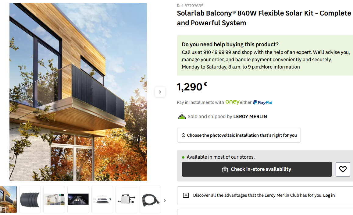

March 29Mar 29 On 24/03/2026 at 20:13, saveasteading said: That's more for an 850W system than it cost me for my original 3.68kW system. No wonder there is interest in selling this plug and play kit, it allows suppliers to charge a lot for a small system just for the users that think they are getting something special.
March 29Mar 29 1 hour ago, ProDave said: That's more for an 850W system than it cost me for my original 3.68kW system. No wonder there is interest in selling this plug and play kit, it allows suppliers to charge a lot for a small system just for the users that think they are getting something special. I was thinking similar.

March 29Mar 29 5 hours ago, ProDave said: That's more for an 850W system than it cost me for my original 3.68kW system 4 hours ago, JohnMo said: was thinking similar Mentioned this a while back about these system won't be that effective. 6 hours ago, Beelbeebub said: old style meters, they would just run backwards Very few left now, and it is illegal, was a problem 15 years ago, but most meters are changed every 20 years.
