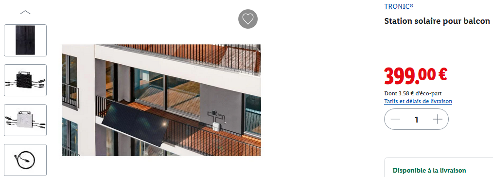

March 25Mar 25 4 hours ago, saveasteading said: In Spain you can buy this in Leroy Merlin, so like walking out of B and Q with a system Leroy Merlin have the same models here in France too. Lidl are selling an even cheaper 800W version here, though it has mixed reviews: 5 hours ago, Beelbeebub said: The Uk's electrical wiring is apparently too different and so very fragile, compared to other countries Maybe because UK RCBOs & circuit breakers are still, AFAIK, single pole (i.e. they cut only the live, not the neutral)? European circuit breakers are always double pole, which are safer than single pole under certain conditions*. So switching off the RCBO may leave all circuits with a live potential if the PV panels has been plugged into a reverse-wired socket, while the user thinks it's been isolated? *so, in Europe, there's also no need for isolating switches next to extractor fans, ovens & other fixed appliances. Edited March 25Mar 25 by Mike
