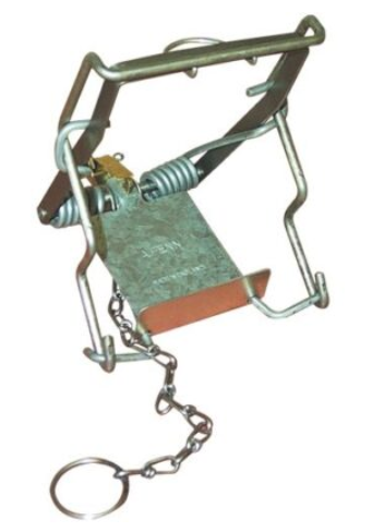

Gus Potter Posted August 22 Posted August 22 From my pheasant rearing days a Fenn trap is a satisfying solution. No nonsense, but you must protect it to stop other wildlife from detriment.
