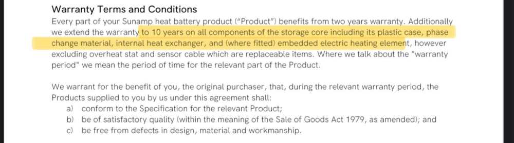

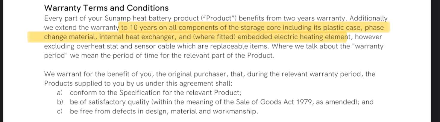

Jeremy Harris Posted yesterday at 08:07 Author Share Posted yesterday at 08:07 1 hour ago, Russdl said: @Jeremy Harris It should have a 10 year warranty on the PCM. Sunamp Warranty (pre June 2024) Many thanks, for some reason I didn't receive this with any of the paperwork that came with my unit, not sure why. All I had was an emailed invoice plus a copy of the installation instructions (which got amended once or twice IIRC). I've contacted Sunamp to check the warranty, have to see what they say. I can't honestly say I'm hopeful, TBH. Link to comment Share on other sites More sharing options...
Russdl Posted yesterday at 08:15 Share Posted yesterday at 08:15 As you had so much input to Sunamp in the early days I’d be gobsmacked if they didn’t honour the 10 year warranty, even if the paperwork isn’t quite in line. 🤞🏻 Link to comment Share on other sites More sharing options...
jack Posted yesterday at 08:36 Share Posted yesterday at 08:36 26 minutes ago, Jeremy Harris said: Many thanks, for some reason I didn't receive this with any of the paperwork that came with my unit, not sure why. All I had was an emailed invoice plus a copy of the installation instructions (which got amended once or twice IIRC). I've contacted Sunamp to check the warranty, have to see what they say. I can't honestly say I'm hopeful, TBH. I know you were very early Jeremy (possibly even before full production had ramped up?) Is it possible your purchase pre-dated the 10 year warranty? 1 Link to comment Share on other sites More sharing options...

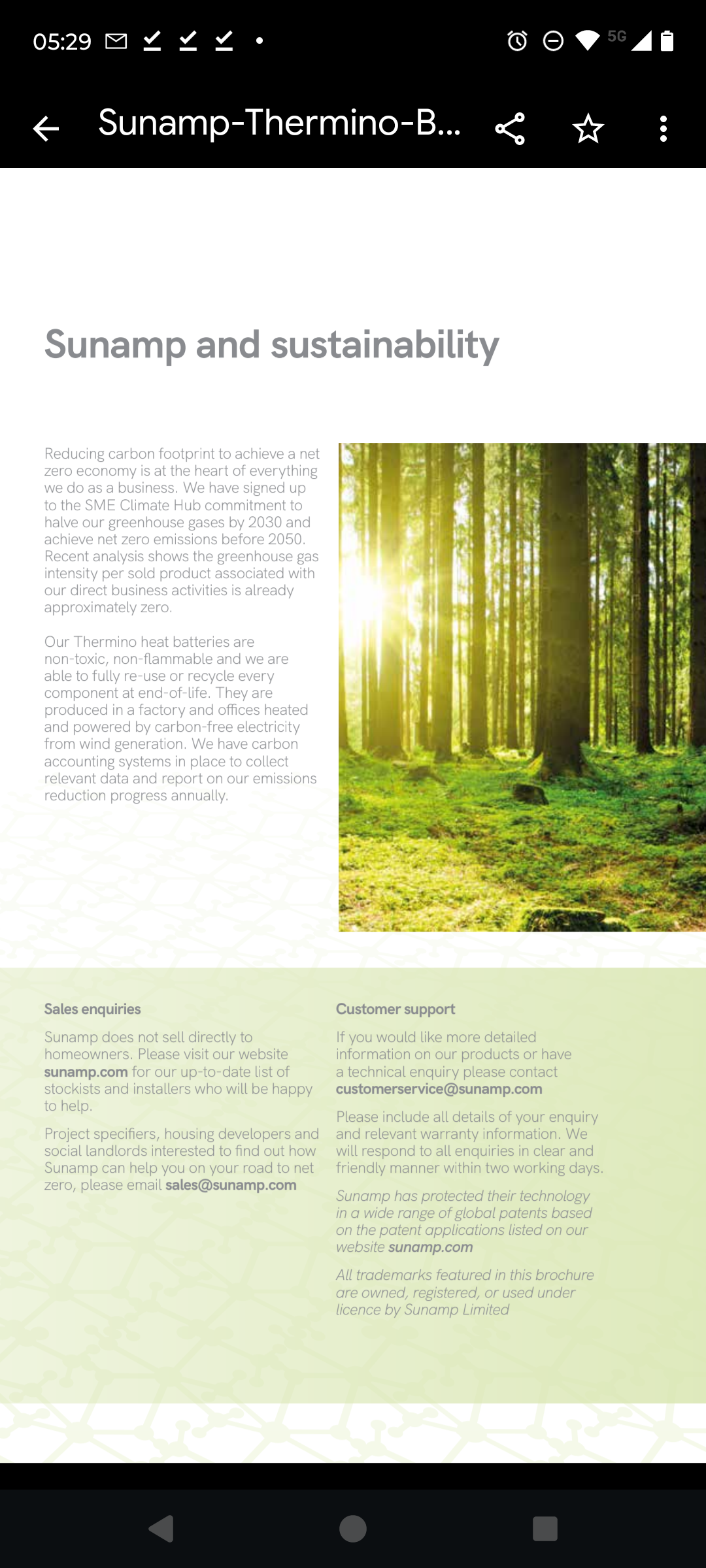

Onoff Posted yesterday at 09:09 Share Posted yesterday at 09:09 Sunamp-Thermino-Brochure-JUNE-2022-v2.2 (1).pdfIs the PCM in your "original" unit perhaps different to what's in their current Thermino range? PDF attached. Be interesting on how many similar failures they've had and whether the containment is fit for purpose. Imaging it splitting over a kid's room / cot. Link to comment Share on other sites More sharing options...

Jeremy Harris Posted 23 hours ago Author Share Posted 23 hours ago 27 minutes ago, Onoff said: Sunamp-Thermino-Brochure-JUNE-2022-v2.2 (1).pdfIs the PCM in your "original" unit perhaps different to what's in their current Thermino range? PDF attached. Be interesting on how many similar failures they've had and whether the containment is fit for purpose. Imaging it splitting over a kid's room / cot. I don't think so, but there is a massive amount of marketing BS from Sunamp regarding the naming of this stuff. It's almost certainly just sodium acetate trihydrate, as everything about is is a perfect match for that compound. Same melting point (58°C), same safety assurance, the stuff even tastes the same (don't ask me how I now know that!). They originally gave it some daft name to try and make it it was some sort of magic compound and it seems they've now taken to calling it "Plentigrade", almost certainly just for marketing reasons. The main difference between my UniQ and the newer Thermino is that they've done some cost engineering work on it. The case is the same size and design, but they've integrated the control circuit board inside the top of the case, rather than as a separate wall mounted box. Looking at videos of the two that seems to be the only major difference. They've chosen to address the problem I had with the original controller, where it wasn't well suited to charging from excess PV generation, by adding a plug in "key" that changes the programme parameters. Before they did this by having a different control box for PV (I had to swap out the original because of this). Link to comment Share on other sites More sharing options...
Jeremy Harris Posted 23 hours ago Author Share Posted 23 hours ago Major news!!! Guess what? Sunamp have just emailed me to say that they are going to replace our unit as it is covered by the 10 year warranty on the core! They emailed me as I was typing the reply above. 13 Link to comment Share on other sites More sharing options...

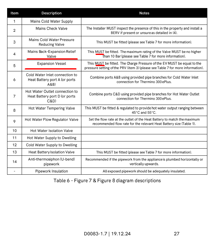

ProDave Posted 20 hours ago Share Posted 20 hours ago Excellent news Jeremy. The 0.5L expansion vessel you mention seems tiny? What is that for? That won't take up much expansion of hot water. Compare that to something like a 25L expansion vessel on a typical UVC and even the closed UFH circuit in our house has something like a 10L expansion vessel. 1 Link to comment Share on other sites More sharing options...

Jeremy Harris Posted 20 hours ago Author Share Posted 20 hours ago 8 minutes ago, ProDave said: Excellent news Jeremy. The 0.5L expansion vessel you mention seems tiny? What is that for? That won't take up much expansion of hot water. Compare that to something like a 25L expansion vessel on a typical UVC and even the closed UFH circuit in our house has something like a 10L expansion vessel. I can't be certain, but I'm convinced that it's a shock arrestor there to lessen the effect when a tap is suddenly closed. This seems to be more of an issue with ceramic tap inserts, that can close off the supply very quickly. Certainly I have occasionally heard a slight thump when shutting off our shower, probably because the location of it and the 90 deg turn off angle make it very easy to shut it off near-instantly. What I imagine happens is that the water is merrily whizzing down the pipe, the valve gets suddenly closed and that column of moving water in the pipe has no where to go, so bounces back as a shock wave. I can't believe that it's just there to deal with expansion in the internal pipes as the unit heats up, not least because the volume of water inside the thing is very small, plus the pipe work will be able to absorb a small increase, especially homes like ours with plastic piping. I'm sure that can tolerate a small amount of expansion, which makes me more convinced that this is really a shock arrestor. Link to comment Share on other sites More sharing options...
Jeremy Harris Posted 19 hours ago Author Share Posted 19 hours ago 1 hour ago, Kelvin said: It’s like a scene from Alien. Good news and well done Sun Amp. However, such a catastrophic failure is either a design flaw or a manufacturing flaw. I suspect it's a bit of both. If I'm right about the cause being related to stresses imposed on the heat exchanger from short duration high pressure events then there is a pretty good chance that this may be something that only happens with some installations, the exact circumstances of which may not have been simulated during all the extensive testing done during the design stage. I know their testing was pretty thorough, from conversations with one of their technical people, but it must be impossible to test for every possible installation condition, and being a relatively new company it may well be that they didn't have a secret stash of hard won experience to call on. Link to comment Share on other sites More sharing options...
