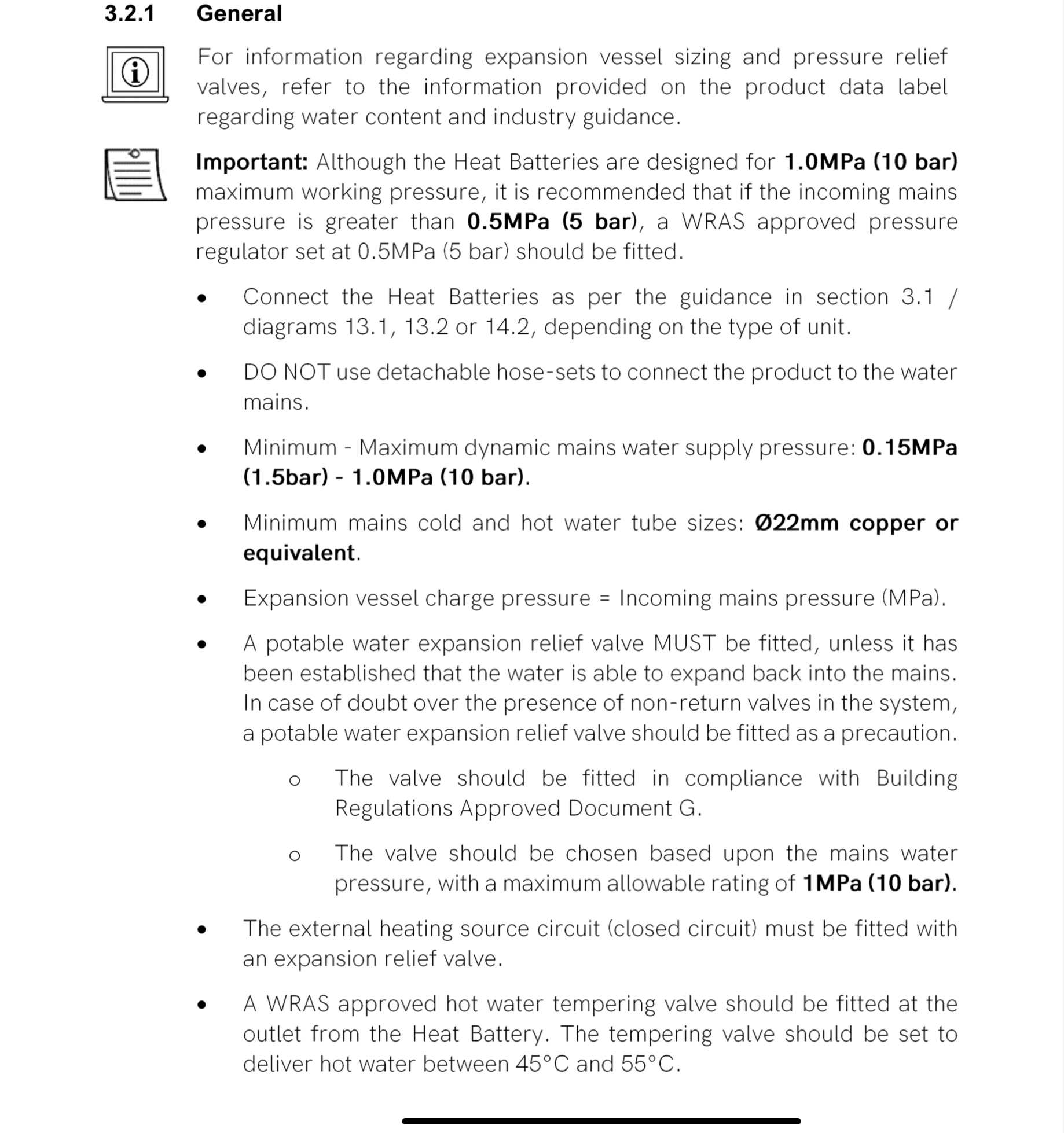

Regarding the new requirement for a cold water PRV at 6 bar, in our case this is a bit of a nonsense requirement if it is intended to protect against the static cold water pressure exceeding 6 bar, simply because our well pump could never achieve that, even if the pressure switch were to fail and keep it turned on.  I'm sure they will fit one, given that it's now a requirement, but I'm not going to be overly worried about it ever operating, TBH.  I still have the drain and tundish from when the Sunamp PV was installed, so that can be re-used.  It's easily visible, so I can check it regularly to see if there is ever a leak.

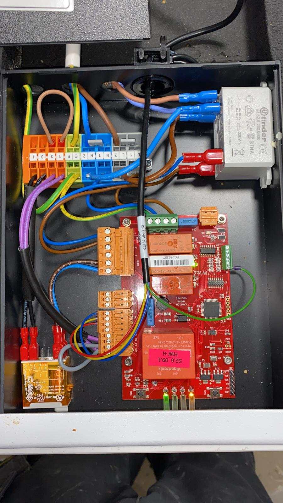

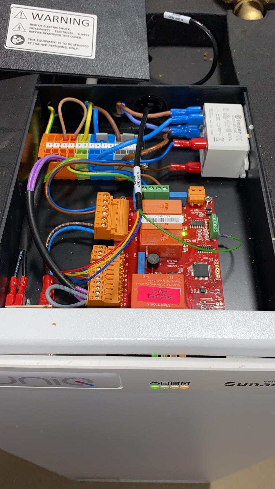

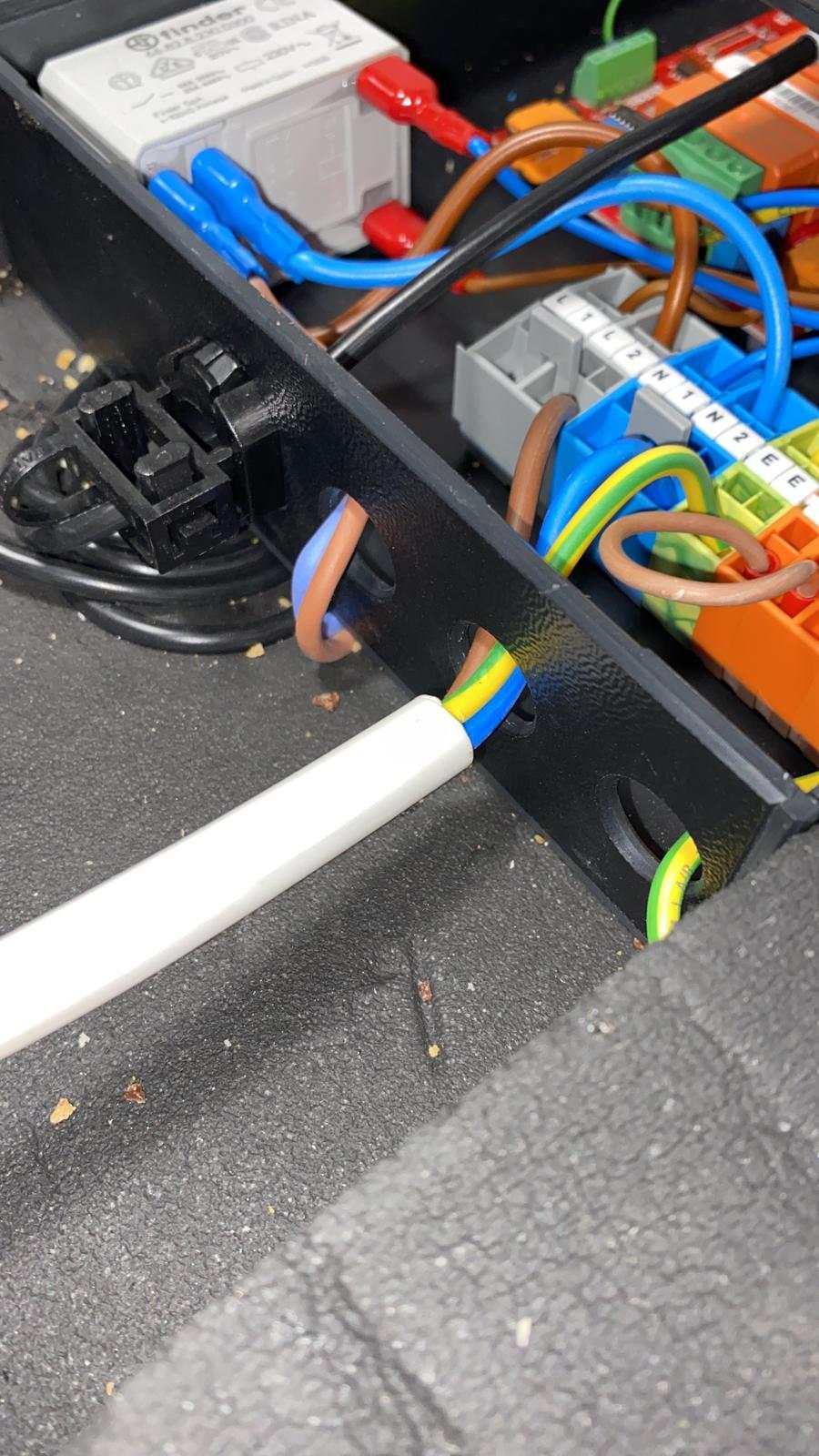

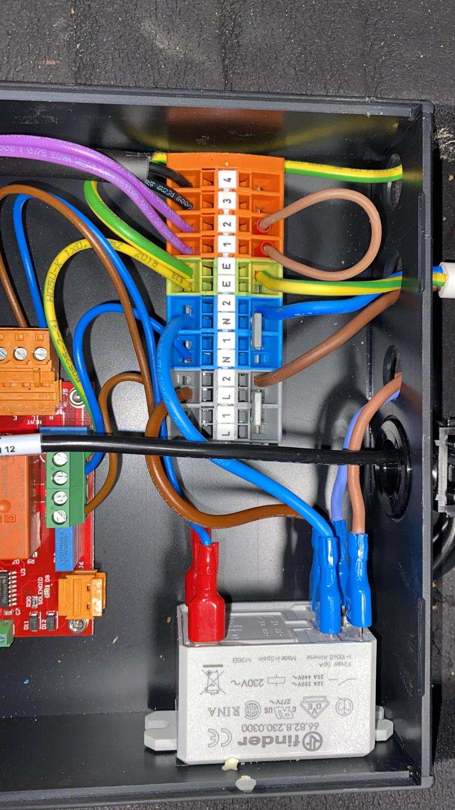

For the benefit of others, yes.

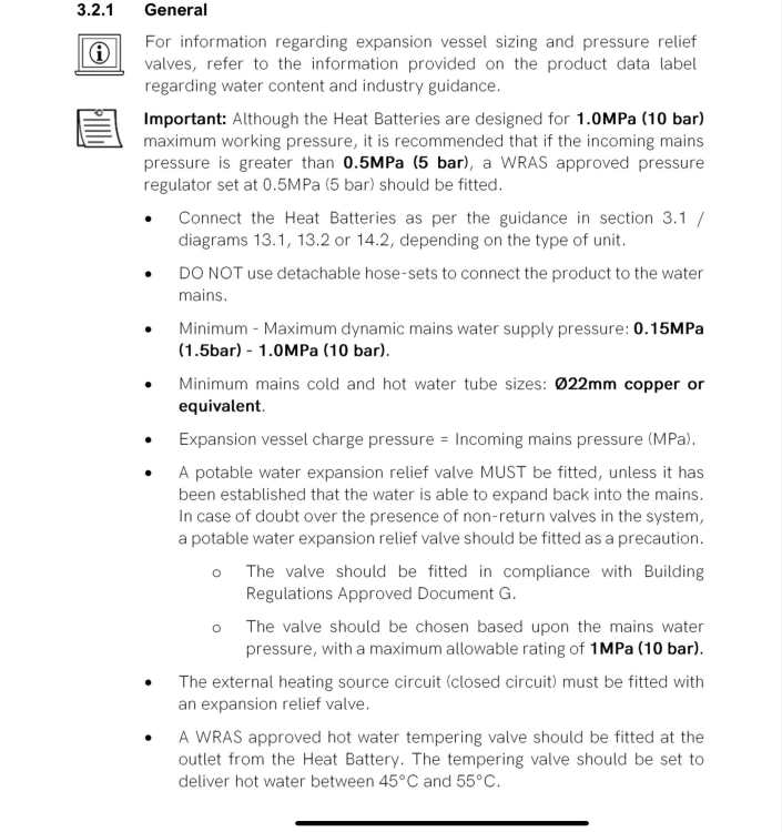

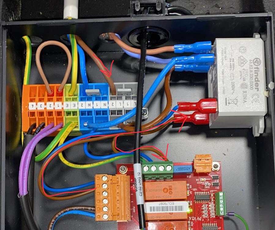

Looks like Edward Scissorhands did this when fecking hungover and riding on a waltzer. Horrific discovery was made when I was connecting the wiring up on the replacement units.
If you follow the red arrow, the larger supply cable is the main feed at full 20a potential from the 20a DP switch. Then you see that tapped off by the small grey link between L and 1, without a fuse, to power up the PCB, relays, and circuitry. This means the rest of the live feed to the PCB has the full 20a potential but with smaller cabling and copper printed tracks / components etc which all have far lesser current rating.
Then feast your eyes on the blue and brown single PVC cables exiting the box via the top right-most exit; these are the switched 20a feeds to the immersion at the bottom of the unit which are without the second PVC sheath and appear to be without containment all the way down and through the metal chassis. Even my crap Ariston combi has PVC/PVC 230v cabling throughout, outside the containment of the box that the PCB resides within. Note the incoming cable for the 20a mains feed is PVC/PVC, white outer sheathed one, for comparison.
Further note the lack of any cable entry glands etc, just shocking tbf…. :/

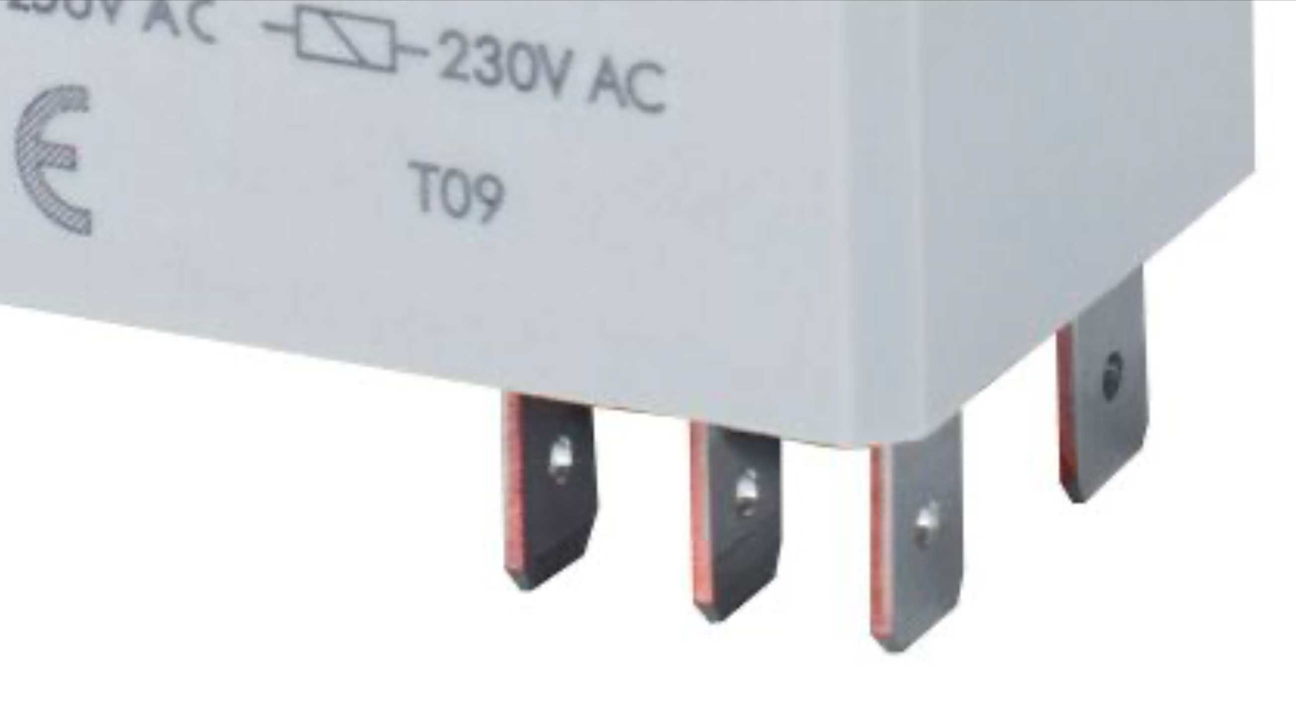

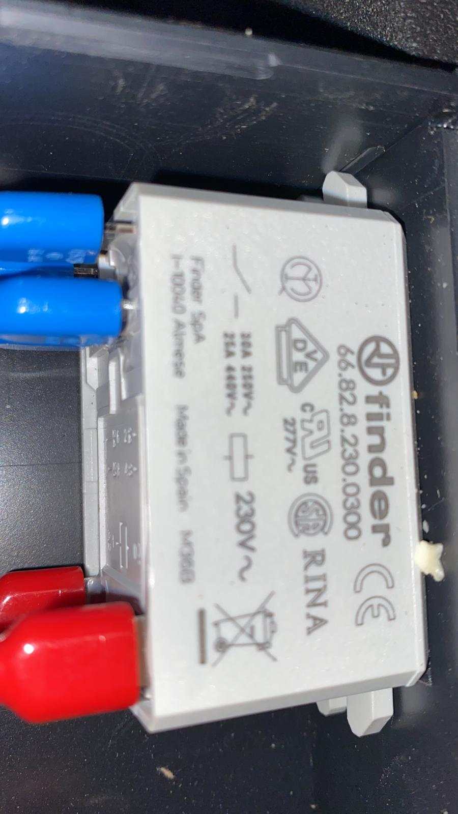

Then on the two spade connectors on the relay, the ones feeding the immersion, they’ve not been pushed onto the relay terminals like the others. I thought this was because those two terminals may have been different and stuck out further, but no. Just installed with the same fineness as the rest of it. See pic for clarity.
These were replacement SA units provided to swap out 3 failed units (which left the client without hot water in a £4m home) and to thus (attempt) to allow us to restore the customers faith in the product. One would think these would have got some white-glove treatment at the least(!) but instead they gave them to the 1st year apprentices to slap together…. Faith was not restored after I left and issues began to arise with the replacements….

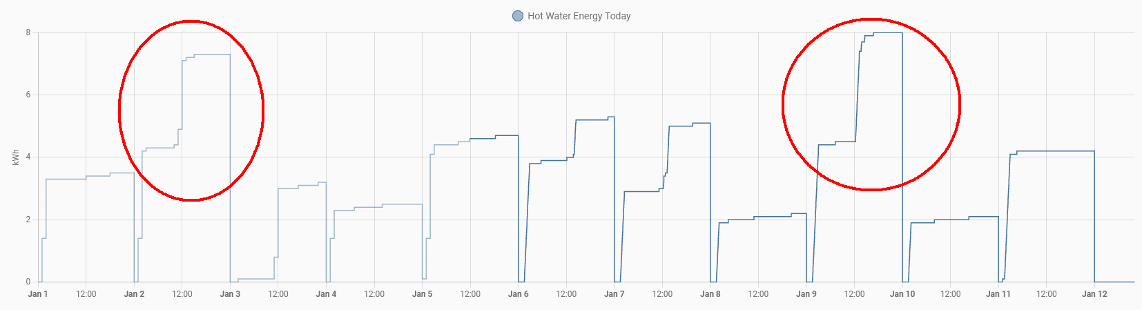

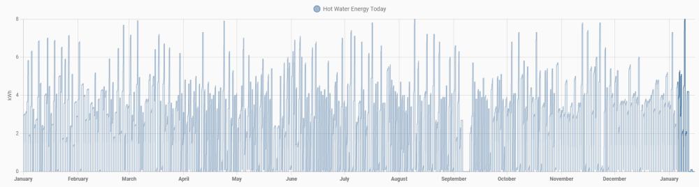

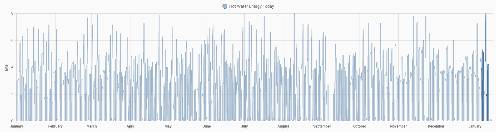

I've just been back through over a years worth of energy data for the Sunamp, back to 1st January 2024, to see if I could spot a pattern of the energy use having increased, perhaps due to the heating element staying on longer, as per the sensor string displacement theory.  As well as just pulling graphical data from Home Assistant I've also downloaded the data as a csv file to play around with the numbers in more detail, to try and see if there is a trend that's developed.  Despite my earlier excitement when I found two higher energy usage days this month, it seems they were not at all unusual, the pattern of energy use seems pretty consistent and it just so happens that on some days more charge is needed than others, almost certainly just down to the vagaries of putting the data into 24 hour hour daily bins, from 00:00 to 23:59 each day.
The reason for this seems to be down to how much solar charge there has been.  On days when there's been solar charge, but when there has also been an overnight off-peak charge which was partially used by the morning showers,  the hot water energy seems higher, because the Sunamp is getting two lots of charging in that 24 hour period.  This is definitely what happened on 9th January, the Sunamp was charged overnight from off-peak, partially discharged by two showers that morning, then partially re-charged from solar during the day.  This is the whole year energy per day plot:

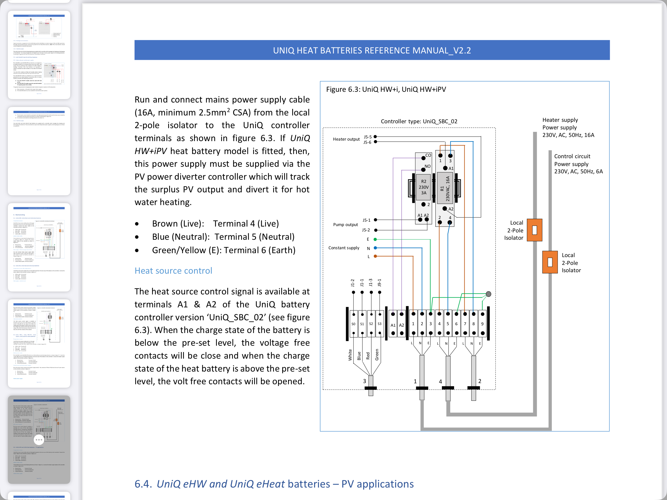

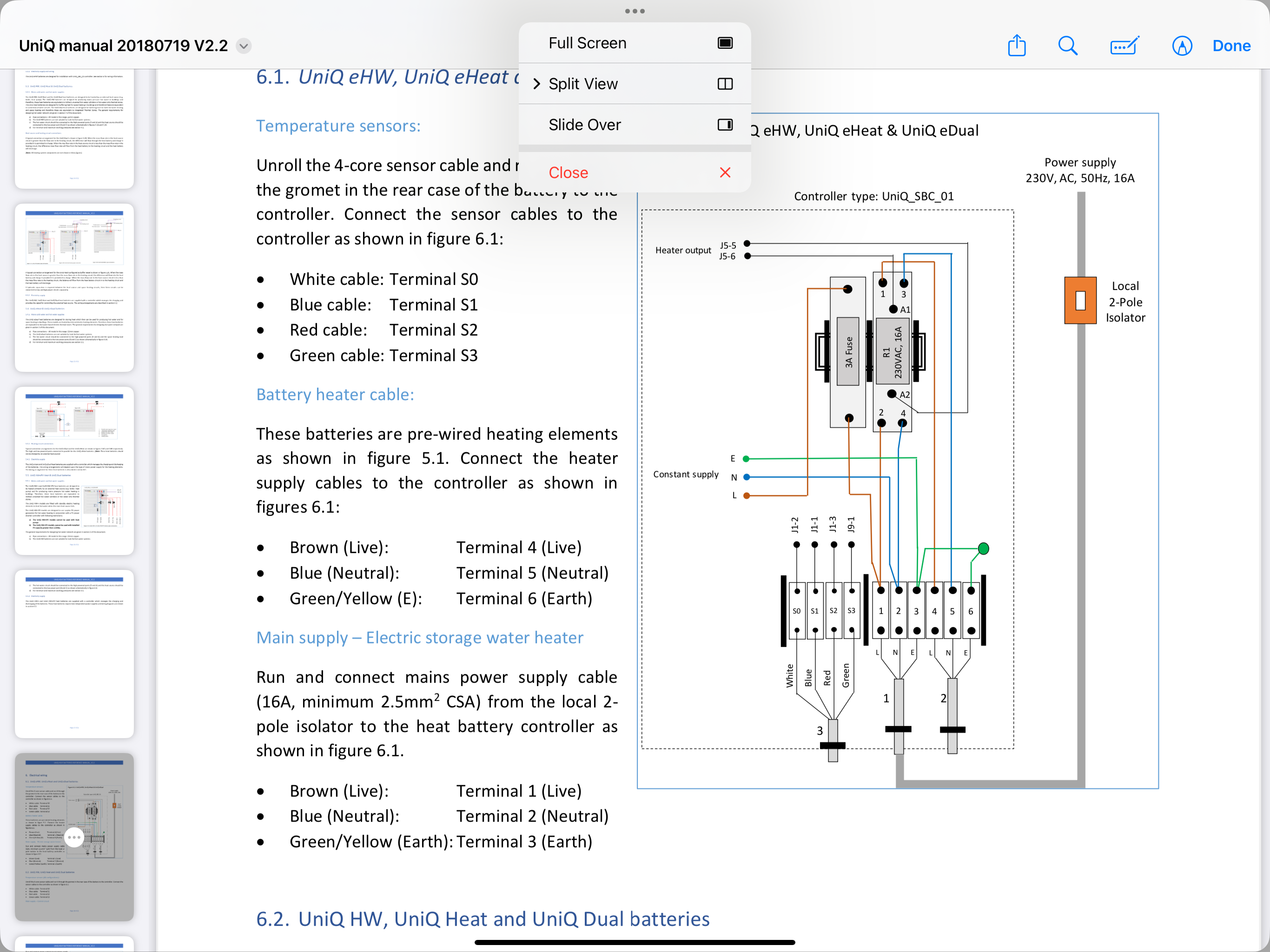

@Nickfromwales,
One thing I've spotted in the Thermino MIs is that there is no over current protection mandated for the 0.75mm² always-on cable for the electronics, nor is there any cable length limit specified.  They show the 0.75mm² cable fed directly from a 16A, perhaps 20A, protected supply, which is not a great idea.  If there is an internal fuse then this might be allowable under the "3m back fusing" rule, but if there is no internal fuse, or if that 0.75mm² cable is over 3m long, then it's a clear breach of the regs.
In our case I chose to feed the 0.75mm² cable to the UniQ control box via a 13A plug fitted with a 3A fuse, specifically to protect this cable, only because there was no mention of cable protection in the early draft of the MIs I had.  This same cable can be used for its replacement, as it plugs into an outlet that's fed from the HW DP isolator and 16A RCBO.

Completely understand that their own MI’s can be in the gutter, no argument from me there.
The MI’s may state 16a and that may be the case, thank you for pointing this out. 16a on printed copper PCB is not what I’d want in my product though.
For comparison, every combi boiler I’ve ever worked on has had a fuse before the on board electronics, to de-rate the current available via the always-on electronics etc. Usually this is a 1a quick blow fuse.
Clearly you felt this was inadequate, as you say you took it upon yourself to introduced your own DIy fuse protection.

I agree, Nick, IMHO it's not enough to assume that the installer will realise that the requirements of BS7671:2018 take precedence over the MIs, the MIs should really stipulate that this 0.75mm² must have over-current protection with a rating of no more than 6A (the normal max rating for this size flex).  It's no problem if there's a switched fuse or 13A outlet available to just fit a 3A fuse to protect this cable, just in case.  I did this simply because common sense mandated that protection was needed.
Agreed, and ironic that Sunamp had these specifically set out in the MI’s for the UniQ’s with external wall-mounted controls! They were all installed with one 16a supply and one 3a (IIRC) supply, separating the current availability accordingly on the predecessor to the Thermino. Same PCB’s give or take, but just seems this safety consideration has just been deleted. Bean counting strikes again, I expect.
6a is fine, as long as all the PCB and associated components are all rated at 6a min or above, just strange that these were deemed only suitable to be connected to a reduced current supply by SA previously….

Interesting that, as the first copy of the UniQ MIs I have don't mention the fuse for the always-on supply, but the second version sort of does (right at the very end)!  Mind you, the documents I had for the UniQ were pretty much all drafts, I believe, rather than the final version that accompanied the product.   Given it was such a simple thing to install I never really gave it much thought, TBH, especially as I'd spent a fair bit of time on the phone with their (very helpful) technical chap, discussing the installation.
There were so many different manuals flying around back then even SA were sending the wrong MI’s out with units delivered to customers homes. I found one email with a historic manual:
IMG_0048.thumb.png.a99c0f1d3059dc3acaf181e15906a694.pngIMG_0050.thumb.png.c94561036f1b7a72905ec78c0df5765c.png
Top image shows the originally featured (obligatory) 3a fuse integral of the original units, titled “constant supply”, the one servicing the PCB etc, with other versions showing an external secondary supply dedicated to “control circuit power supply”, but at 6a. Here’s 2 shovels, take your pick…
That's two versions later than the last PDF I had.  The version I had (just after I had installed the thing) was V2.0.  I think the one I worked to initially may have been V1.7, maybe V1.8, can't be 100% sure as I made a point of deleting all the earlier drafts in case I opened the wrong one by mistake!

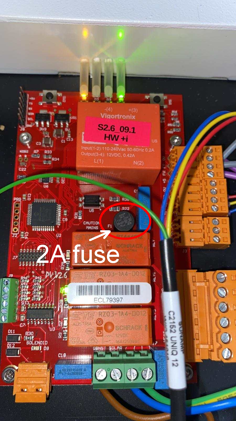

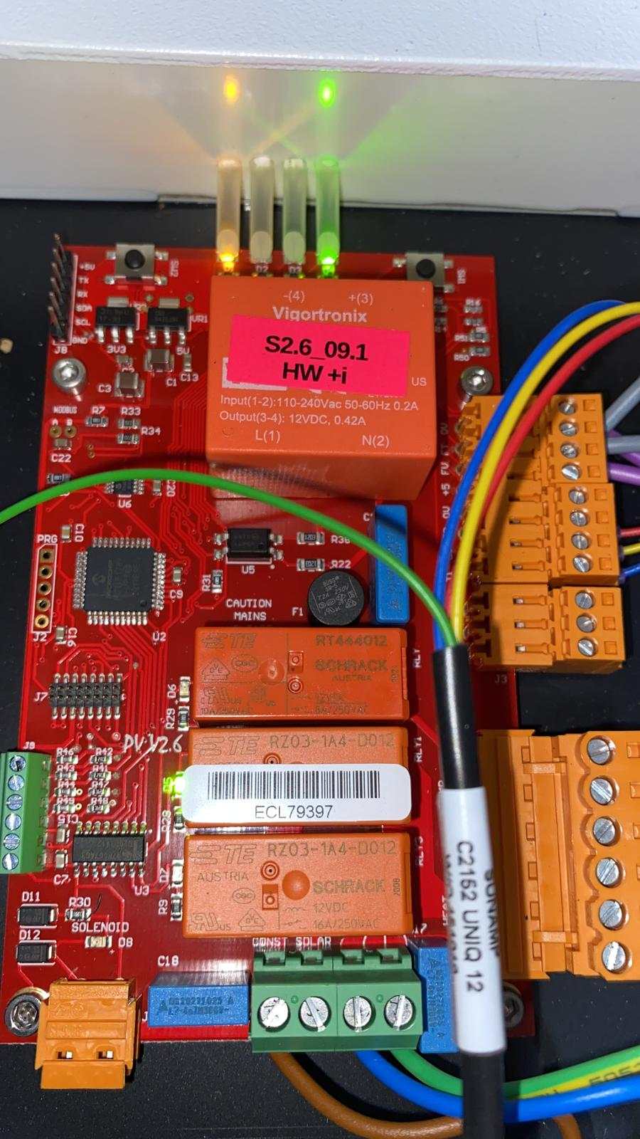

I've had a look inside our UniQ control box and it does have a 2A fuse on the incoming supply to the PCB, as does the board in your photo, @Nickfromwales.  Not obvious unless you know what these Buss PCB fuses look like though.  From one of your photos, it's marked "F1" on the board screen print:
This would be fine for back-protecting up to a 3m 0.75mm² cable run, even though it's perhaps not ideal, in that it's generally best to protect cables at the supply end.  It would prevent the PCB tracks from blowing though, I'm sure, and is probably good enough to protect the cable in the majority of installations, perhaps.

Very easy to miss, Nick, if it wasn't for the fact that I'd used this exact PCB fuse before, back when I built the first iteration of our house environmental monitoring system (the very old Picaxe microcontroller based one) then I'd have missed it, too, TBH.  I wasn't actually looking for it, either.  I just wanted to compare the board inside our box with the one in your photo's, just out of curiosity, to see what had changed (not very much, it seems)!
