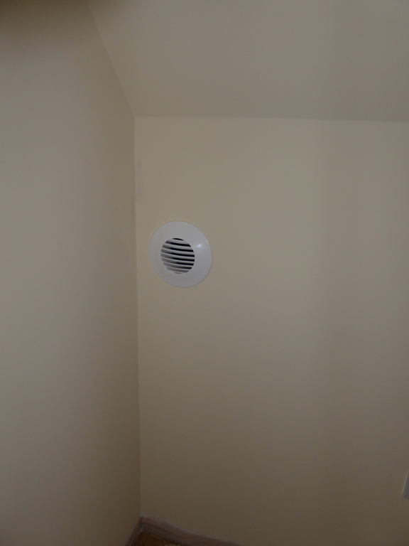

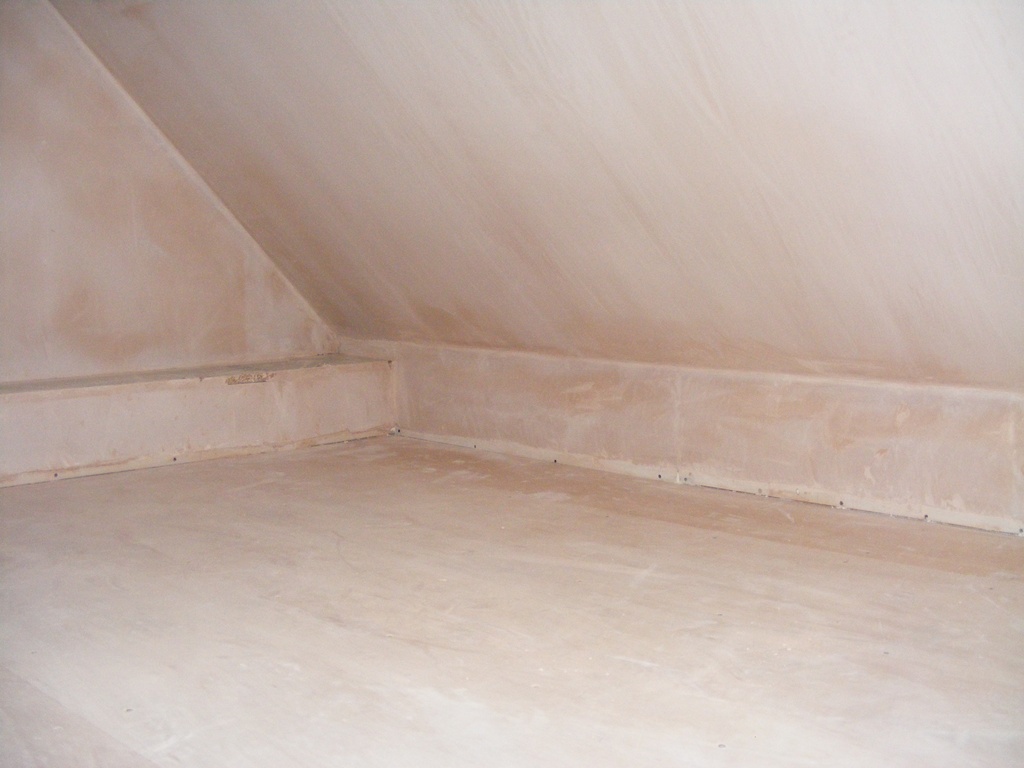

Jeremy Harris Posted November 6, 2017 Share Posted November 6, 2017 (edited) We have vaulted ceilings in the bedrooms and just fitted the fresh air feed terminals in the low walls at either side, with directional vanes to blow air upwards: Others have fitted the terminals in the floor with good results, I believe. The majority of the effect of MVHR is by diffusion, not active air flow, so it doesn't really matter too much where fresh air feed terminals are placed. It does matter where extract ducts are placed, though, these need to be as high as you can get them. In our case, this was relatively easy in the vaulted sections, as there were dividing walls where ducts could run to high level terminals, like this extract terminal in the very top corner of our shower room: Edited November 6, 2017 by JSHarris Link to comment Share on other sites More sharing options...

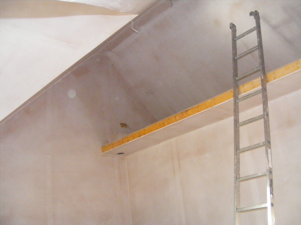

ProDave Posted November 6, 2017 Share Posted November 6, 2017 Our largest bedroom (daughters room) has a full height vaulted ceiling. It also has a mezanine floor above the adjacent small bedroom. The duct for both these 2 bedrooms is in a small boxed in area right at the very bottom of the mezanine ceiling slope. One goes down through the ceiling for the small bedroom under the mezanine and the other comes out of the mezanine overhang for the big bedroom. Link to comment Share on other sites More sharing options...
jack Posted November 6, 2017 Share Posted November 6, 2017 22 minutes ago, JSHarris said: Others have fitted the terminals in the floor with good results, I believe. The majority of the effect of MVHR is by diffusion, not active air flow, so it doesn't really matter too much where fresh air feed terminals are placed. All our bedrooms have floor-mounted outlets and they're fine. This also reduced the amount of ducting we needed, to the point where we got away with one fewer rolls ducting. Link to comment Share on other sites More sharing options...
