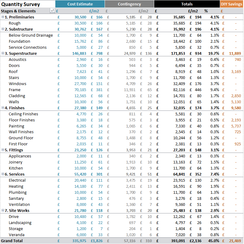

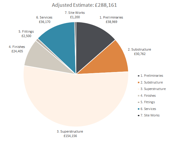

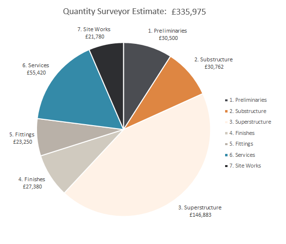

Visti Posted November 2, 2017 Share Posted November 2, 2017 (edited) Whilst we've been maintaining a budget and a rough cost plan since engaging with out Architects, it's only in the last week we completed a detailed breakdown of our build costs via a quantity surveyor. We'd budgeted ~£250k to build this house (£225k with contingency) and yet we were quite stunned (as was our architect) when the surveyor estimated a whopping £400k! We were expecting ~£1500/m2, not an extra You can see a breakdown of this below: I've been over every line item like a mad-man since and have been pulling out all unnecessary elements and identifying area's where we can do the DIY ourselves so that it looks more like this, cutting down the total by about £50k. Focus is on improving the superstructure and cutting down everywhere else. Another £50k is feasible if we're willing to move into a 'technically finished' house with at least several years DIY work to complete which we'd ideally like to avoid! I'd appreciate an experienced eye on where this looks bloated or under-committed! happy to provide the spreadsheet on request For those interested, the plans for the house (184m2) are shown in this post here: Edited November 2, 2017 by Visti Title! Link to comment Share on other sites More sharing options...
Trw144 Posted November 2, 2017 Share Posted November 2, 2017 (edited) £30k on an architect for a start!? Don't see why this could nt be somewhere between £5-£10k. I m sure others on here have come in less than this. Drainage seems high to me - especially as I believe this to be a site with multiple new builds and therefore connection to the mains should nt be too onerous? Ventilation costs seem high ? I paid £5.5k for my mvhr system including installation (330m2 house so probably a bigger unit and more ducting than you will need). Again, a lot of people on here did their own mvhr so probably some more savings could be made here. Although possible, I think your kitchen is likely to come in considerably higher than £2.5k. Painting seems high to me - another you could potentially do yourself. I bought someone in and labour only came in at £2000 (although I don't have painted woodwork/doors/skirting). Overall I think (I ve never sat down and calculated exactly) I ve come in at around £1100 m2 - circa £360k, on what I believe to be a pretty high spec house. I guess there are economies of scale to be had on building bigger though. Hope this helps a bit, I m sure others will chip in shortly - good luck! Edit - I have nt seen the full plans but £30k on windows seems quite high. I paid the same for all of my glazing (there's an awful blog on here somewhere that shows the amount of glass I have), and this included a large 3 x 1.5 flat roof skylight and 3 Hormann doors. Edited November 2, 2017 by Trw144 Link to comment Share on other sites More sharing options...
AliG Posted November 2, 2017 Share Posted November 2, 2017 (edited) Those figures are crazy. I wouldn't cut things out I would go through and see how the figures are calculated. 1. Architect at 9% of cost is very high, is the architect expecting to be paid more due to the higher budget? I negotiated a fixed price based on the budget costs. The cost is much more now but the price is the same, why should I pay the architect more if I decide to spec nicer windows for example. 2. £10000 for underground drainage seems v high, it is 2/3 of the foundation costs. 3. £27,700 for windows. My triple glazed windows cost only twice that in a house more than 5x the size. 4. £70-80000 for the frame, £440 a square metre is nonsense. 5. £20400 for electrical, again I am only about 50% more for a way larger house. On the other hand some of the fittings and finishes numbers may be too low but they are much smaller numbers. Get some quotes, look on the internet, ask him for a refund, he doesn't know what he is talking about. Edited November 2, 2017 by AliG 1 Link to comment Share on other sites More sharing options...

ProDave Posted November 2, 2017 Share Posted November 2, 2017 One of the first items on that list, underground drainage £10K says all I need to know. That is a work of fiction and guesswork. I installed all our drainage including a treatment plant (and I assume you have mains drainage so don't need that) for probably half that. I would not trust those figures. It reminds me of our previous house where we tried to employ an architect but they quoted a fee based on a percentage of the build cost then proceeded to estimate the build cost at a silly high figure (so of course that made their fee higher) We ended up not using an architect and building it for a little over half that cost estimate. A lot of your costs should be fixed? If I understand it from previous discussions, the site sells you a "golden brick" which is your foundations and mains connections. If that is so, forget estimating, you will have that costed. Now your foundations are costed your chosen frame company can give you a pretty good estimate of the costs. One cost I would avoid, is employing a quantity surveyor. Some people have already given some examples. We paid £8500 for our Rationel tripple glazed windows. You probably have more windows than us, but not 3 times as many? The price for electrical is absurd. My labour cost to wire a new house is typically £3k. Materials will cost a bit more perhaps but in any event £10K should see it, so again twice the cost is should be. There is a theme here. Take his quoted figures, divide by 2 and you are somewhere close. Link to comment Share on other sites More sharing options...
Declan52 Posted November 2, 2017 Share Posted November 2, 2017 Your architect is earning way to much for a start, why is his bill so much?? How many Windows are you getting for that price and have you shopped round to get a better price than that?? You could buy a massive amount of paint for £500 and fire away yourself. Get a price from bpc for the mhrv. They do kits for £2k. Why so much for drainage do you have to put a treatment plant in or can you connect to the main sewer. Is the site on bad ground to be such a high amount for foundations. Have you priced round for a different timber frame supplier as that's a major outlay. You seem to be out a fortune just to get the house built and first fixed. Most timber frame companies will price a complete build including all you have as separate items, frame, insulation, plasterboard etc that should come in way cheaper than that. What is ceiling finishes, wet plaster ?? How did you come up with the actual figures, did you get different companies to price up their bits or did the quantity surveyor come up with these. Link to comment Share on other sites More sharing options...
AliG Posted November 2, 2017 Share Posted November 2, 2017 (edited) I just had a look at your introduction page. I see Charlie Luxton architects - Can't imagine that they are cheap. Also an architect can justify high prices if they are overseeing the whole build as mine is. That can be a lot of work, I am sure I have underpaid mine. But here if you are buying in a frame there will be a lot less work for them to do. You mentioned using MBC for the frame, do you not have a quote from them rather than an estimate, someone who has used MBC may be able to comment on how much they would expect to pay. I get the impression that they are expensive but very good. I would expect that you can build something for £1500 a square metre plus architect costs. Edited November 2, 2017 by AliG Link to comment Share on other sites More sharing options...
Jeremy Harris Posted November 2, 2017 Share Posted November 2, 2017 As a guide, our build was smaller, 130m2 so roughly 2/3rds the size. This doesn't equate to 2/3rds the price, because of the fixed mobilisation costs for some of the heavy stuff. We have a 300mm thick wall, 400mm thick roof, cellulose filled frame, on a passive slab foundation from MBC - they do the whole package, passive foundation and insulated frame as a package. The windows are all passive house standard, triple glazed. Our ground works were very expensive, as we had a big retaining wall and over 1000 tonnes of excavation, and this alone cost around £55k, but £30k of that was the retaining wall, and the rest of the costs included all the drainage, including the treatment plant and all the ducting for services, as well as shifting all the soil. So leaving out the ground works, I can give some costs. Frame and passive slab foundation system cost just over £60k. Windows and external doors cost £8.5k. I did the plumbing and heating, but the electrician and all the electrical stuff came to under £7k, albeit with some labour from me. We didn't use an architect or architectural technician, so saved that cost. Roofing and fascias/guttering came to around £9k, IIRC, but over 2/3rds of the roof was solar panels, and they cost around £8.5k, I think. Link to comment Share on other sites More sharing options...
AliG Posted November 2, 2017 Share Posted November 2, 2017 There are a couple of things that aren't clear. At 184 sq metres and 1500 a sq metre I would have thought your budget would be around £275,000, not £225,000. I hadn't realised how expensive an MBC frame can be, that seems to be the cost for a passive frame, but the estimate has £14,000 for heating. In fairness you might need to budget a bit more for a passive house. If there are no surprises below ground and you budget correctly you shouldn't need such a large contingency. If you have a firm price for the frame, that's the price, why would you add a contingency to that. I suspect you are already committed to that architect, if so including that cost you might be talking £300,000 unless you do more work yourself, but certainly not £400,000 including a massive contingency. That is basically what your adjusted number is coming to. Link to comment Share on other sites More sharing options...
Ferdinand Posted November 3, 2017 Share Posted November 3, 2017 (edited) General Points. I think the single biggest saving you can make is by not using your contingency, which on your revised costs would put you at £288k if you achieved it - within spitting distance. That needs you to sweat the detail first as far as possible and not fall prey to gold-plating later. You seem to be doing this - good. Even if, as has been suggested, the theoretical costs are "over", and you can afford it all in nearly-your-budget, I think the experience will have been a useful one. In Charlie's T&C, the basic architectural services are fixed cost, so that is in your favour. On the hard-nosed side, if it hits the 2 years, and - eg - you have not built your veranda, there will probably not be a lot they can practically do to enforce. Will they chuck you out? Repossess and sell on? Come after you for money you have not got, which taking away would prevent what they want happening ? It is almost going back to how they self-built or renovated houses way back when ... build the minimum then gradually upgrade as funds allow while living with cast-off furniture, a kitchenette and rush-matting. My parents did that on a renovation that took a couple of decades. Ferdinand Edited November 3, 2017 by Ferdinand Link to comment Share on other sites More sharing options...

Jeremy Harris Posted November 3, 2017 Share Posted November 3, 2017 There are a few really odd costs in there, too, that need looking at. For example "acoustics" at nearly £3k, What on earth is that? For our build, with a very acoustically "dead" external wall structure (cellulose filled timber frame) the only additional acoustic insulation was 100mm stuffed into all the internal stud walls at a cost of around £250 for all the internal walls in the house, and 200mm in the ceiling (double the thickness actually needed, and which turned out to be a bit of a pain to fit) which cost around £500. Labour for fitting all this was less than 1 man day, so an absolute maximum of another £180, making a total cost of £930, and we went OTT by doubling up on the ceiling acoustic insulation. I doubt that you will spend more than £1500 absolute maximum on acoustic insulation, and could probably knock a few hundred off this if you shop around or did it yourself (it's dead easy to fit, anyone can do it). There's also some double accounting going on, I suspect. If going for an MBC frame, remember that this includes the foundation, the underfloor heating pipes, all the thermal insulation and the airtightness test, to PH levels. All the roof battens will be fitted normally, too, as will the internal service void battens, something that may well be being costed twice, in the roofing and internal lining costs, for example. Link to comment Share on other sites More sharing options...
