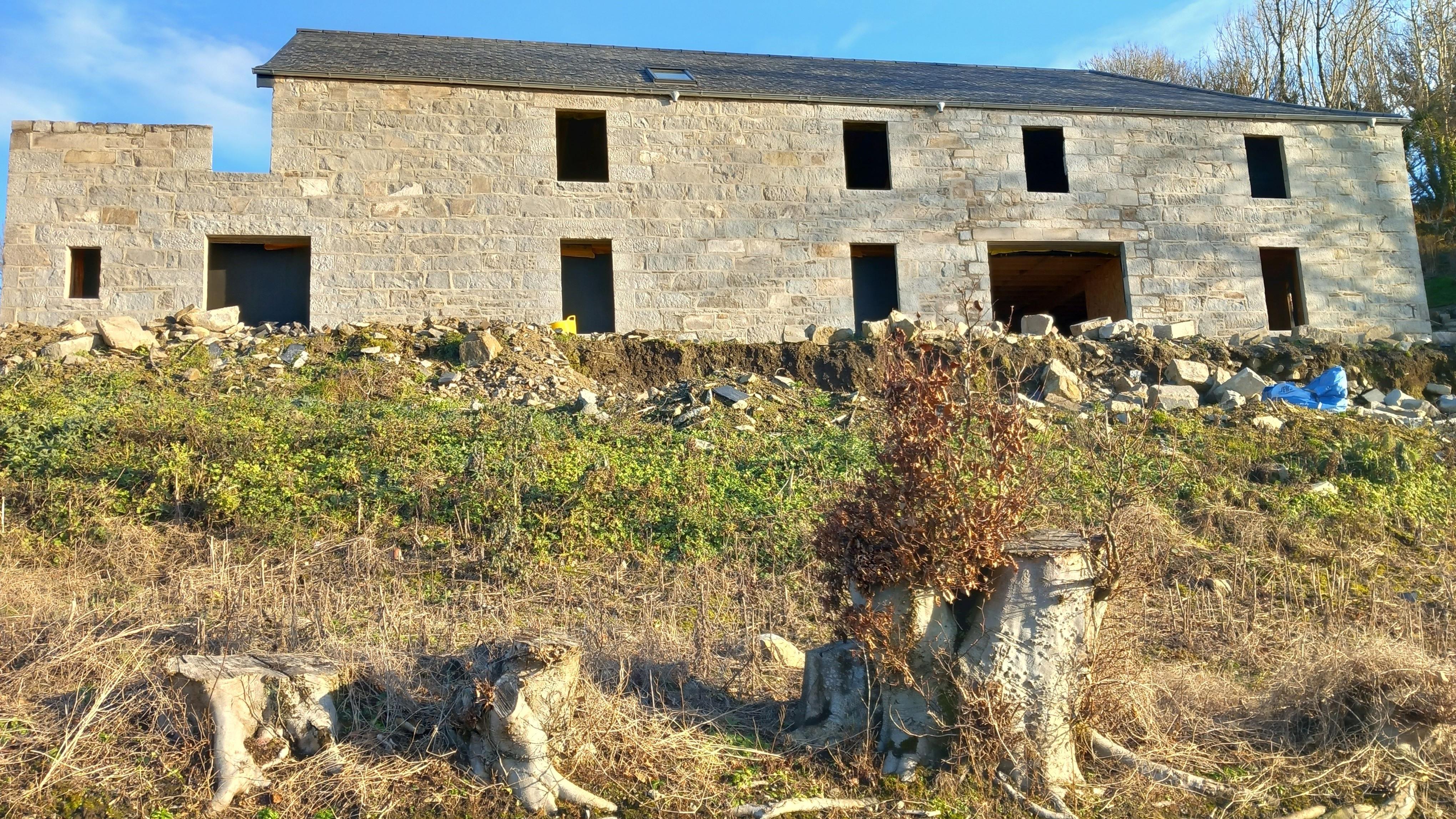

scottishjohn Posted January 1 Share Posted January 1 On 31/12/2023 at 01:22, Iceverge said: Maybe you can see why I think most old houses reach a point they need to be rebuilt. the right solution for them is a total gutting build a modern house inside the shell as I am doing with my granite house 700mm granite --then 150mm t/f inside on new concrete floors and underfloor it would it have been cheaper to flatten all --maybe? but would it have the look --no and if your going to stone clad it --then why not use the walls already there ? Link to comment Share on other sites More sharing options...
Iceverge Posted January 1 Share Posted January 1 25 minutes ago, scottishjohn said: the right solution for them is a total gutting build a modern house inside the shell as I am doing with my granite house 700mm granite --then 150mm t/f inside on new concrete floors and underfloor it would it have been cheaper to flatten all --maybe? but would it have the look --no and if your going to stone clad it --then why not use the walls already there ? Assuming you can get people to do the work and pay them then it's fine. However it's still a bespoke building. Every part of the TF cut to length on site, bricks laid one by one. Craftsman galore. Here's how we built factories in 1900. Here's how we do it today Here's houses in 1900 Here houses today. See my issue? 1 Link to comment Share on other sites More sharing options...
SteamyTea Posted January 1 Share Posted January 1 (edited) 57 minutes ago, scottishjohn said: the right solution for them is a total gutting build a modern house inside the shell Can loose a lot of space though. My house is 3.7m wide, 7.5m long. Adding 0.15m to each wall of insulation would reduce the floor area from 27.75m2 to 24.48m2, 12% smaller. And there was (expletive deleted) all to start with. Then, where the stairs are, the width would go from 2.8m down to 2.5m. External wall insulation is the only viable option, but as I am in a World Heritage area, not allowed to do it. As the aim is to reduce carbon emission, changing our energy production is the only option. My loss of ~3m3, if replaced with 150 Wp of PV, would generate about 0.15 MWh of energy each year as an off set. That is about a sixth of my annual energy usage. The PV does not have to be on my property, it can be tacked onto another system somewhere. Thinking about it, for every linear metre of 0.15m thick insulation, that is 45Wp, or 45 kWh/year of generation potential. Going to be cheaper to electrify and install PV. So how much PV would you get instead of insulating houses. Take a small house 6m by 8m, that has a foot print of 48m2, the linear metres is 28m. That would give us, at 0.15m insulation thickness area of 4.2m2. Or about 800 Wp, which would generate close to 0.8 MWh/ year. Edited January 1 by SteamyTea 2 Link to comment Share on other sites More sharing options...

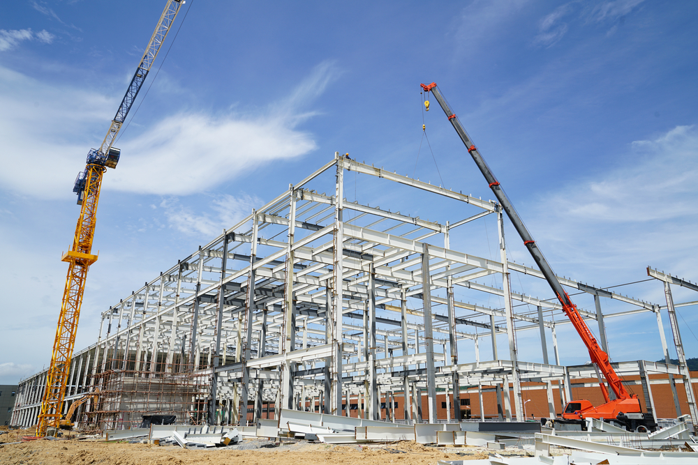

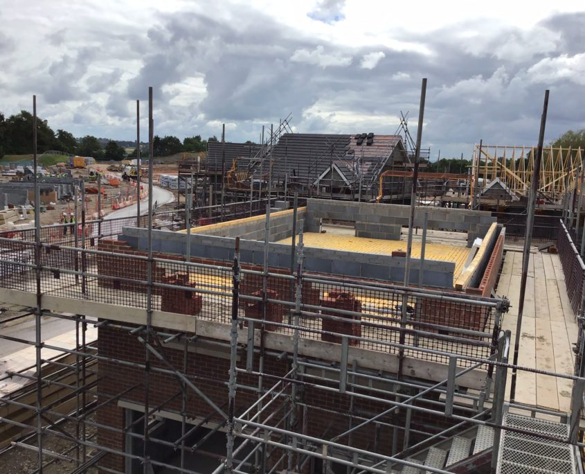

Canski Posted January 1 Share Posted January 1 4 hours ago, Iceverge said: Assuming you can get people to do the work and pay them then it's fine. However it's still a bespoke building. Every part of the TF cut to length on site, bricks laid one by one. Craftsman galore. Here's how we built factories in 1900. Here's how we do it today Here's houses in 1900 Here houses today. See my issue? Banana tree wall plate Link to comment Share on other sites More sharing options...
scottishjohn Posted January 1 Share Posted January 1 (edited) 5 hours ago, Iceverge said: Assuming you can get people to do the work and pay them then it's fine. Idid an old house ab it at a timeby simply building stud walls inside original-did nottouch old stuff --and you would probaly get away with 100mm that way ,as there would be osme insulation inwhat is there now but if you have damp problems then you need go back to brick anaway and sort it --guessing it has no damp course --so maybe dig a channel around outside to stop soil touching wall at floor level if walls are fine then even 75mm foainsulation backed plaster board would make a big difference -dot +dab fixing if walls good ? as for craftsmen -- if not destroying whole house at one go then you can learn as you go --remember its only the outside walls that need to super insulated+ceiling where it joins loft --your making a air tight box inside your drafty old one as for comparison of old build methods to new -- still along way to go even on new types and as for a Tf kit to fit old house --that will never owrk -has to be built onsite or it won,t fit for sure and doing it that way no big cranes needed to lift big panels only big lifting on my job was a telhandler to lift up roof trusses -damn sight cheaper than a crane at mega money per day Edited January 1 by scottishjohn Link to comment Share on other sites More sharing options...
Kelvin Posted January 1 Share Posted January 1 You don’t a crane to lift pre-made TF panels. It can be done with a telehandler. Link to comment Share on other sites More sharing options...

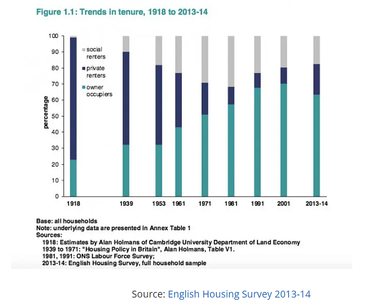

Crofter Posted January 1 Share Posted January 1 3 hours ago, SteamyTea said: Quite progressive. But then Scotland had a big problem with landowners, usually English ones. This is post Victorian. That's a fascinating graph. I wonder if BTL landlords threw a hissy fit when they saw all the council houses being built after the war. Link to comment Share on other sites More sharing options...
SteamyTea Posted January 1 Share Posted January 1 (edited) 30 minutes ago, Crofter said: wonder if BTL landlords threw a hissy fit when they saw all the council houses being built after the war Probably at first, but then realised that renting small rooms to the Windrush generation was more profitable. Beacontree estate at Dagenham was a development of 26,000 homes. Dudley Moire lived there. Edited January 1 by SteamyTea Link to comment Share on other sites More sharing options...
