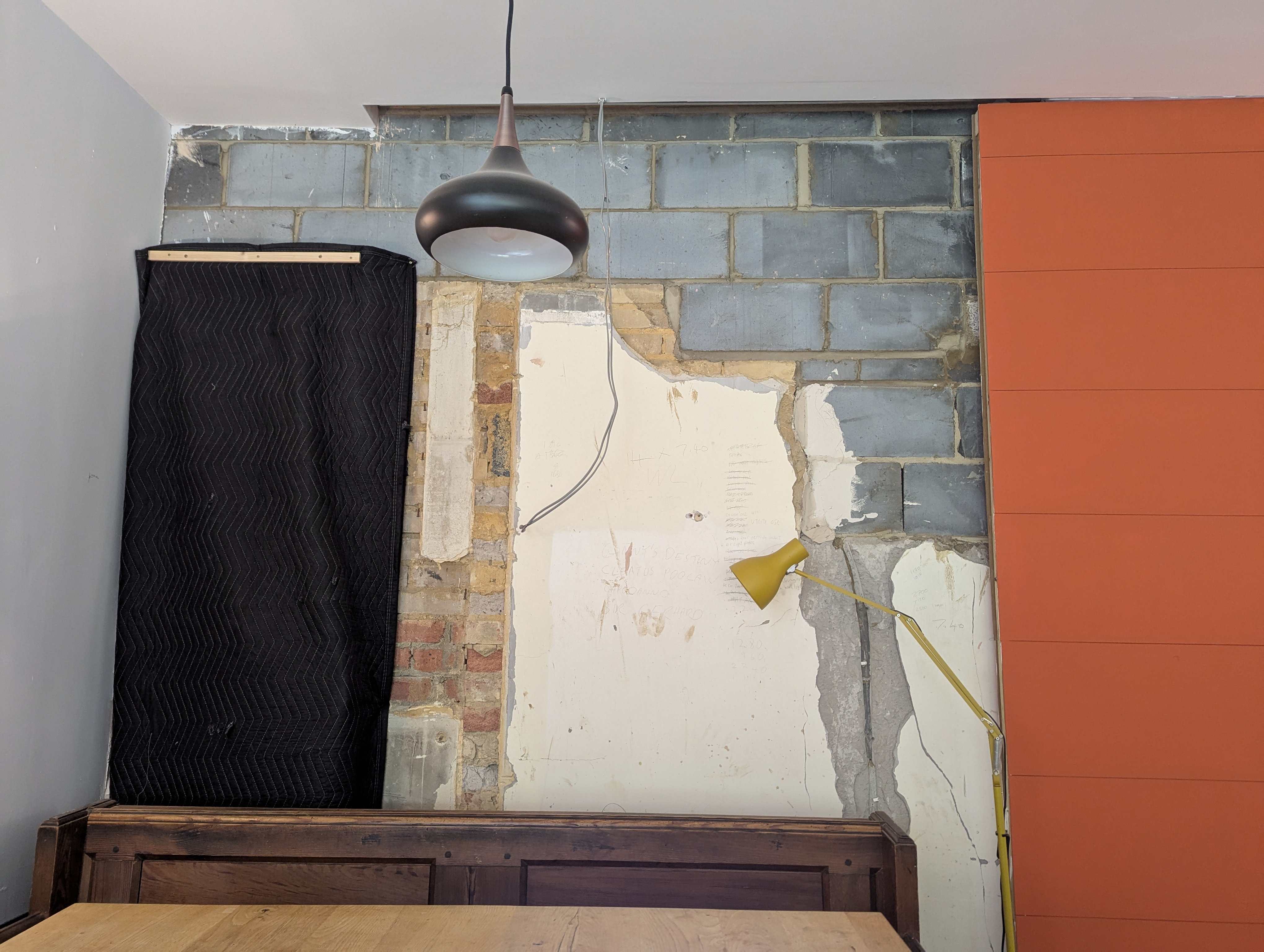

October 7, 20251 yr Author On 02/10/2025 at 11:11, allthatpebbledash said: What did you end up doing then? I find myself in a very similar position. We kept a few of the original walls rather than doing a complete knock down and rebuild. The advice (and to some extent sowing of FUD) was enough for us to make the risk based decision that we would not fully demolish. We would not have been able to afford any time delays for resubmitting planning as we were paying for a rental house whilst doing the works. In hindsight, I am pretty sure that we would have gotten away with it, but we are happy enough with our decision. We were already doing it in quite a risky way with finances and mortgage. There is very little of the original house remaining as part of the completed structure, and almost all of it is hidden behind newly plastered walls (except a small portion behind a rarely used large sliding wall panel, complete with various pencil notes from the builders with to-do lists, shopping and horse racing tips. We are actually keeping this as a reminder of the works) As the house had been vacant for 2+years, the majority of the materials and labour were changed at 5% VAT at the point of purchase (VAT note 708), whereas if we had knocked down and been caught needing to to a full new build application the VAT would be paid at 20% then reclaimed at the end, so would have severely impacted cashflow for only a relatively small saving.
