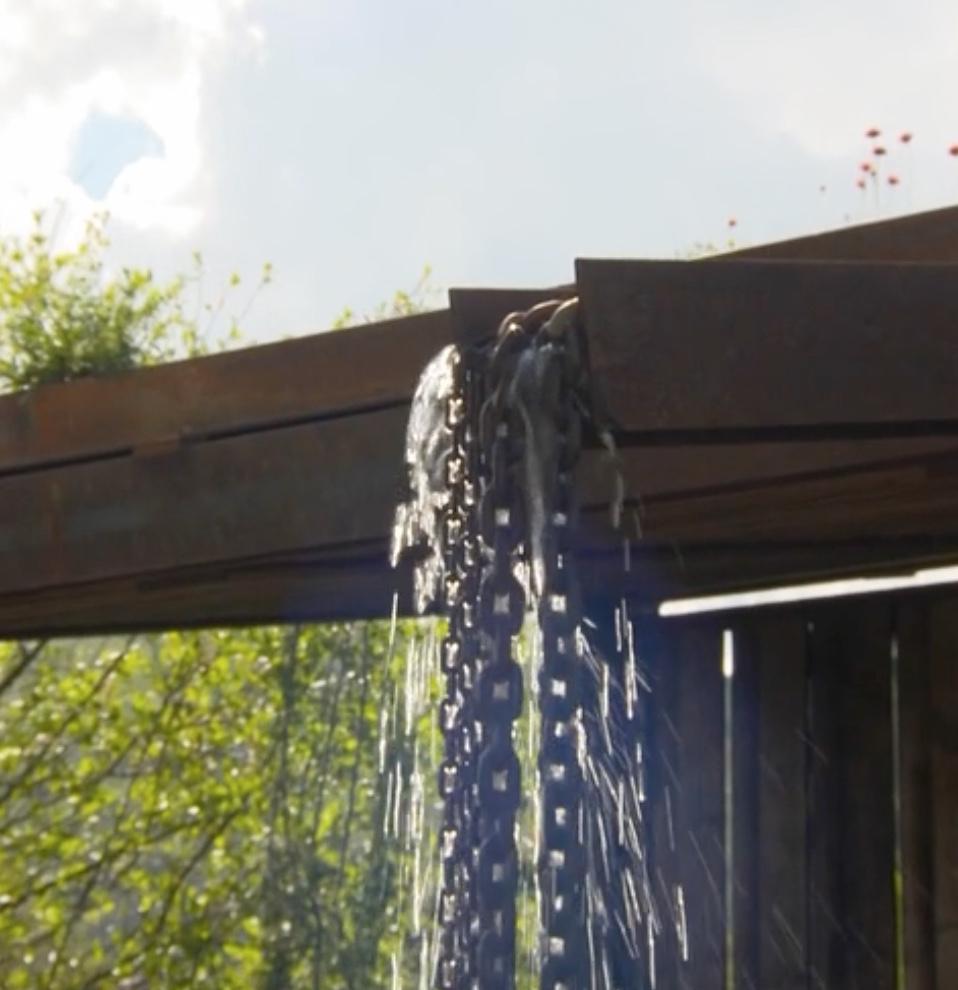

Adsibob Posted May 16, 2023 Share Posted May 16, 2023 (edited) We have planned to use chains as a decorative way of transmitting rainwater down from the gutter to the ground (about 2.3m). However, saw this somewhere else, and it failed horribly. Have a look at the video: ec24ac23-1c5c-4276-bd58-f4cf9b0b8650.mp4 Mentioned this to the designer, who said several chains will work better than one, and the trick is to fill the hole with the chains as much as possible. Our hole has a diameter of 52mm, so wondering which chain size to get and how many lengths of chain to try and implement. Anyone have experience of this? Edited May 16, 2023 by Adsibob Link to comment Share on other sites More sharing options...

saveasteading Posted May 16, 2023 Share Posted May 16, 2023 It is a gimmick. Style over function. They splash all over the place. They also obstruct the wier effect at the outlet so need a bigger gutter and dp. OK on PD balcony where it is a nicety and can cause no damage. Link to comment Share on other sites More sharing options...

saveasteading Posted May 16, 2023 Share Posted May 16, 2023 It does work as long as sometimes splashing isn't going to be a problem. It avoids a big dogleg in the rwp if there is an oversailing roof. But it realy does need bigger gutters and/ or redundancy and/ or big overflow wiers out of harms way. Another place to see it is at the executive bypass of the Black Country, Hilton Park Services. Link to comment Share on other sites More sharing options...

Kelvin Posted May 16, 2023 Share Posted May 16, 2023 My wife’s uncle has this on his Huf Haus. Seems to work fine. Bit of splashing in very heavy rain. Link to comment Share on other sites More sharing options...

RichardL Posted May 17, 2023 Share Posted May 17, 2023 Most recent one I saw on Gardeners world/Malvern show + IRL visiting - it wasn't working well - just looked messy? Skip to 20:43 https://www.bbc.co.uk/iplayer/episode/m001ltth/gardeners-world-2023-episode-9 Looks like too much flow over the top or might need the chain to come out of a hole on the bottom of the gutter rather than over the edge? Link to comment Share on other sites More sharing options...

Adsibob Posted May 17, 2023 Author Share Posted May 17, 2023 1 hour ago, RichardL said: might need the chain to come out of a hole on the bottom Yes, that is how they are meant to work. Link to comment Share on other sites More sharing options...
Gone West Posted May 17, 2023 Share Posted May 17, 2023 15 hours ago, Adsibob said: Anyone have experience of this? A friend of ours used chains for roof drainage on their new build. I wasn't a success when it was windy as the water went everywhere. It only worked well in light rain and no wind. Link to comment Share on other sites More sharing options...
