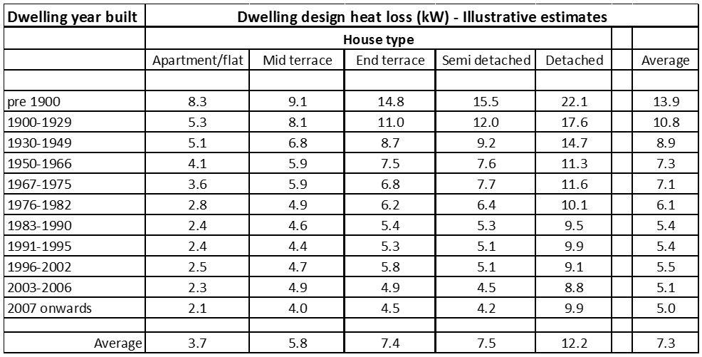

Temp Posted April 22, 2023 Posted April 22, 2023 (edited) Found this although I'm not sure the way they calculate averages is correct. Should be weighted by the number of houses in each age band? It's also worrying that for detached houses it seems to have gone up after 2006? https://tools.bregroup.com/heatpumpefficiency/dwelling-heat-loss Edited April 22, 2023 by Temp
