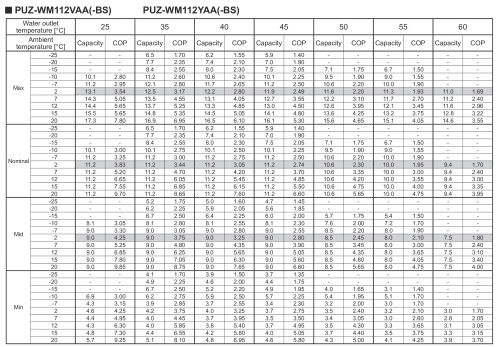

You're looking at sCOP 2.8ish at 55C or sCOP 2.3ish at 65C all year.
This falls below the sCOP at which the government considers there to be any carbon savings and more importantly perhaps below the sCOP at which you don't cause higher operating costs.
I did the calculations based on LGs specs and the temperature profile in the South of England.  I am not making any claims for colder climes as I haven't done the maths (but I have posted the model so somebody else can).
Someone upthread reports an achieved SCOP of 3 at 55 (versus 3.2 predicted), in a location further north with an earlier model LG HP, suggesting LGs specs aren't that far off.   3 is good enough with the current relationship between gas prices and electricity prices, which is artificially tilted in favour of gas (a tilt which is likely to change).

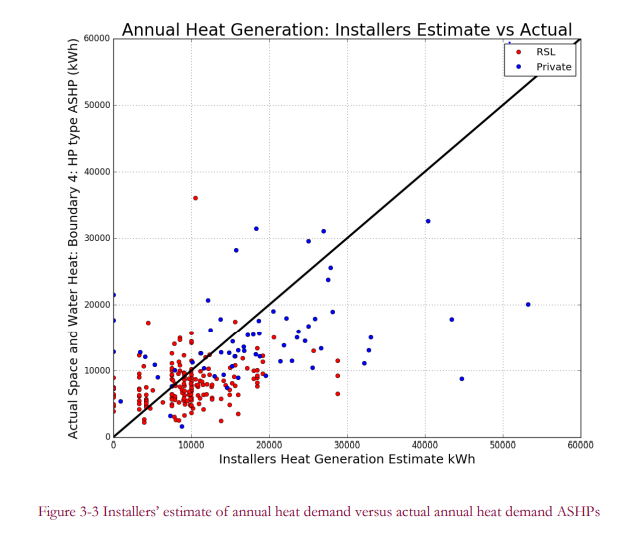

The specs on most units are perfectly fine.
It's the installed flow temp in operation vs the theoretical weather compensated flow temp that crushes the real world sCOP.
Peak at much over 55C and the run costs become materially worse. Conversely drop to peaking at 45C and there's not much in it dropping to peaking at 35C.
