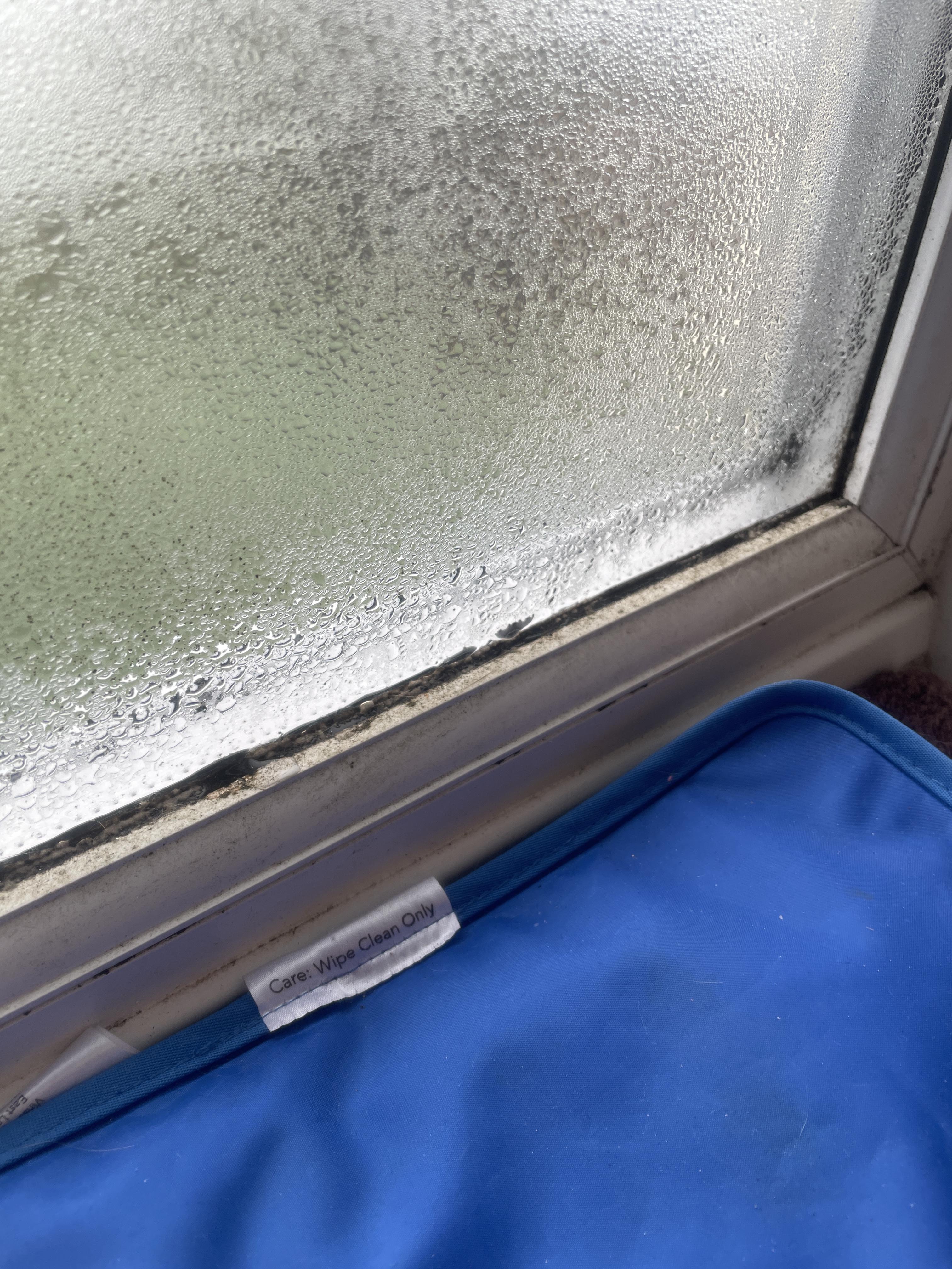

HughF Posted January 22, 2023 Posted January 22, 2023 Background; 1946 end of terrace, block, filled cavity (2”) 300mm loft insulation, double glazing… two persons, 5 cats, gas central heating, flow temp is around 55. I don’t know what the indoor air quality is like but it’s probably poor (I don’t live here at present, just visit occasionally). Anyway, would I need a full Mvhr retrofit deal with the causes of this, or could I get away with just a couple of dMVHR through the wall upstairs. Leaving a window cracked open isn’t an option. *yes, I spent an hour yesterday washing and de-moulding all the windows, and then had a rant at my wife for letting it get this bad - it’s her place.
jayc89 Posted January 22, 2023 Posted January 22, 2023 Anecdotally I've heard PIV works wonders for this type of problem. It's certainly a quicker and easier fix than MVHR.
Conor Posted January 22, 2023 Posted January 22, 2023 Are there trickle vents in 5h3 windows? I'm assuming not. We lived in an apartment like this, got the landlord to replace the three knackered extractor fans, and I left a couple of windows open on the second position and issues went away.
HughF Posted January 22, 2023 Author Posted January 22, 2023 No trickle vents (2012 windows), exposed location. The house is warm but stuffy. Getting the windows left open isn’t going to happen. I would need a fit and forget heat recovery solution really. No extractor fans anywhere… It really needs a deep renovation but I don’t have anywhere to house the occupants whilst doing the work. Original heating and wiring from ‘86, one double socket in each room. We’re going out the back this year which will give us a bit of space to put the occupants in and do one room at a time.

JohnMo Posted January 22, 2023 Posted January 22, 2023 54 minutes ago, HughF said: No trickle vents 54 minutes ago, HughF said: No extractor fans Think you have answered your own cause. Best two fixes are PIV or MEV. PIV, one central unit in loft or elsewhere, one supply outlet. MEV, centralised extract unit taking air from all wet rooms, can get them so they only when required and close down or open extract points as needed. PIV is either on or off, MEV, ventilation only as required, if specified correctly. You can retrofit trickle vents, or vents in the walls of dry rooms, but get them so they auto open and close based on humidity. MVHR without airtightness is a waste of money.

HughF Posted January 22, 2023 Author Posted January 22, 2023 There’s no way I’m fitting ventilation that doesn’t have heat recovery, blowing cold air in, or sucking out hot air and creating drafts is a total no-no and won’t get past my wife. If it wasn’t moderately airtight then it wouldn’t suffer from condensation, mould and stuffiness, surely? and as for the dehumidifier, I’ve already got two that we use for drying out clothes, but they’re hateful, noisy things that suck 500w (desiccant type)
