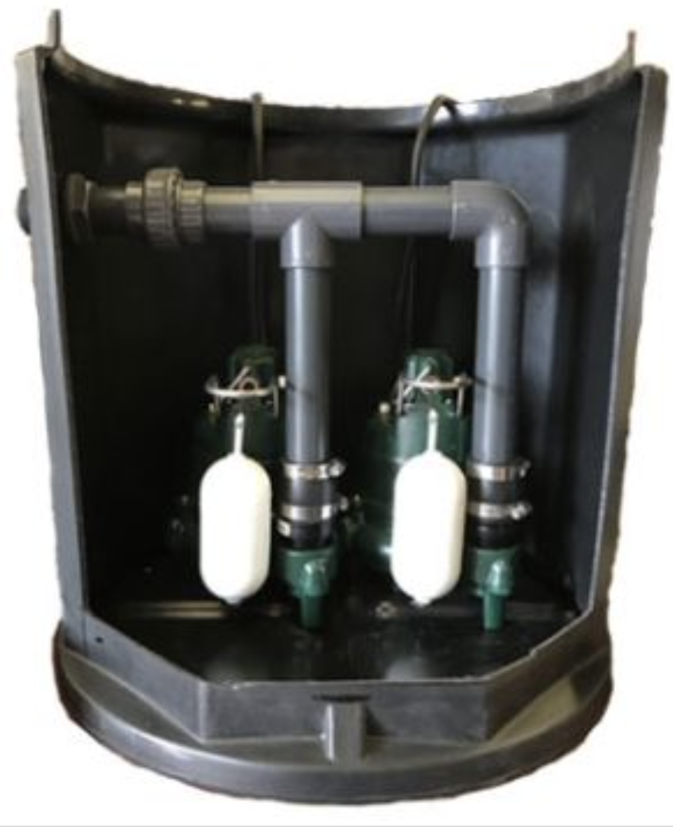

Thorfun Posted November 18, 2022 Author Share Posted November 18, 2022 I was literally going to copy something like this but with a 3rd pump a little higher up in case of double lower pump failure. but I have found a local-ish basement sump pump company and I'll ask for a quote. the most annoying thing about that sort of company is they offer a 'service agreement' and the cheapest on their website is £30/month!! so if it's like an alarm company where they insist on you taking a service agreement out then that's a lot of money a year. Link to comment Share on other sites More sharing options...
Pocster Posted November 18, 2022 Share Posted November 18, 2022 4 minutes ago, Thorfun said: I was literally going to copy something like this but with a 3rd pump a little higher up in case of double lower pump failure. but I have found a local-ish basement sump pump company and I'll ask for a quote. the most annoying thing about that sort of company is they offer a 'service agreement' and the cheapest on their website is £30/month!! so if it's like an alarm company where they insist on you taking a service agreement out then that's a lot of money a year. I have something similar for my sewage pump . It can’t overflow of course unless both pumps fail and high water alert fails . Rainwater is of course the real issue - here I just have my 2 pumps at different heights in a hole in my concrete slab . A ‘ service agreement ‘ is BS 😁 Link to comment Share on other sites More sharing options...

Thorfun Posted November 18, 2022 Author Share Posted November 18, 2022 4 minutes ago, pocster said: I have something similar for my sewage pump . It can’t overflow of course unless both pumps fail and high water alert fails . Rainwater is of course the real issue - here I just have my 2 pumps at different heights in a hole in my concrete slab . A ‘ service agreement ‘ is BS 😁 yeah. we have a 2m deep hole (approx 600mm x 600mm wide) in our basement courtyard. all the groundwater from around the basement flows in to their from 2 x land drains outlets. we then have an outlet from the sump to our RWH tank. the sump was created from shuttering and poured in water proof concrete at the same time as the basement so I wasn't going to bother with a plastic tank as I have a waterproof hole already! I just need to get a couple of pumps hooked up to the outlet. I do like @saveasteading's idea of different float heights and will look in to it some more. 1 Link to comment Share on other sites More sharing options...
Pocster Posted November 18, 2022 Share Posted November 18, 2022 6 minutes ago, Thorfun said: yeah. we have a 2m deep hole (approx 600mm x 600mm wide) in our basement courtyard. all the groundwater from around the basement flows in to their from 2 x land drains outlets. we then have an outlet from the sump to our RWH tank. the sump was created from shuttering and poured in water proof concrete at the same time as the basement so I wasn't going to bother with a plastic tank as I have a waterproof hole already! I just need to get a couple of pumps hooked up to the outlet. I do like @saveasteading's idea of different float heights and will look in to it some more. Excuse me ! ” To add My rainwater Zoellar pumps are at 2 different heights in a pit I.e lower than my basement floor . “ nuff said bro 😎 Link to comment Share on other sites More sharing options...

Roger440 Posted November 18, 2022 Share Posted November 18, 2022 In my case, pretty much what pocster has done. Bought a twin pump (zoeller)version of this: https://www.sumpsandpumpsdirect.co.uk/acatalog/Zoeller-Grey-Water-Pumping-Station.html#SID=48 The pumps are at different levels. Mine was done to counter a flood event from the river, so they will rarely if ever be used. In case of power failure, the same company supplied piggy back battery pump (12v) with capacity to run for 4 hours. Which in my case, is plenty. More batteries wouls increase that time. For it not to work, both mains pumps and battery sysatem would need to fail. 2 Link to comment Share on other sites More sharing options...
Thorfun Posted November 18, 2022 Author Share Posted November 18, 2022 31 minutes ago, Kelvin said: Sheesh what a nightmare. Electronic components recover well from getting wet as long as they aren’t powered up when wet obviously. I ran a maintenance company for several years and we regularly bathed components to clean them using distilled water and soft brushes. This was back in the days of smoking in offices so for anything really manky we’d use isopropyl alcohol as well. Take all the covers off and use an air duster to remove any loose dirt. Submerge in a bath of distilled water and use a soft brush to clean. Drain the water off and then leave to dry. Anything that had a screen might well be buggered though unless you can source replacement screen parts. We also used baking soda to clean components. We had a special low temp oven type thing to aid drying. it just seems alien to submerge electronic components in water! finding it hard to get my head around the concept. Link to comment Share on other sites More sharing options...
Thorfun Posted November 18, 2022 Author Share Posted November 18, 2022 16 minutes ago, Roger440 said: In my case, pretty much what pocster has done. Bought a twin pump (zoeller)version of this: https://www.sumpsandpumpsdirect.co.uk/acatalog/Zoeller-Grey-Water-Pumping-Station.html#SID=48 The pumps are at different levels. Mine was done to counter a flood event from the river, so they will rarely if ever be used. In case of power failure, the same company supplied piggy back battery pump (12v) with capacity to run for 4 hours. Which in my case, is plenty. More batteries wouls increase that time. For it not to work, both mains pumps and battery sysatem would need to fail. I could literally put a concrete block at the bottom of the sump to put one of the pumps on! that'd give me the different levels. much to think about. 1 Link to comment Share on other sites More sharing options...
