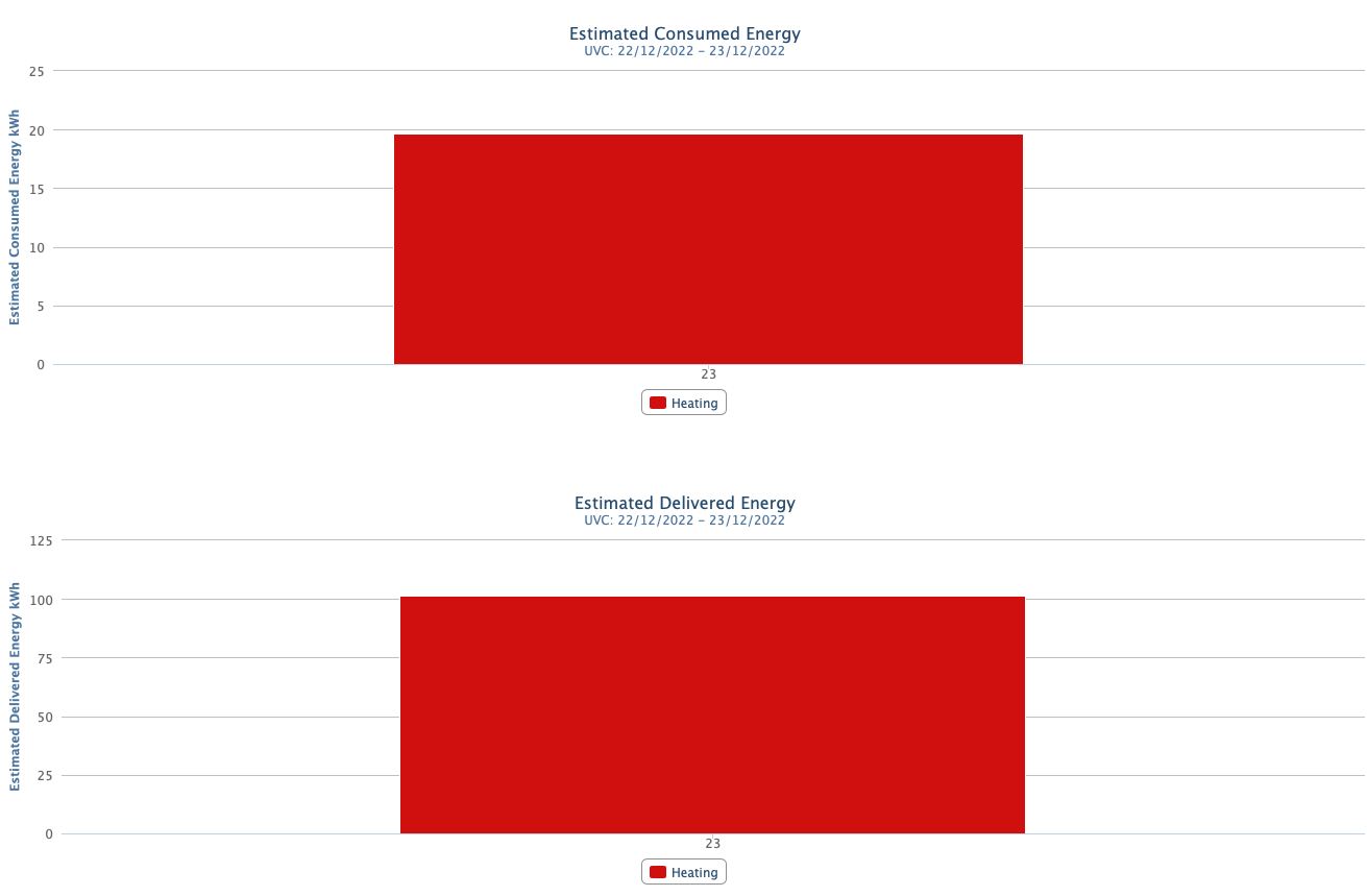

Watch your electric bill. I've been astonished at how much my ASHP is using. Also, I was advised against using heat to dry the screed; not because it would cause any problems but mainly because I was told good ventilation and a commercial dehumidifier would be much more cost effective.
Link to comment
Share on other sites
£7 in the first 24hrs according to the Melcloud app and it's running 24/7. 20kWh input and approx 100kWh output. so first day was a COP of 5 which I'm very happy with.
1379795188_Screenshot2022-12-24at18_25_41.thumb.png.95b7333b66c959f3fa4bdfc36b3befca.png
and last time I went to check the basement was up to 15.6°C so it's getting to the point where a commercial dehumidifier would start to make sense. but, for now, we have a couple of smaller dehumidifiers that are doing a job.
  • Like 2
