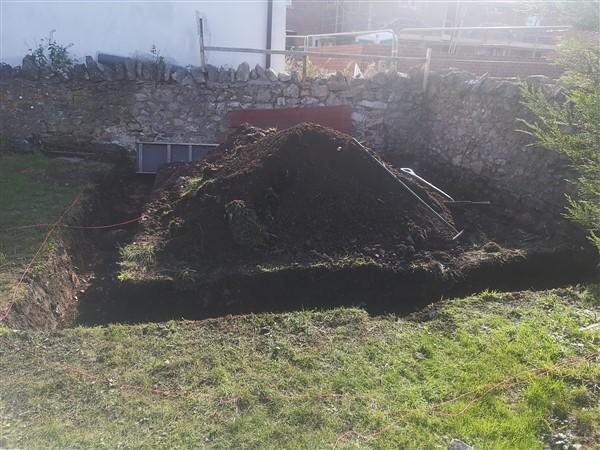

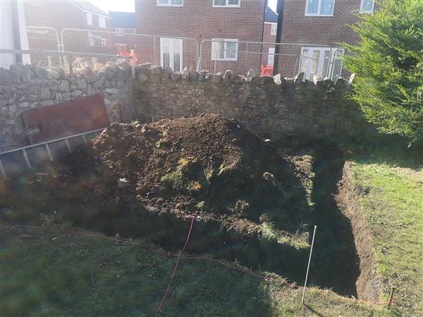

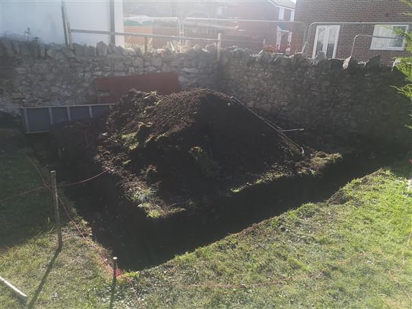

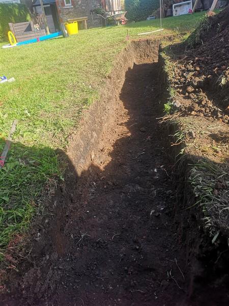

Well, I've made a start! Decided to dig the footings by hand - my back regretted it immediately but it's done now and I've saved £300 on digger hire :)
I've just borrowed my friends posh laser level so I can mark the levels for the concrete, and maybe some good news - One of the builders on the Taylor Wimpey site rekons he can arrange for them to pump the concrete over the back wall for me! That would be a big help.
IMG_20221008_143402.jpg.307d657ab210be2171b74b04b72f41c5.jpgIMG_20221008_143347.jpg.b2c47edde84ac78ca8477b4f8b4fb3b7.jpgIMG_20221008_143258.jpg.222d499ead93b2e64564025816958226.jpgIMG_20221008_143251.jpg.6fb2a446bda4738b1e14a15b13545a19.jpg
Wow!  That's a lot of digging, good effort!  Did it need to be that wide?  That's a lot of concrete reqd.
After reading through this forum and others, seemed like 500mm width would be about right?
I want it to last! :)

I've just set out my levels for the foundations with a laser level. At the highest point in the foundation I have actually hit solid rock, but this means the concrete in that location will only be around 13cm thick when poured.  Is this acceptable considering it is on top of very firm ground?
The opposite side of the foundations will be almost 30cm of concrete.
I know the concrete will almost find its own level, but I have knocked wooden stakes in to the ground and marked the level the concrete needs to be at, and have also tied builders string between the stakes as a visual guide for the concrete level... Any other tips before the concrete comes?!
130 concrete on rock is fine.
300 is very thick. What is the reason for that?
Concrete does not find its own level. Or shouldn't if you haven't added water.
Your peg method is very sensible, because the driver can judge while pouring and then you just have to shovel and forget the lasering.
If checking the poured concrete with the laser, be sure not to let the staff depress the surface and give a false reading. This is a common mistake and the blocks need to be cut.
Do not add water to the concrete. It is a precise mix and axrea water makes it very much weaker, for the sake of a bit more work.
When finished, the driver asks where you want the surplus and slops. Decide in advance.  Then he washes out the drum and again you need a place or barrow to hand.
How accurately are you calculating the order? Again your pegs help a lot in measuring the depth.
Approx 16m x 0.5 x 0.2, = 1.6m3.
If delivered in a big mixer you will pay for 5.4m3 not carried.
If you can get volumetric (mixed on site) it should be cheaper, and no waste.

 I will hopefully be getting the concrete from the Taylor Wimpey site behind my house, they will pour it over the wall, so I can take just what I need, as they will be using the rest else where on site. That will also solve a number of problems.
Why the one trench is 30cm is because I dug down until I got to solid ground, there was a lot of loose mud and so that trench is deeper. It won't matter that some areas are deeper will it? I do have quite a bit of rubble lying about, so I could have some at the ready to throw in with the concrete perhaps?
As I say, I've knocked in 3 stakes with a pencil line marking the level, and tied pink builders string between each stake so as the concrete goes in I can shovel it around until i can get it somewhere near the string levels.
I Hope this works out! Its the first time I will have done this!! 😟
Good luck, ask a few mates for help easier with a few bodies..
hire a vibrating poker, gets the air out the concrete, turns it from an aero bar consistently to a solid chocolate foundation of goodness
